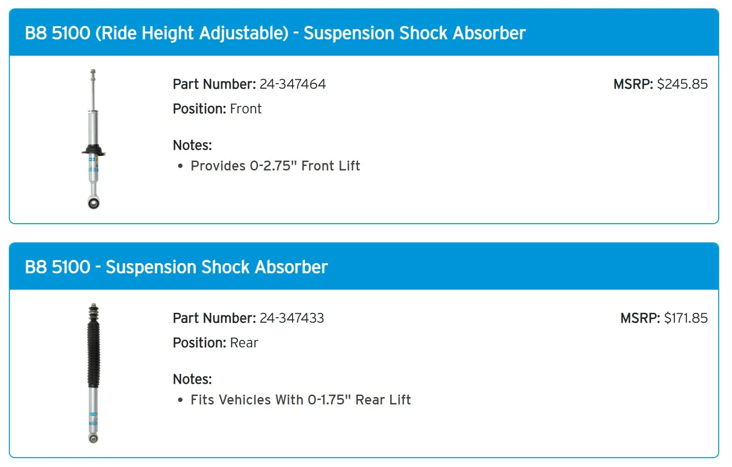

Hi guys,
Has anyone upgraded their suspension on the 6th gen using Bilstein 5100s and used the adjustable perch to level the vehicle? I’m planning on doing a 2-inch front lift with the 5100s and keeping the rear stock height but still replacing it with Bilstein (like what’s shown on the Bilstein website / Performance level2 for reference). How was your ride experience on and off road?

I added 275/60r20 tires to my stock 4R and by my measurement the front is 1.25” higher than the rear. I would suspect by lifting the front by 2.5”, it will give the truck a squat look. The good thing is you could add the Bilsteins and just tell the shop to adjust the front to be level with the rear.

I had this setup bilstein 5100s all round on my 5th gen , front set to 1.75 and I added a 1 inch cornfeed spacer to the rear. Never had any issues and road fine. BUT I don’t ever hardly take it off on a trail. Probably do the same setup on my 6th trd sport soon.

I think 2 inches in the front might be slightly high based on the lift I just did- not 5100’s though. I had 5100’s on my 4th gen and they were totally fine, obviously there are better and worse options. I can’t remember which snap ring settings the 5100’s have, but I think something around 1.75” would be better with a stock height rear and.
