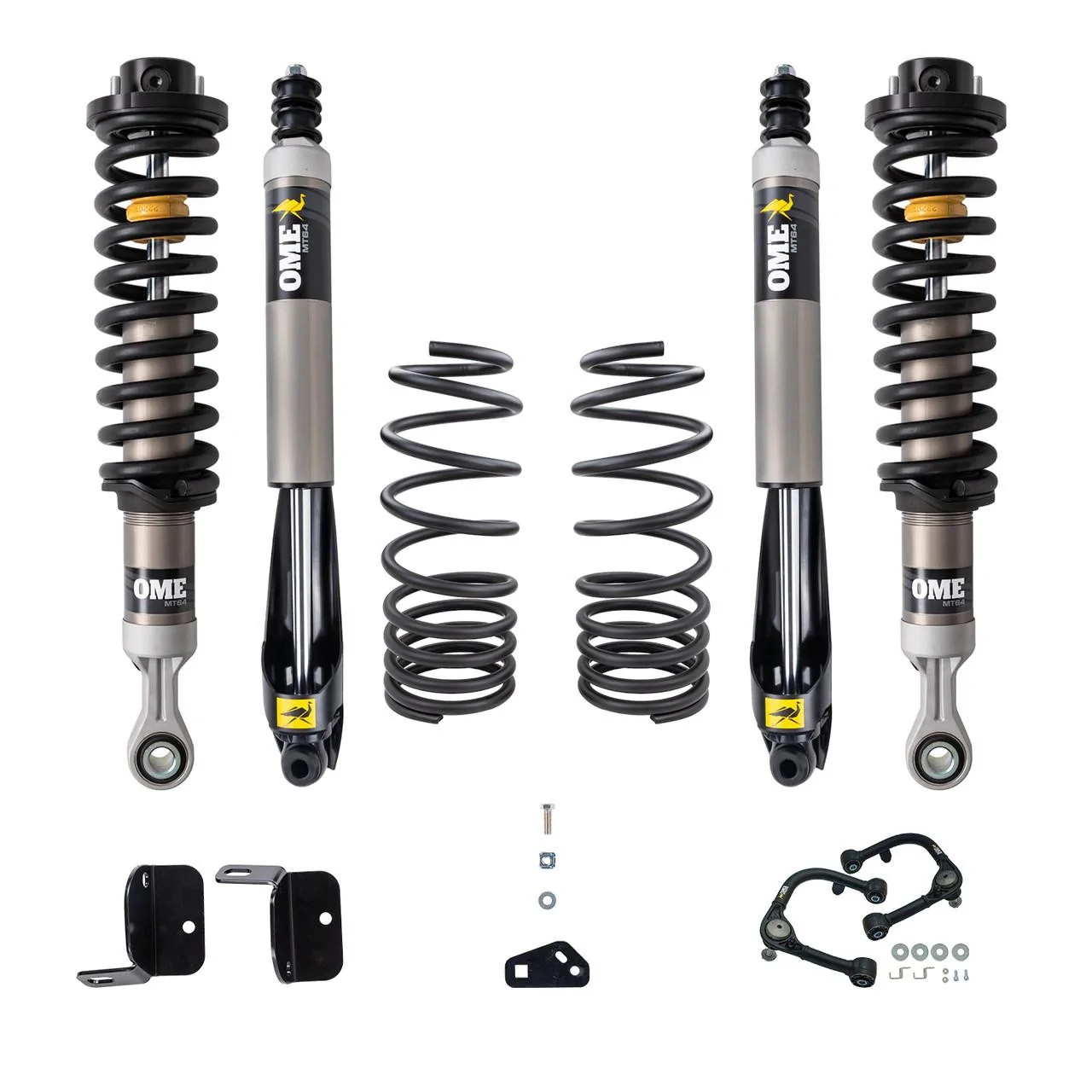

Not a fan of Bilstein after my last vehicle install. Have you considered the Old Man Emu MT64 ?
feel the ride would be much better than the Bilstein ?!
We did the Old Man Emu MT64 2135K and are extremely pleased with the results!
Also we do not believe in spacers so at least you're considering a suspension lift rather than spacers!
Come's ready to install 4Hrs we had ours Done !
