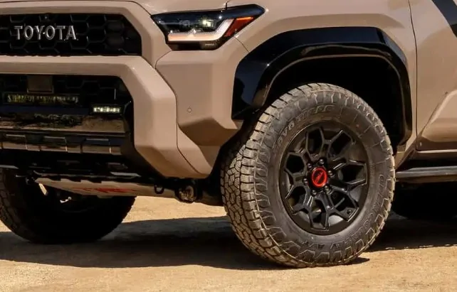

Those wheels look to be poking out more than usual. Are you running wheel spacers? The pro wheels have a +20mm offset and poke a good bit, but those TRD Premium upgrade wheels that you are running have a much narrower offset (+45mm)
These are factory 4Runner TRD Pro wheels with no spacers. The offset is about an inch wider (I think 30mm maybe). So they do have just a little poke.

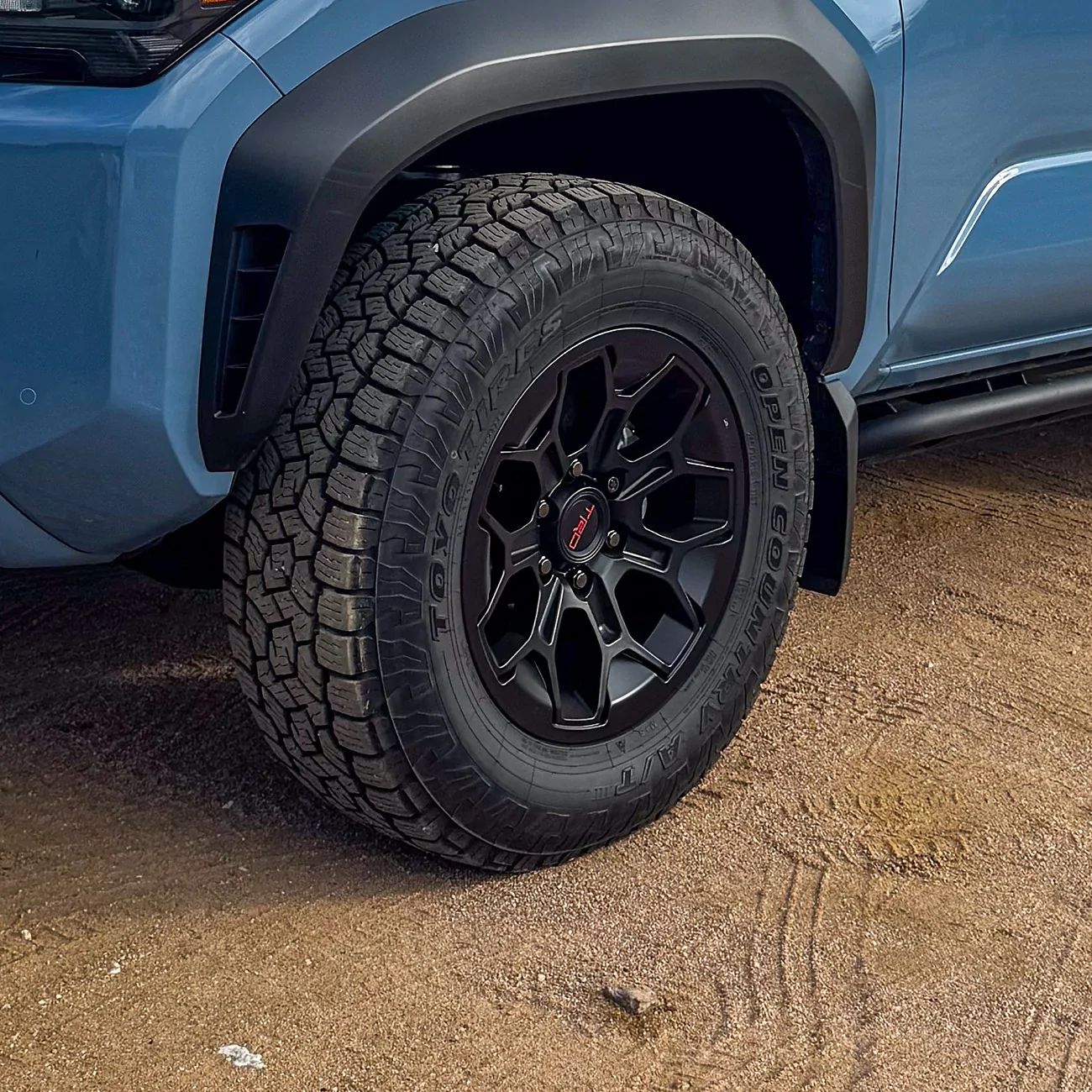

Those are not the TRD pro wheels. Those are the TRD Upgrade wheels. They have a +45mm offset. These will not poke outside of the fender unless you're running wheel spacers.
2025 2026 4runner 6th gen Platinum...Pro? Build on King 2.5" shocks raised 3" front / 1" rear + TRD Pro Wheels + 285/70R18 AT4W 536389 (1)

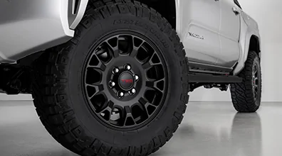

The TRD Pro wheels are these. They have a +20mm offset which is much wider.
2025 2026 4runner 6th gen Platinum...Pro? Build on King 2.5" shocks raised 3" front / 1" rear + TRD Pro Wheels + 285/70R18 AT4W prowheel
