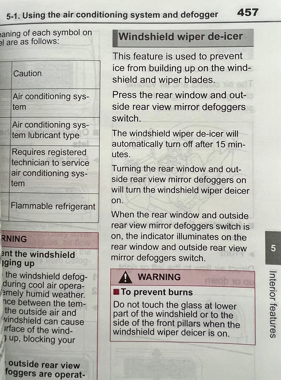

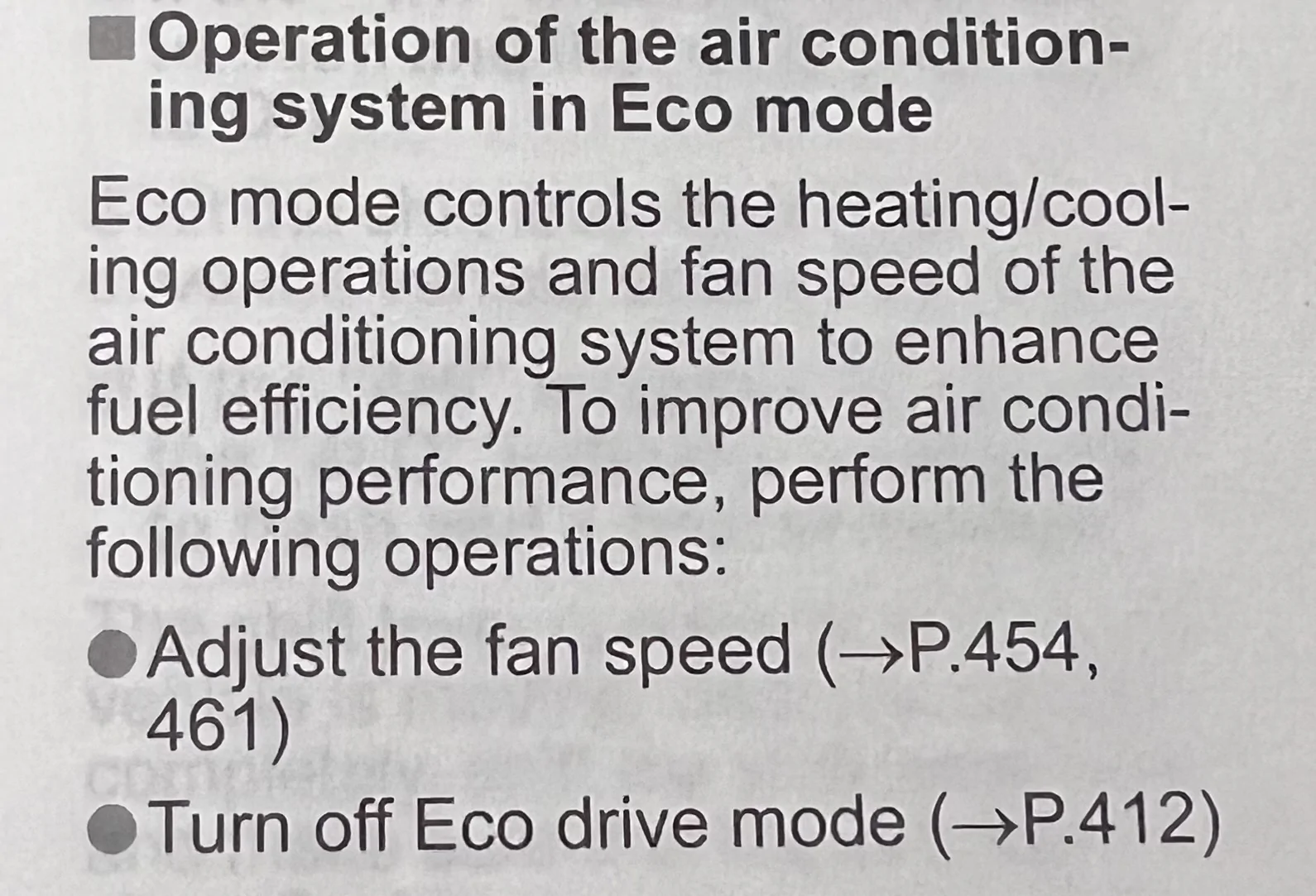

All good and working fine up here in Canada.
Works better if you’re not in ECO Mode and the wiper blade de-icer is connected to the rear window de-icer switch

Good info... I think I read it once and since forgot.
I have to comment on the Toyota manuals after reading the pic you included. Could they have worded it any more confusing? Same with most other sections. They desperately need an English translator to rewrite this stuff.

thanks but trust me I reread that part of the manual like 5 times hahah, im in normal mode
Yes I agree, when I’m in the owner’s manual I always have to read the sections 3 or 4 times to make sure I get it right. Probably some AI issues.

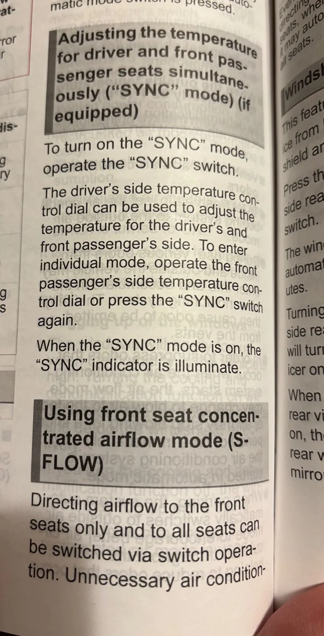

I think it is strange that it says when the S-Flow switch is ON and illuminated it MAY still direct air flow to the back seats if a back seat is occupied.
Why “may”?? If it doesn’t, I would be wondering why not.
(Hybrid manual pp452-453)

Ah thank you. Always wondered what it was.
it also lower fans speed in that mode. if you turn it off and manually shut off the rear vents, you get stronger airflow from the system when you turn it off
the front vents i get stronger airflow since i sit little further back in the cabin than normal. great for these extreme cold temps lately where i just have to raise my hand at the wrist to get some decent fast air across my hands to warm up at the gear shifter.
