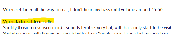

A quick update of what I currently find.
When set fader all the way to rear, I don't hear any bass until volume around 45-50.
When fader set to middle:
Spotify (basic, no subscription) - sounds terrible, very flat, with bass only start to be visible around volume 35
Youtube music with Premium - much better than Spotify basic, I can start hearing bass at around volume 24 - 30
Apple music (with stored filed on phone not streaming) - sounds best out of the three at same volume.
Test condition: all three source listened within 10 min and switching directing from each other through wireless apple-carply.
Test music: Eminem - Loose Yourself
Source seems to be very important here.
I'm sure Spotify with Premium will sound similar or equal to Youtube Music premium.
Spotify basic: Audio Quality: Lower quality (128-160kbps)
Spotify Premium: High-Quality Audio: up to 320kbps on desktop/mobile.
Youtube Music Premium: Audio Quality: Up to 256kbps.
Apple Music: Hi-Res Lossless: Up to 24-bit/192 kHz (highest quality)
Keep in mind only Apple music provides lossless, so it will defenitly sound better than Spotify Premium and Youtube Premium.
Also Youtube Premium only sounds "louder" than Spotify, it doesn't nessesary means it is better quality.
Also I look up the Tacoma has subwoofer at the driver side rear seat, and I realize that my coworker had the seats down for his dog, this may have some effect in more direct bass.
I am starting to think this is normal on our vehicle... but will have dealer check and compare to others anyways.

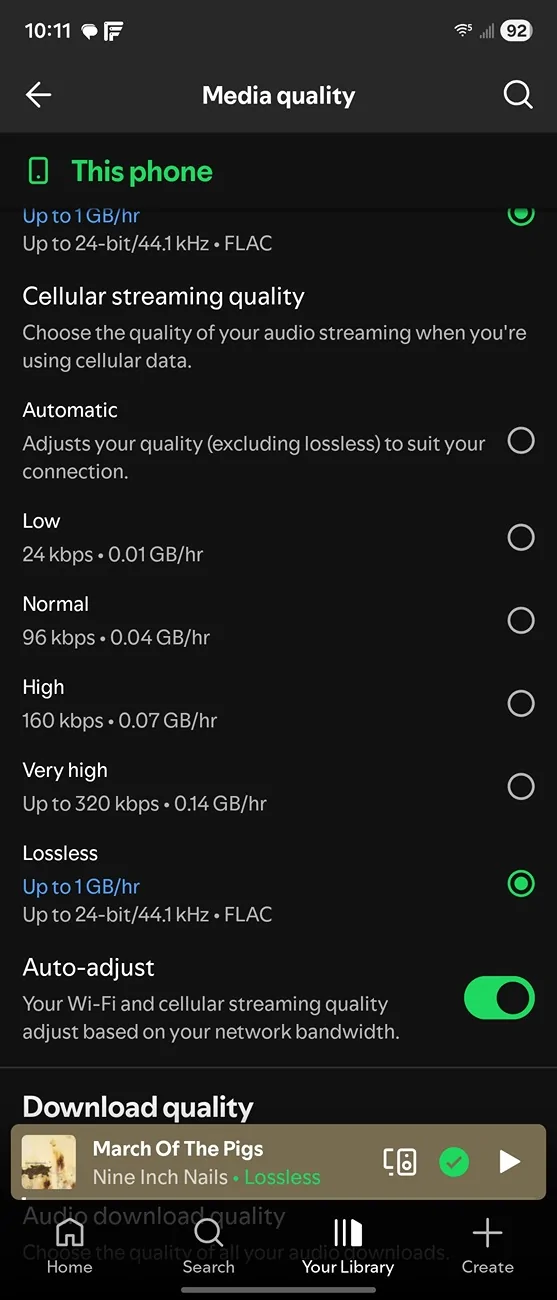

Just a heads up that Spotify does have lossless 24bit/44.1kHz
It is wild how the speakers feel like two different systems at 30 to 45
