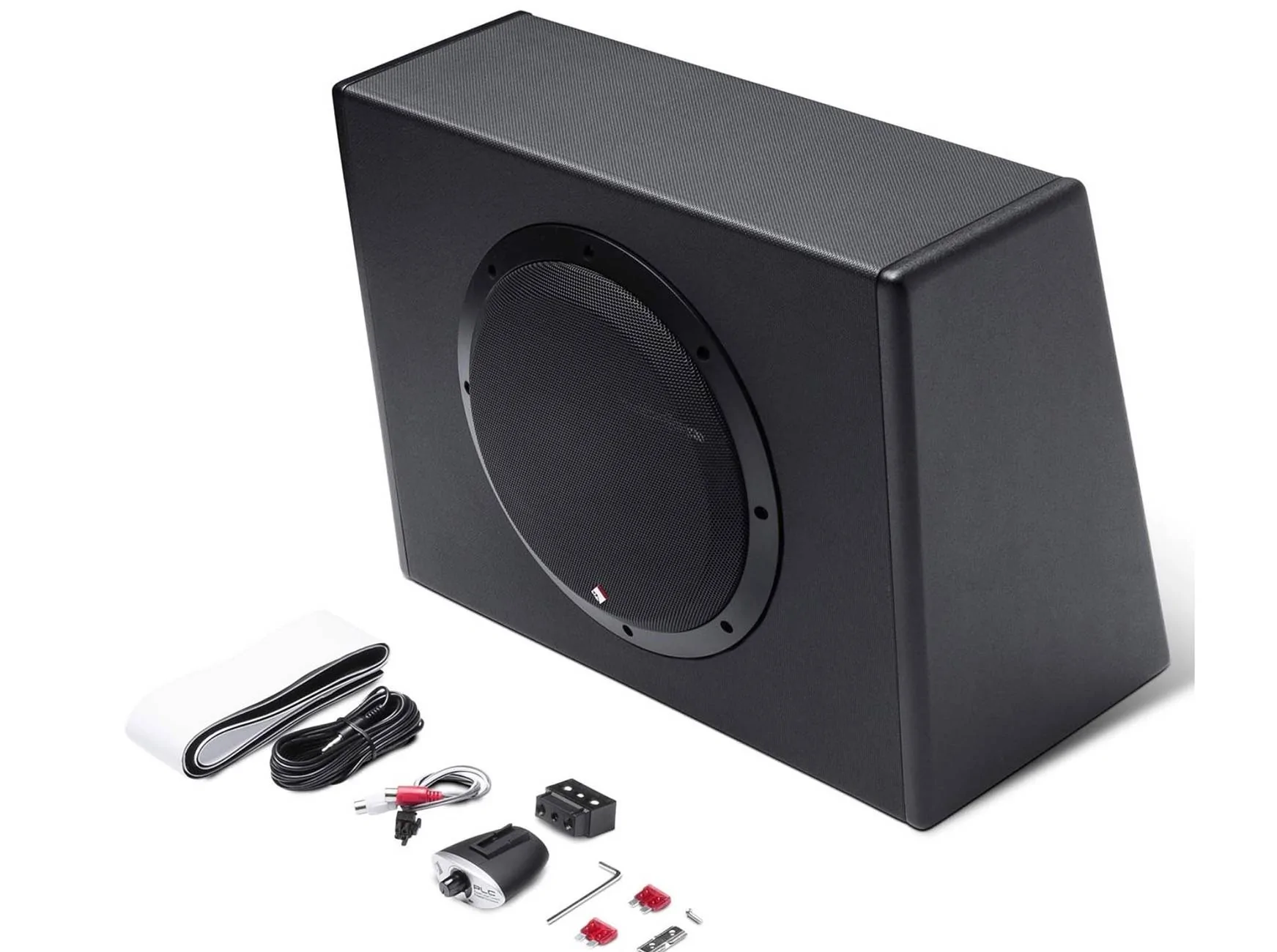

I recently installed a sub in my 2022 4Runner and decided to add another one to my Trailhunter. For the setup, I used the 10" Rockford Amp/Sub combo, which sounded great in my previous 4Runner. To make the install easier, I went with the Tacotunes kit, since I have the JBL speakers. I also ordered the speaker wiring harness and remote turn-on kit (skipped the LCI Pro, since the sub can handle high-level inputs).
One of the advantages of the Hybrid setup is that the battery is in the back, which made running the power wires super simple.
I also had to disable the artificial engine noise, as another post here mentioned. Without doing that, the sub produced a low rumbling effect. I picked up the Carista app and was able to disable that feature with ease.
I'm really happy with both the install and the sound quality.

Hmmm. I'll try to respond to your comment... (1) The factory sub sucks as you really have little to no control of it's output without crashing the entire set of speakers. The system gets muddy and strained when you turn up the bass. (2) You get way cleaner and much lower, crisp frequencies with the aftermarket sub. (3) I can easily remove it whenever I need space. I purposely installed it with a quick plug to its dedicated amp.

I left the factory sub alone, it’s really not that great. The Rockford sub won’t fit in the factory sub location-see pic. I was also able to hard wire an always on cigarette lighter plug to all the supply power to my mini fridge. Sub sits right behind the driver rear seat.
