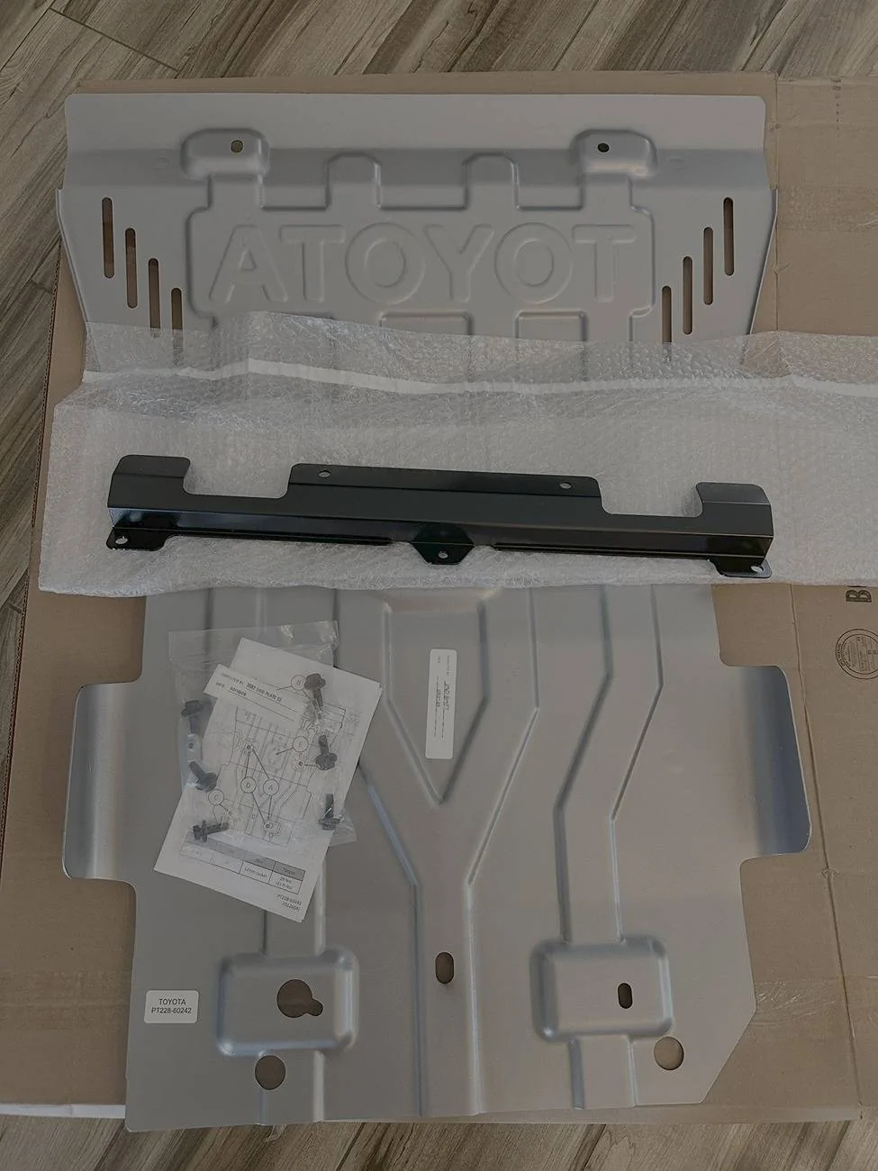

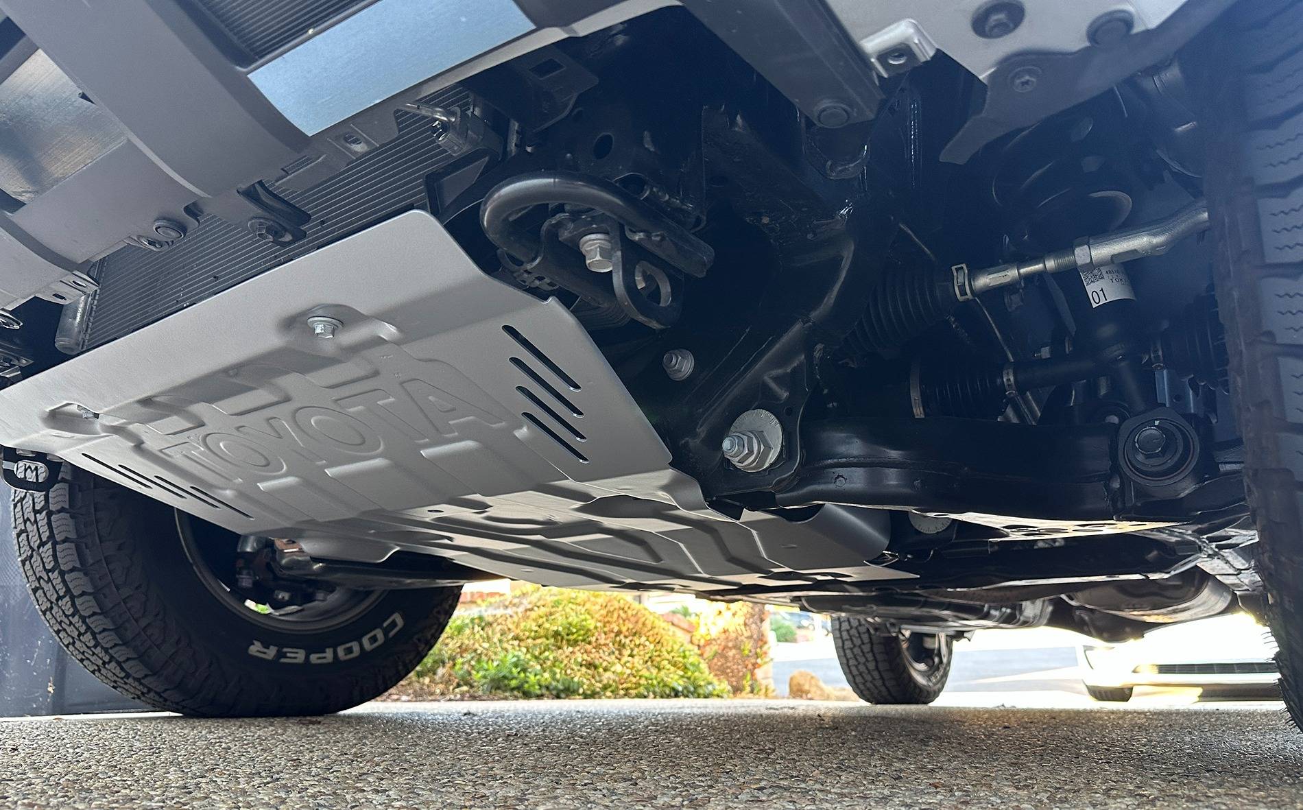

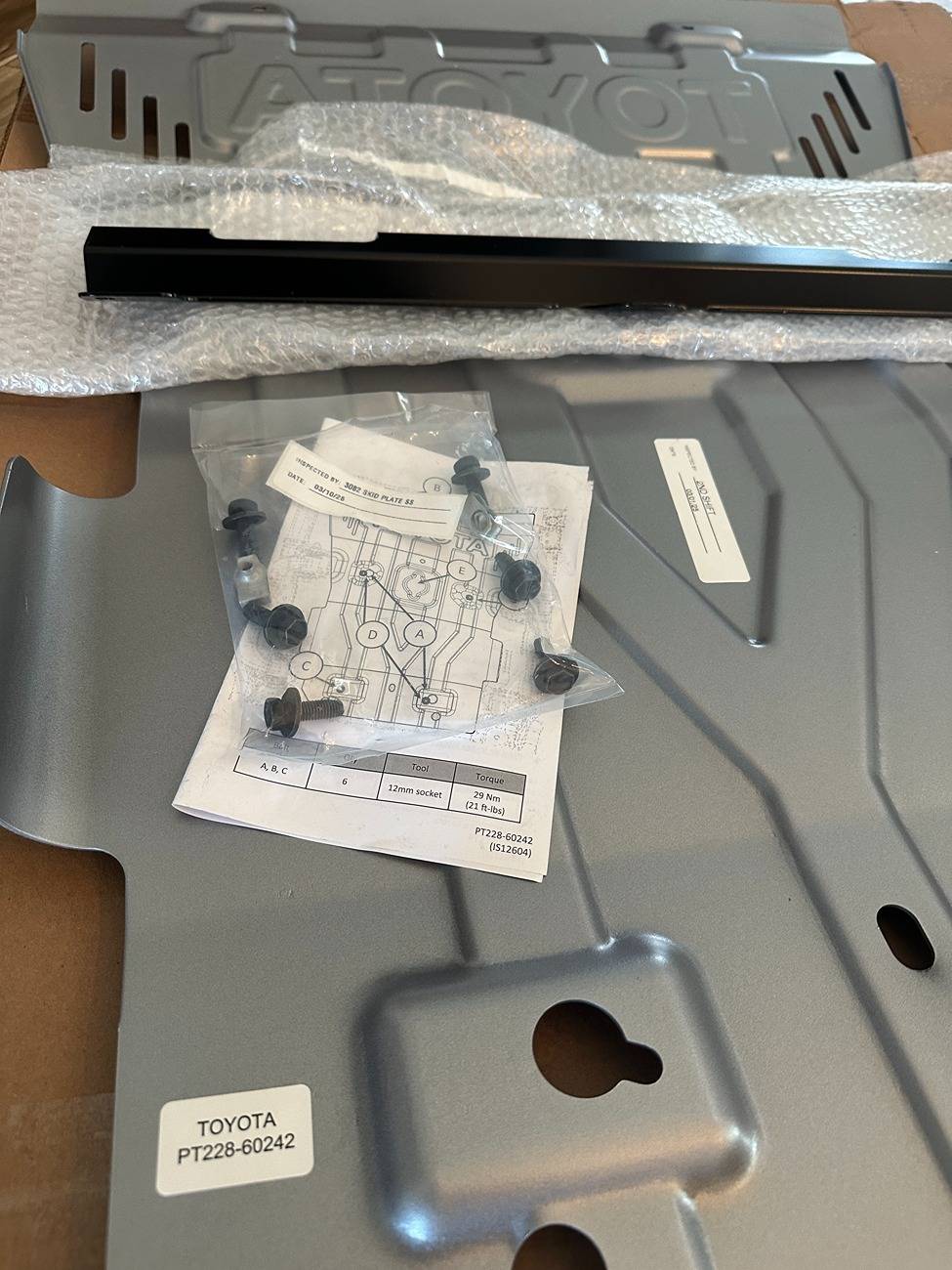

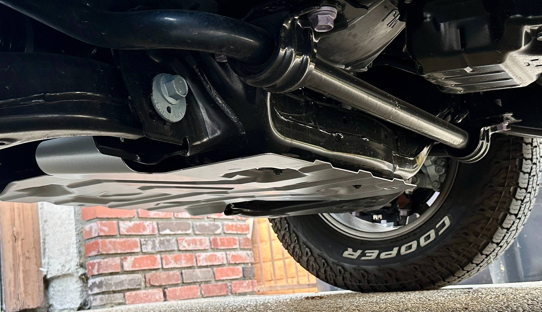

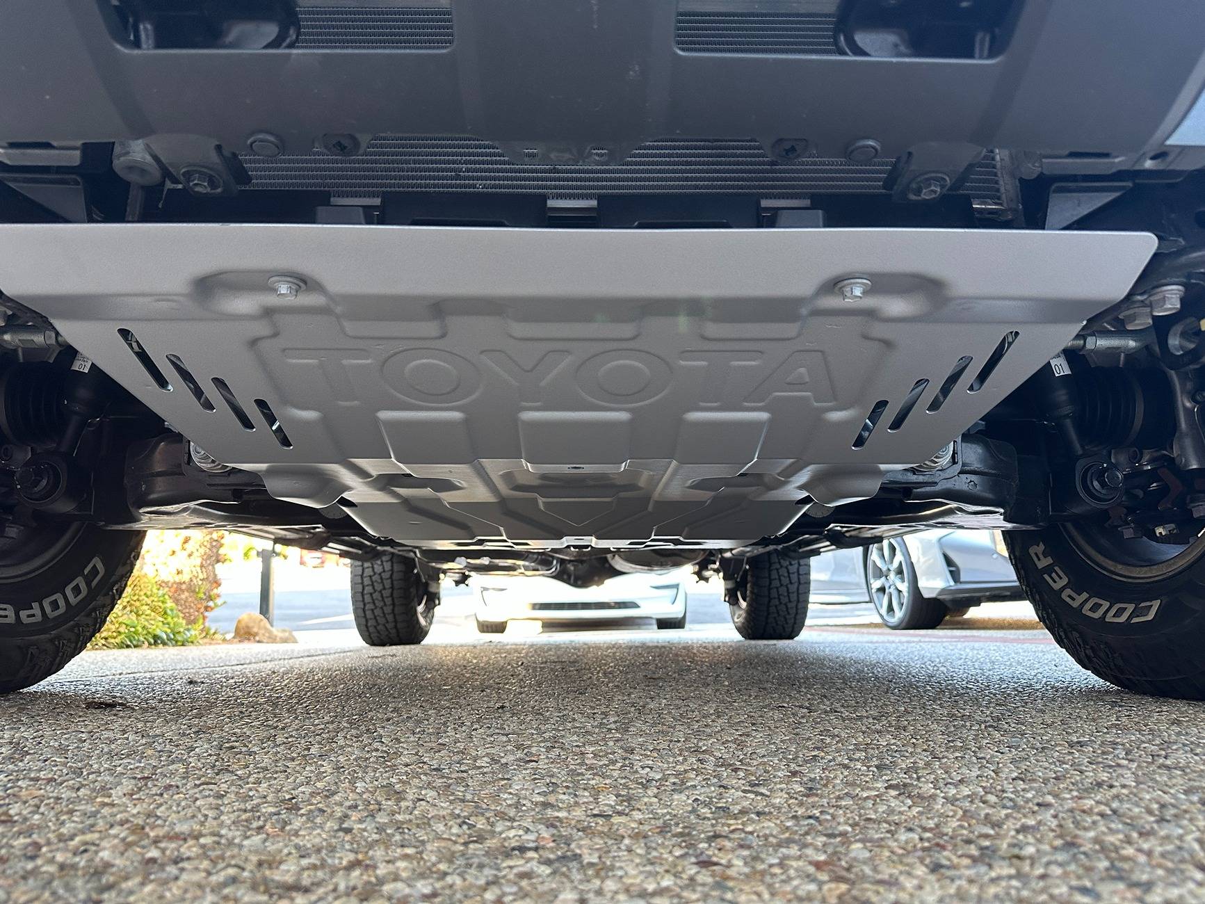

I just installed the Land Cruiser FRONT skid plate, PT228-60242, on my 6th Gen SR5 4Runner(NON-HYBRID). Installation was a breeze and all the holes lined up EXACTLY. The kit comes with (6) 12mm bolts and a black metal bracket which I did not use (probably for a Land Cruiser). It took me all of about 20min to install by myself. Dimensions are approximately 28.5" x 38".
Purchased from my dealerships website ($360) and picked up at their parts department. Oddly, this saved me about $150 as opposed to doing a "walk-in" purchase.
** FYI, the slotted holes are to hang the skid plate in place, for single person installation.
Hope this helps
2025 4runner 6th gen Land Cruiser skid plate fits Hybrid 2025+ 4Runner 6th gen (installed on TRD Off-Road). Part number # inside IMG_3966
2025 4runner 6th gen Land Cruiser skid plate fits Hybrid 2025+ 4Runner 6th gen (installed on TRD Off-Road). Part number # inside IMG_3964
2025 4runner 6th gen Land Cruiser skid plate fits Hybrid 2025+ 4Runner 6th gen (installed on TRD Off-Road). Part number # inside IMG_3983
2025 4runner 6th gen Land Cruiser skid plate fits Hybrid 2025+ 4Runner 6th gen (installed on TRD Off-Road). Part number # inside IMG_3965.JPG
2025 4runner 6th gen Land Cruiser skid plate fits Hybrid 2025+ 4Runner 6th gen (installed on TRD Off-Road). Part number # inside IMG_3980.JPG
2025 4runner 6th gen Land Cruiser skid plate fits Hybrid 2025+ 4Runner 6th gen (installed on TRD Off-Road). Part number # inside IMG_3982

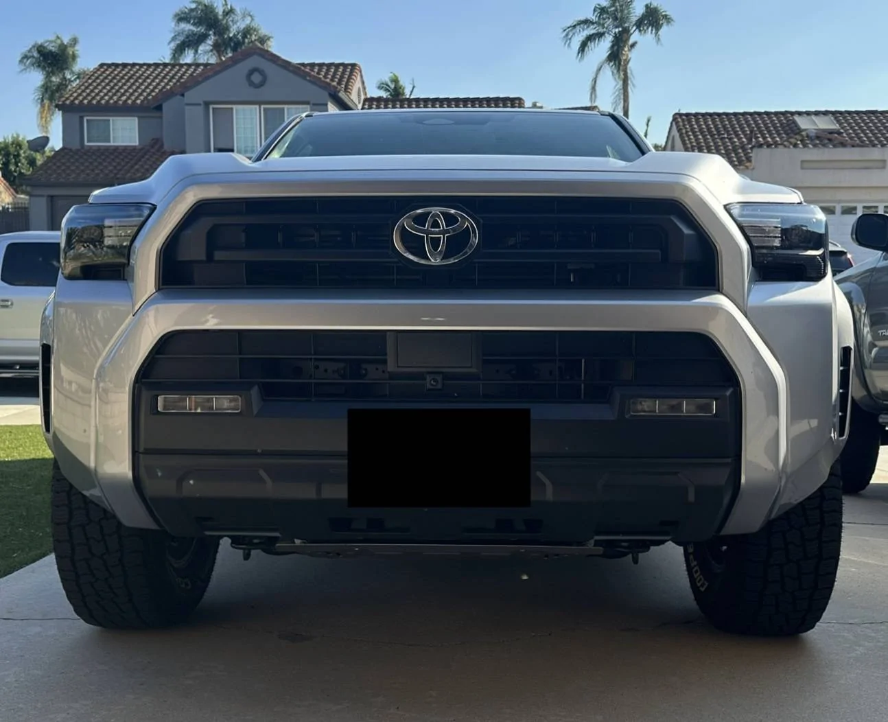

Looks Great! Did you end up using the molded piece?
Negative. The original piece ended up in the trash. The skid plate completely replaces that and extends much further back.
Also, you could still use the air dam with this skid plate, if you chose. It does not extend any further forward than the OEM fiberboard original.
