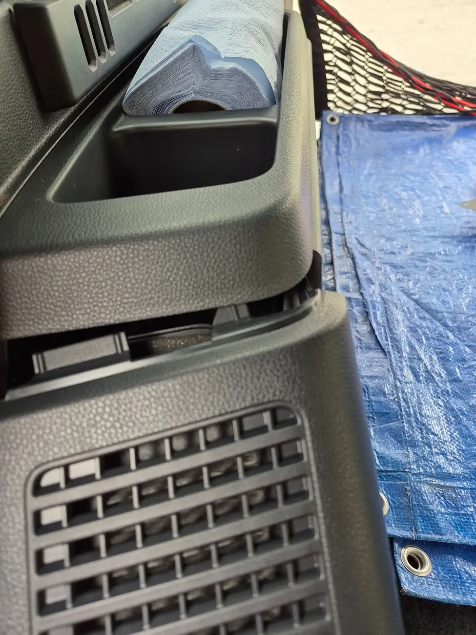

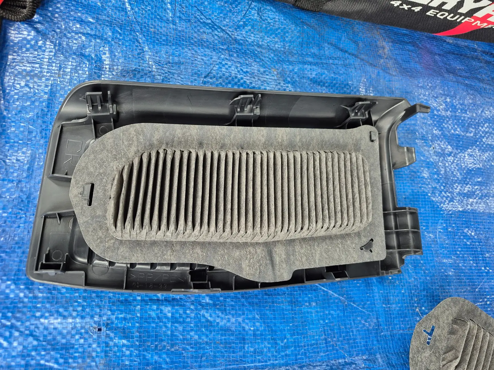

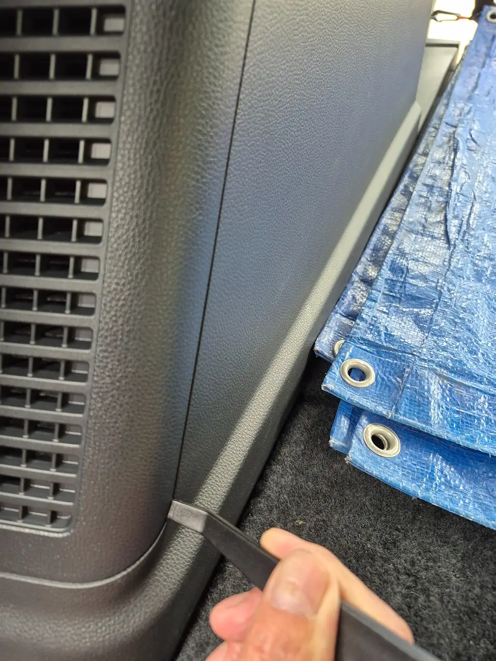

How do I access those filters?
Manual section 6.3 (P555 in my manual - probably same in yours): "Cleaning the hybrid battery (traction battery) air intake vents"
Filter cover pops off from bottom (manual says screwdriver - I used plastic trim pry tool)
Filter pops off cover - 3 tabs.
relatively easy. Mine seemed relatively clean even when I had lots of dust in the vehicle after off-roading with the sunroof open and front/tailgate windows down.
A previous thread included the information below. (Apologies to whomever contributed it. I archive comments that seem relevant to my needs, but I am not good about recording who posted them!)
“Take my word, not only were the filters dirty but the tube and foam leading down to the fan were coated. The Toyota parts manager said they had a hybrid in this week with an overheating battery and when they took the covers off they found the filters clogged. These fans really move some air, do not recommend driving on dusty road with rear windows down.
To remove, just use a trim panel removal tool and work the lower inboard corner so you can grab it. Once corner is out, give a careful firm tug and it'll pop out and should come free, Note the upper tabs that go behind the top piece.”
