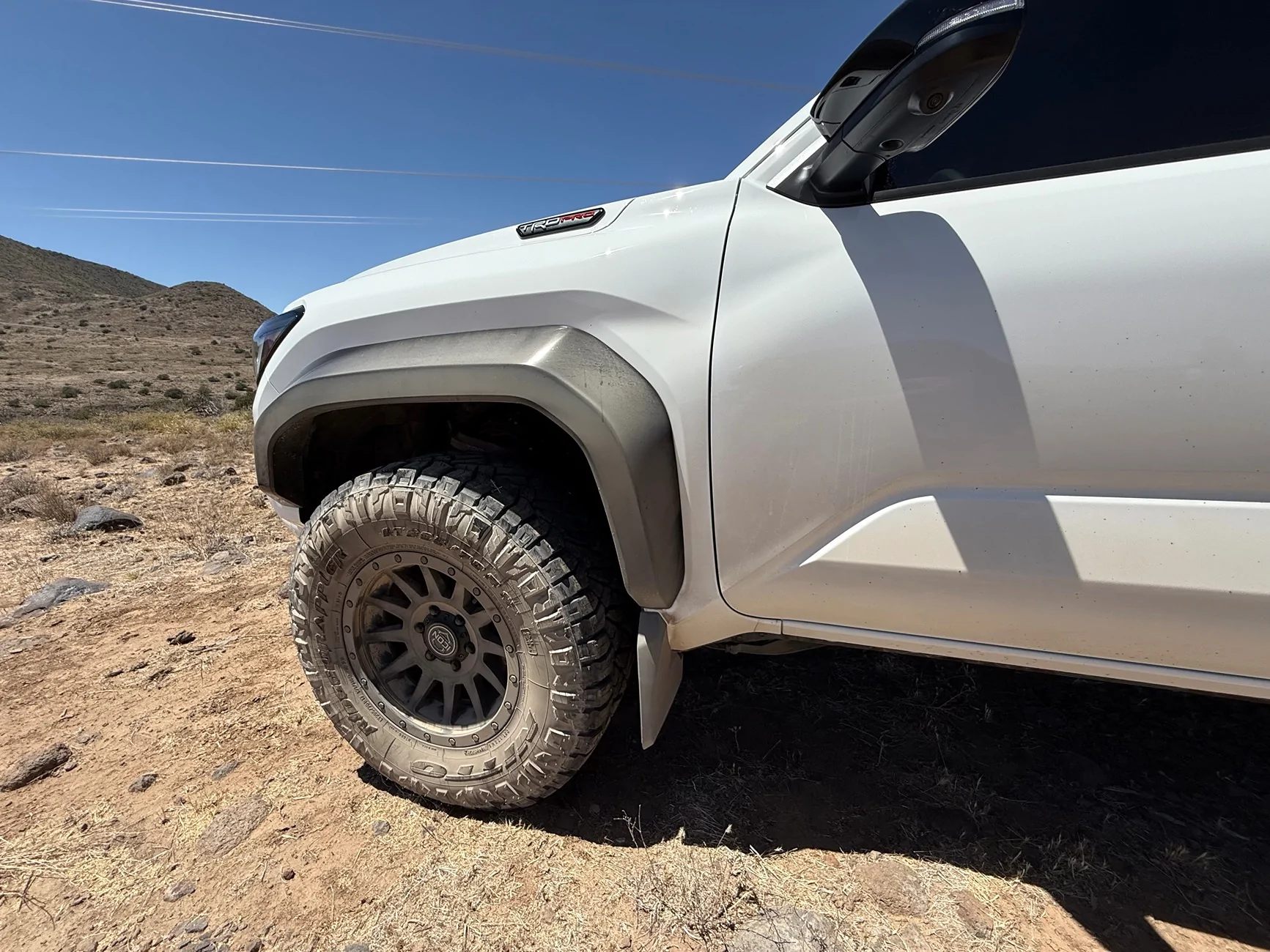

-Wheels and tires
17” Icon Rebounds w/ +25 offset
285/75R17 (34”/11.5”) Falken Wildpeak AT4s

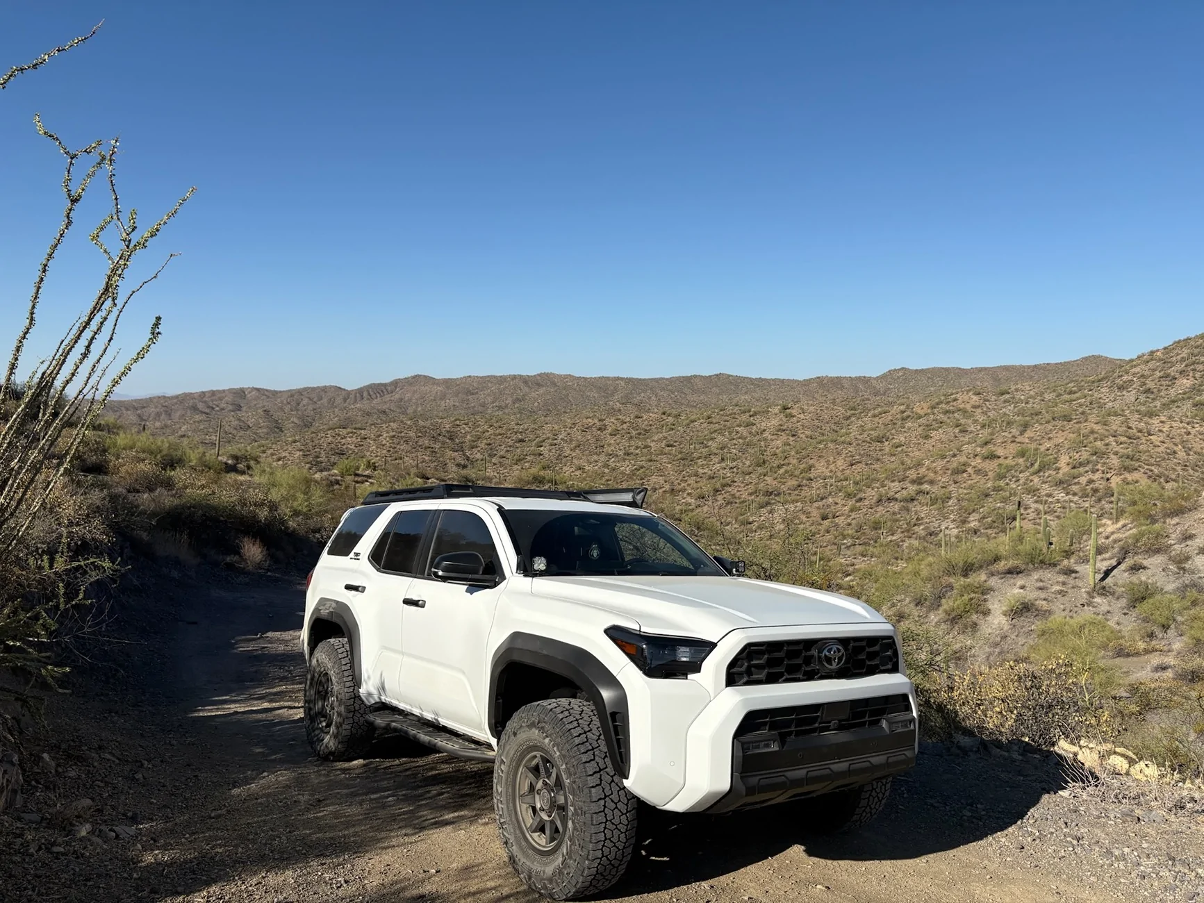

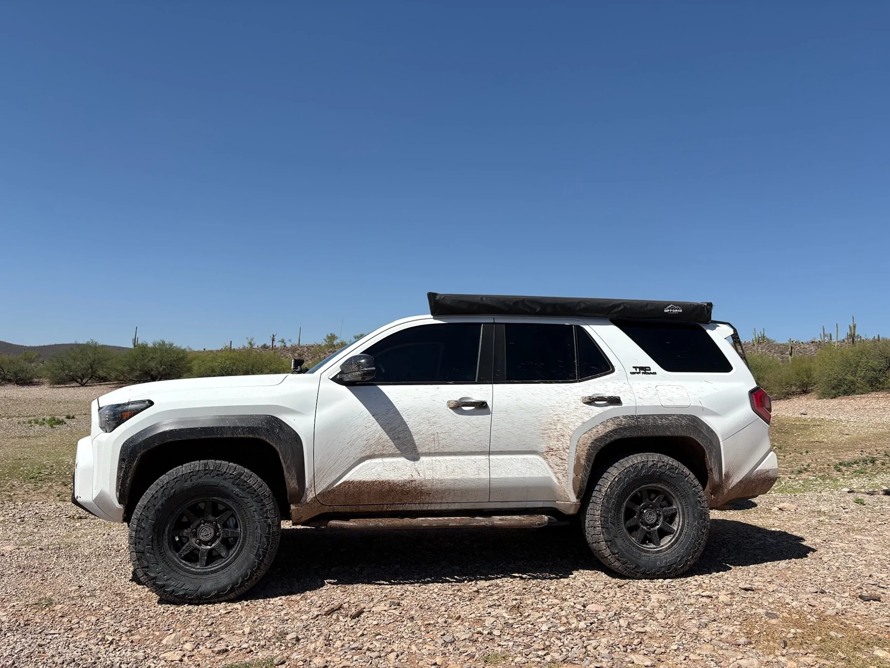

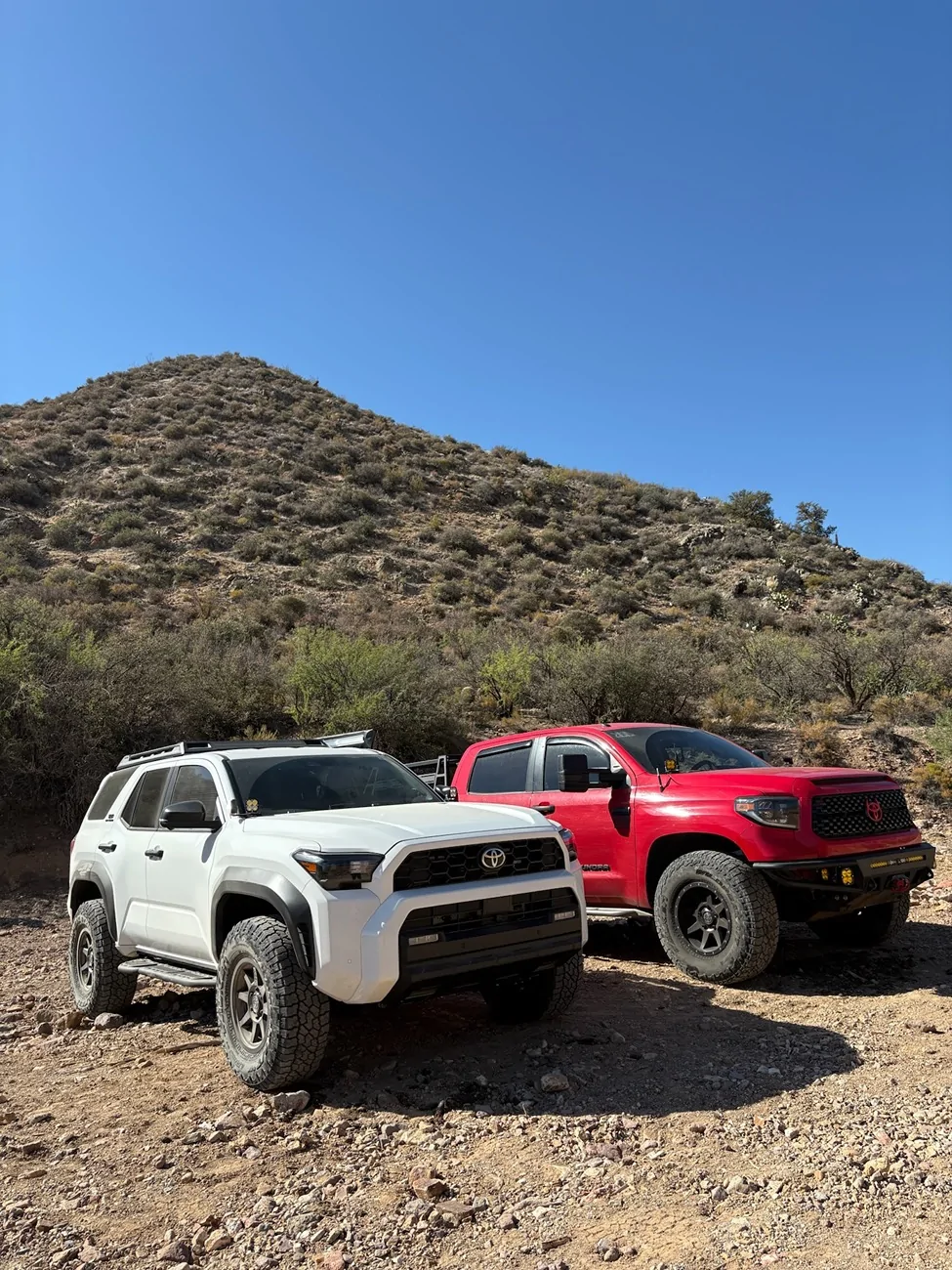

2025 4runner 6th gen ORP on Hellsgate Wilderness Trail in AZ (OnX trail rating 5) IMG_0220

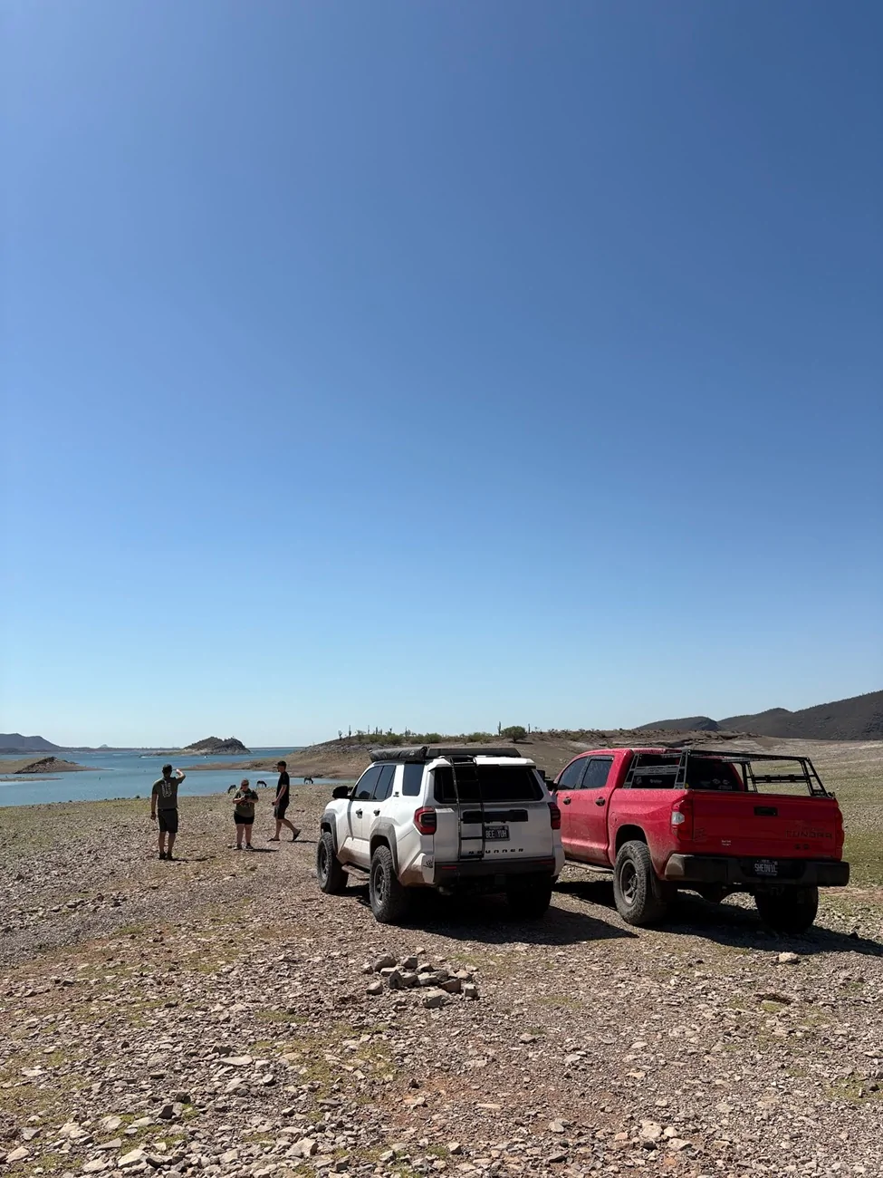

We have been serious off-roaders for years now and my Wife decided she wanted her own. She does have a lot of seat time in our mid travel 16 Tundra. But this was our maiden voyage with her 4R.
Hellsgate Wilderness Trail is rated a 5/10 on OnX. It’s located just west of Lake Pleasant Regional Park. Has a few obstacles, fast sections and some pretty cool hill climbs. So we figured it would be the perfect trail to test everything out. Trail took about 1.5 hours and after we hit a side trail that took us down to the back side of the lake.
We had the wheels and tires before we installed the lift and the ride took a pretty good hit. It was pretty rough. Once we put the preload collar on we are almost back to a factory ride. The stock TRD off-road shocks are very impressive and I don’t see us switching them out any time soon.
Rear travel is actually very good.
Front travel is ok. lol.
We had no issues with clearance anywhere on the trail.

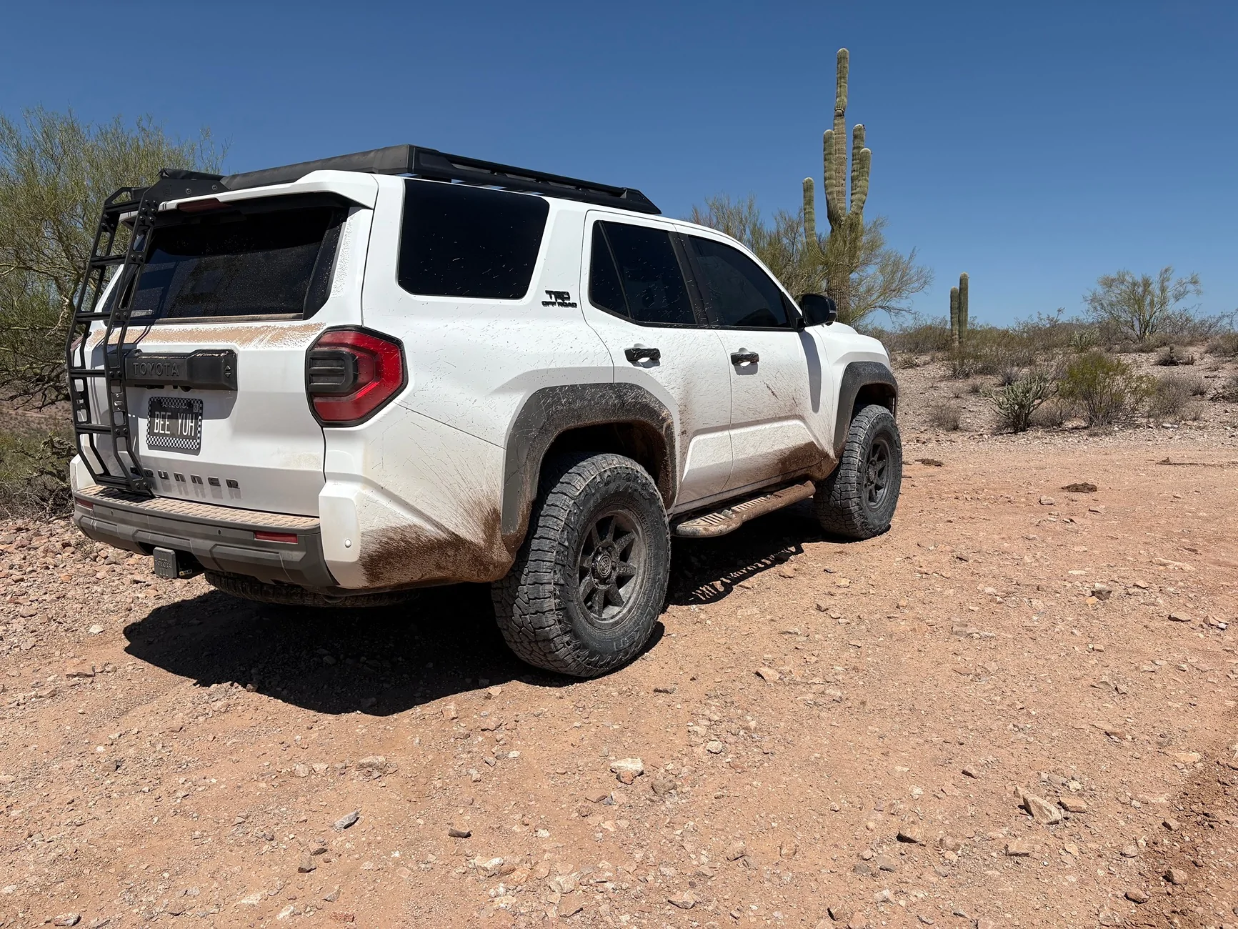

2025 4runner 6th gen ORP on Hellsgate Wilderness Trail in AZ (OnX trail rating 5) IMG_0185

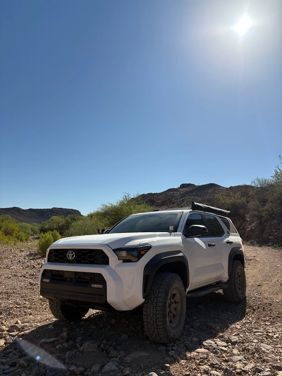

2025 4runner 6th gen ORP on Hellsgate Wilderness Trail in AZ (OnX trail rating 5) IMG_0156

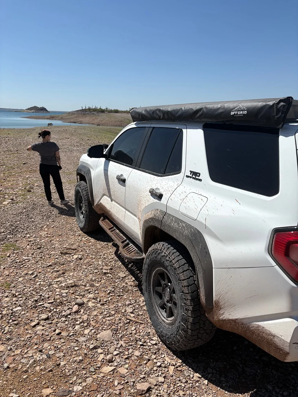

2025 4runner 6th gen ORP on Hellsgate Wilderness Trail in AZ (OnX trail rating 5) IMG_0214

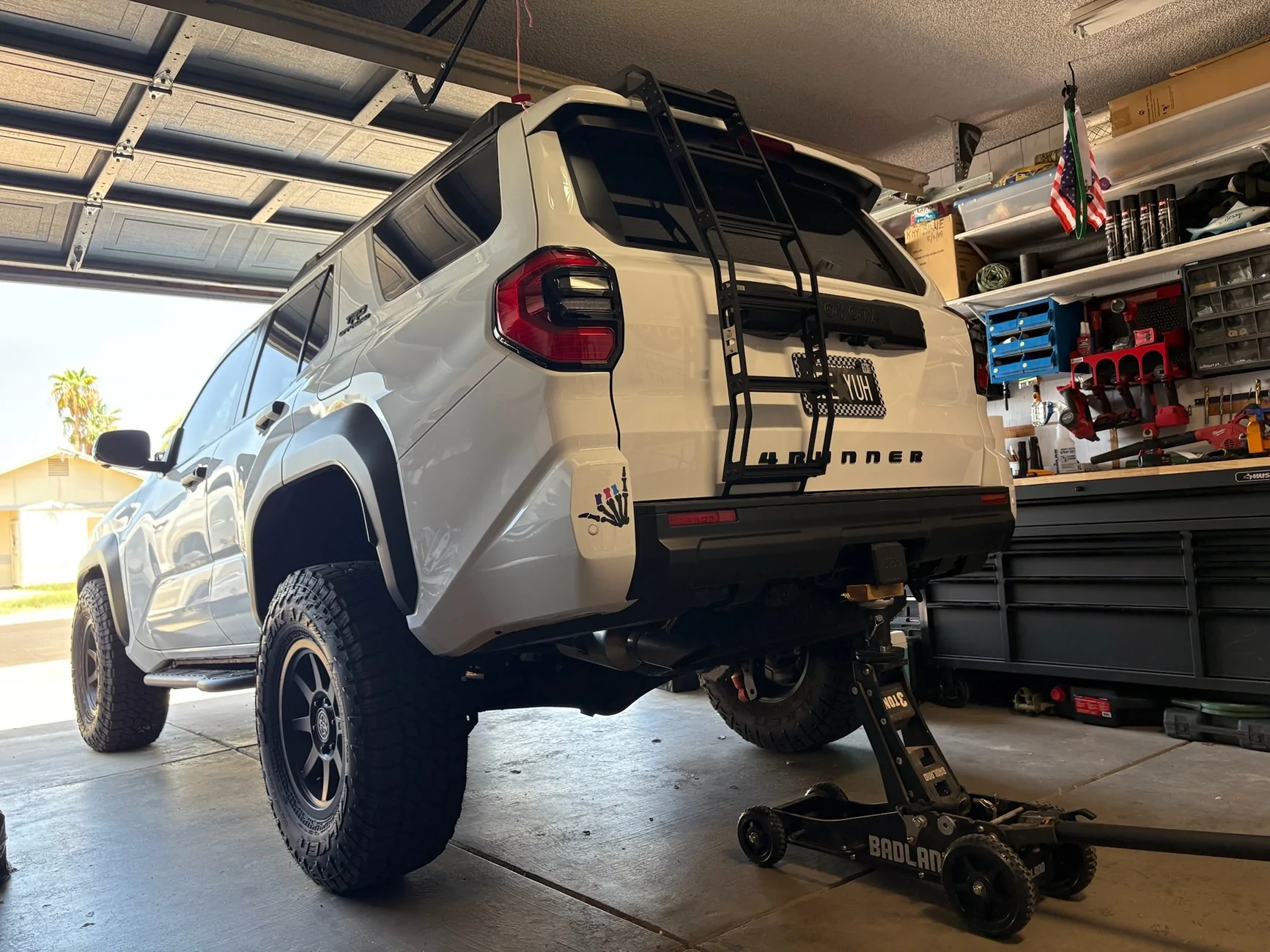

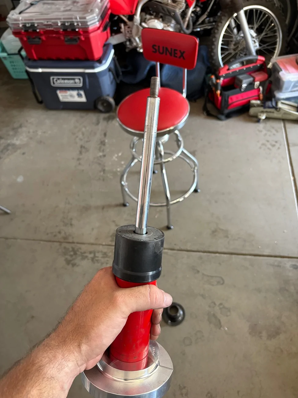

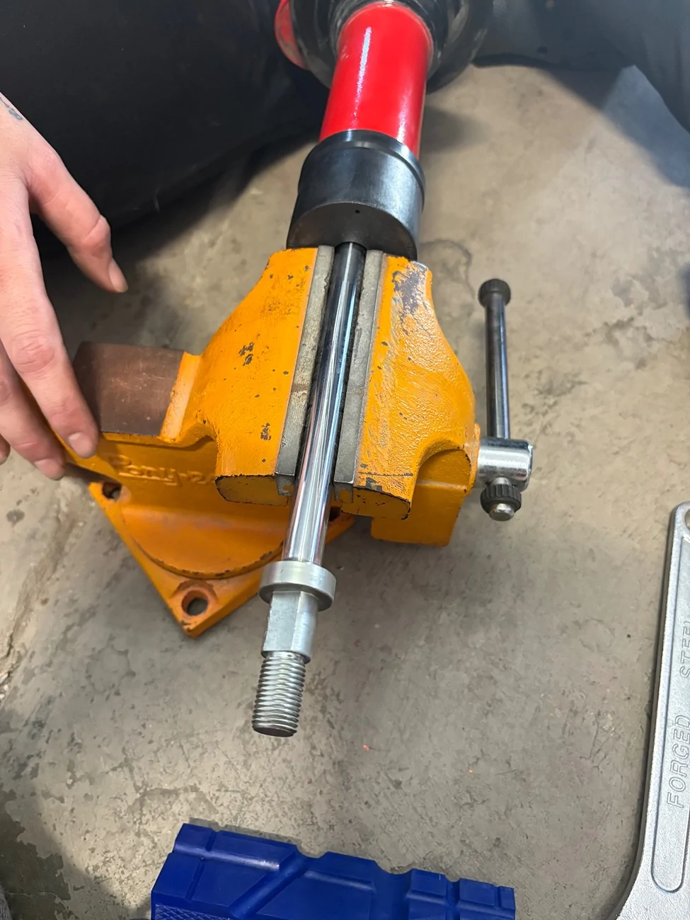

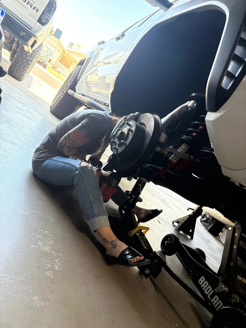

Preload collar lift install
The install was straight forward and simple.
The hardest part is on the TRD OR shock you need to remove the tip of the shaft in order for everything to slide off and on. After many failed attempts at getting it clamped in a vise without damaging the shaft I found the heat was the answer. The tip has lock tight on it from the factory and heating it up softened it and made it very easy to come off.

Our Tundra just cause I wanted too lol
2025 4runner 6th gen ORP on Hellsgate Wilderness Trail in AZ (OnX trail rating 5) IMG_5945
