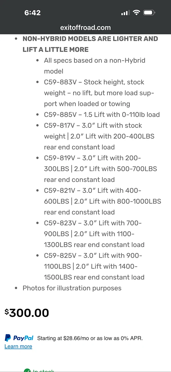

Which model Dobinson rear coils did you go with? I have an SR5 and did the Wescott F&R collar lift, but I carry about 200lbs of equipment in the back so my rear is noticeably lower than the front. I contacted Dobinson and they recommend installing the C59-817V and to remove the rear spacer.

I went with C59-885V (1.5 Lift with 0-110lb load) but you would have to figure out approx how much weight you have back there. (See pic) You have to select the coil based on normal everyday load, not the anticipated/potential load.
This thread has been really helpful as I’m having the Westcott kit installed on my ORP (non-hybrid) next week. I am concerned that I will end up with rear sagging when my cargo area is loaded down. To clarify, you installed the Westcott rear collars on top of the Dobinson springs? Approximately how much rake did you retain with that setup? Pictures would be awesome if you don’t mind! Thanks in advance.
No, I went with heavier duty coils from
Dobinsons plus the Westcott spacer that comes with their spacer lift. Dobinsons (exit off road) told me that Westcott rear spacer would not work with thier coil but it worked just fine so don’t buy one from them. Westcotts is heavier duty anyway. When my 4Runner is loaded with gear it should maintain the height in the back. You’ll want the coil that corresponds with how much weight you have on a daily basis. Not potential weight.

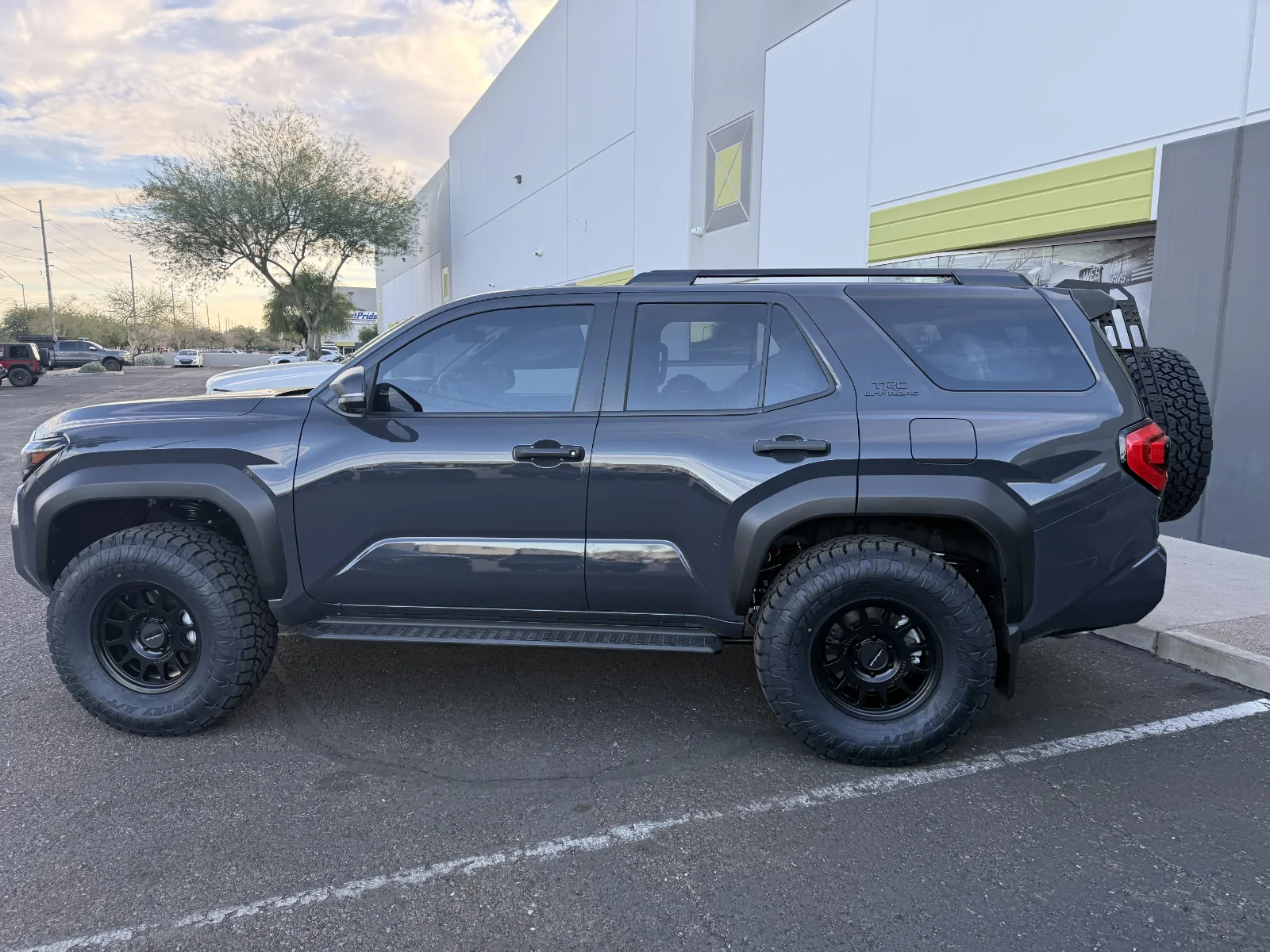

I don't have his Dobinson springs (still have the stock ones) but I thought this would help with the sag questions using the Wescott lift kit.
Here is mine the day I got my lift kit done with 35" tires on 17" wheels. What you can't see is the fact that the stock wheels and tires (all five) sitting in the back on my ORP. Total weight about 530lbs. I could not even tell the sag if they had not pointed it out when I was wondering where my stock tires were. I actually thought they forgot to put them in the back. Yes, there is a bit of sag but nothing that would concern me one bit, especially with ~530lbs in the rear. It drove fine on the way home and after getting the stock wheels/tires out I really can't tell the difference either way as far as handling.
