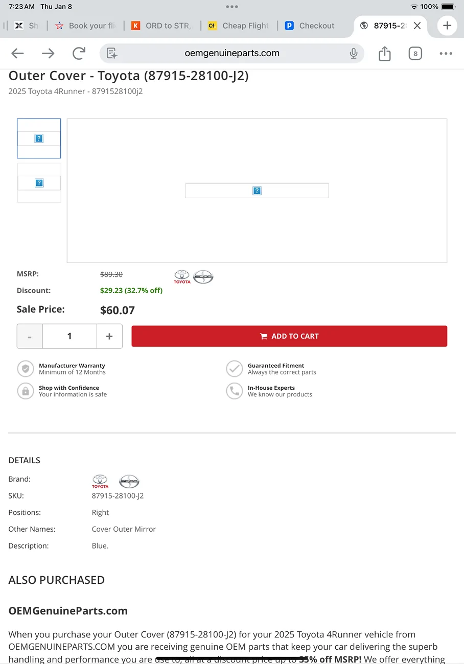

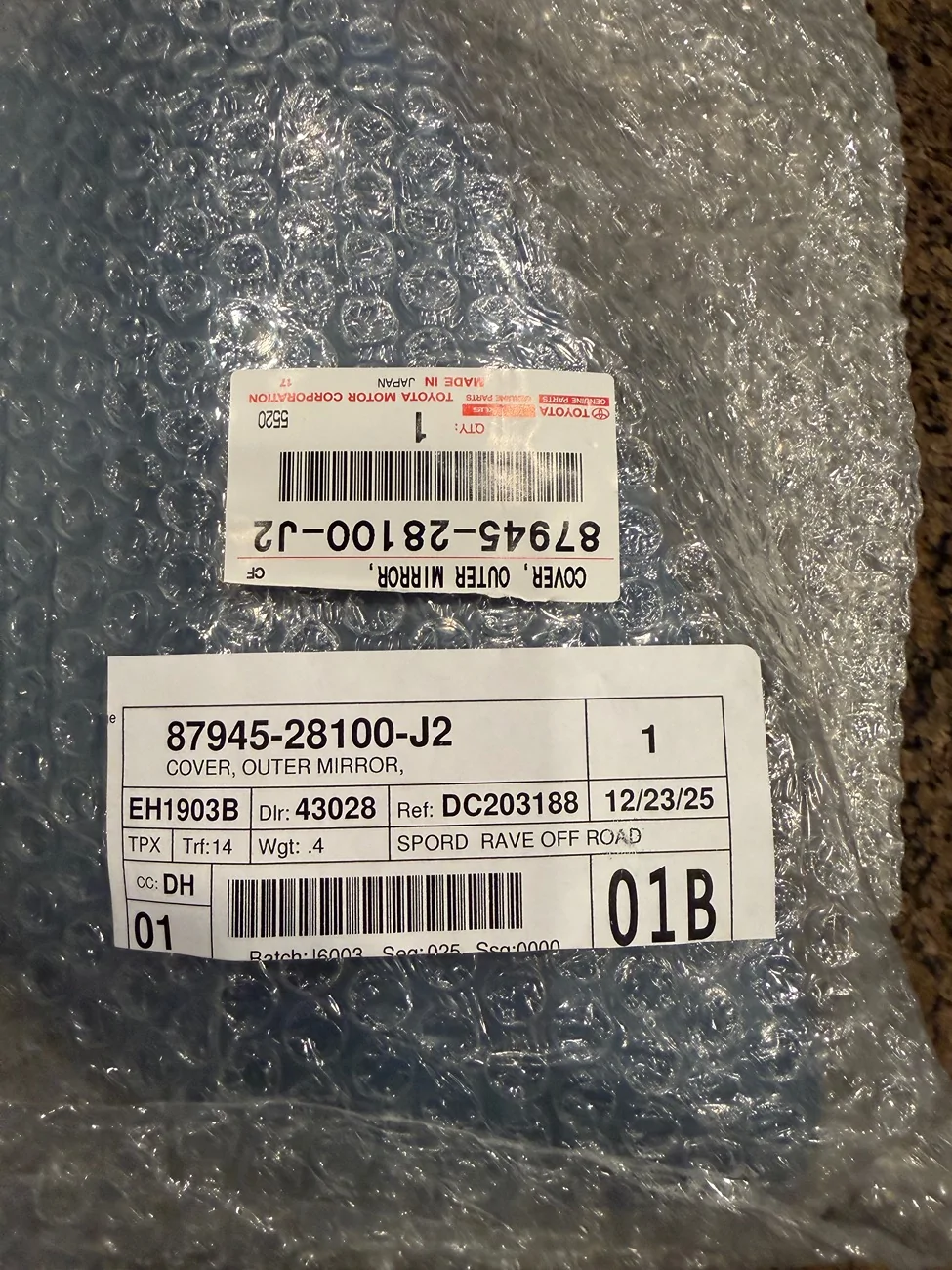

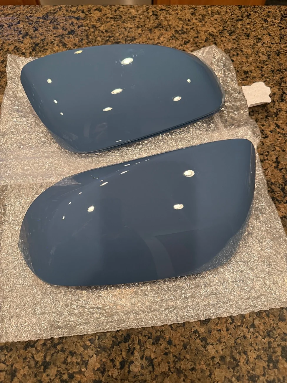

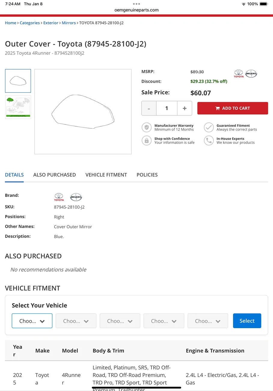

For anyone who’s interested in replacing their black mirror caps with matching colored caps, do not buy these mirror caps from Rave. I just ordered a set from them and realized I could’ve ordered them for $100 less on a Toyota dealer parts website. There’s nothing special about. Rave they literally drop shipped them from a Toyota dealer.

What are all the spots on the covers? They kind of look like abrasion spots.
I've had 2 differing sets of covers ordered from Rave for a period of time with absolutely no correspondence regarding my order. I rang him twice being told they would ship soon but still nothing. I've read several things recently on several forums which don't seem to be reassuring. I'm reaching out to PayPal this coming week. I appreciate your honesty. Thanks
Sorry to hear that. Mine took forever to ship, maybe 2-3 weeks? Yeah, definitely contact your bank or whoever you used to pay and try to get a refund. I had to do that with @wheelsfeels
My first order is from back in October. Heritage Blue LC250 Caps

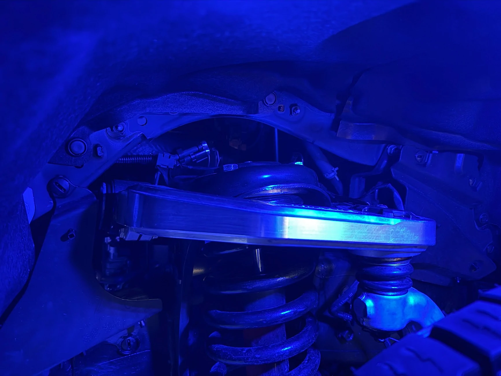

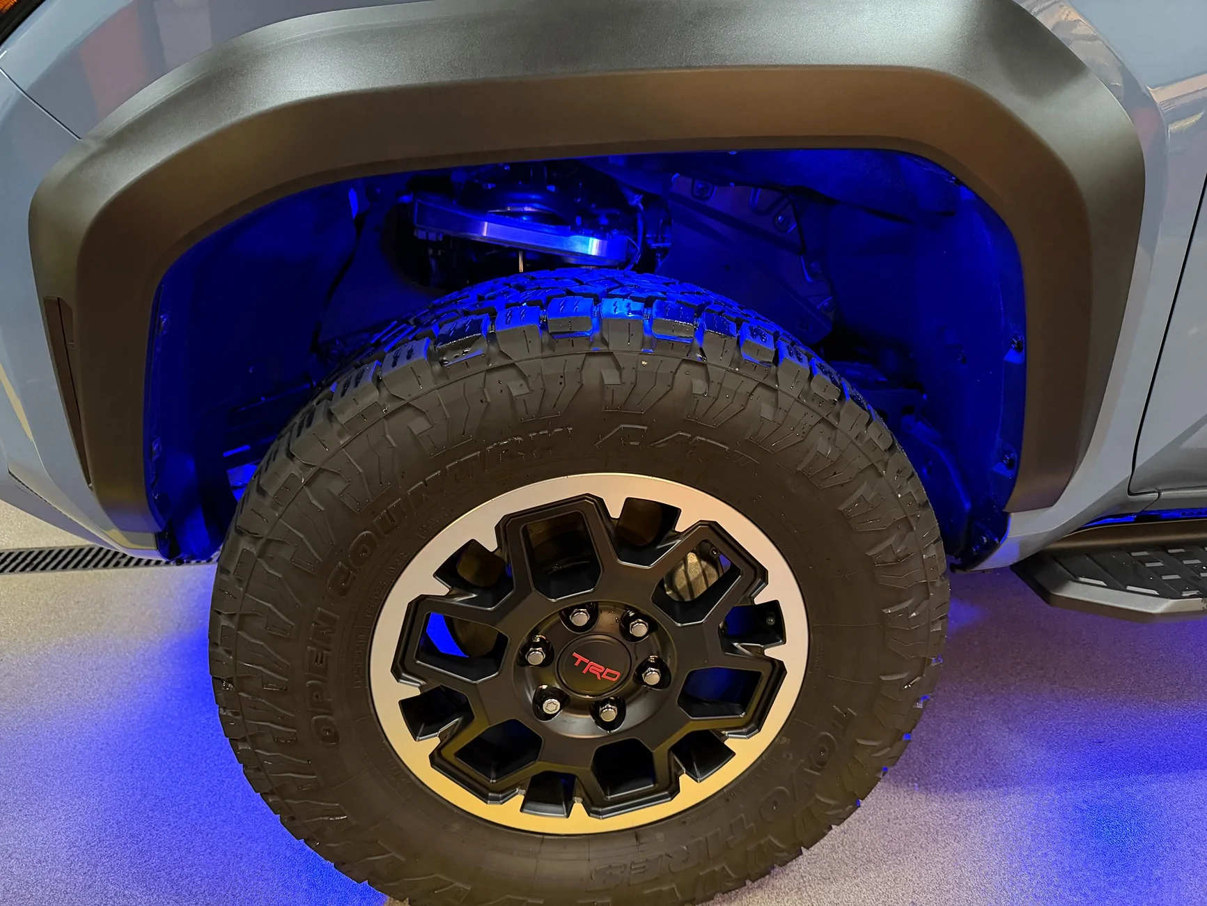

Finally got the Dobinsons UCAs installed. Going in for an alignment on Monday. If you order the Westcott billet top hats, be sure they are the torqued sufficiently and there is no rattle. The guy doing my install didn't tighten then all the way due to Westcott not providing torque specs. After the intial install there was a rattle so he had to go back in, disassemble everything and figure out what was rattling.
