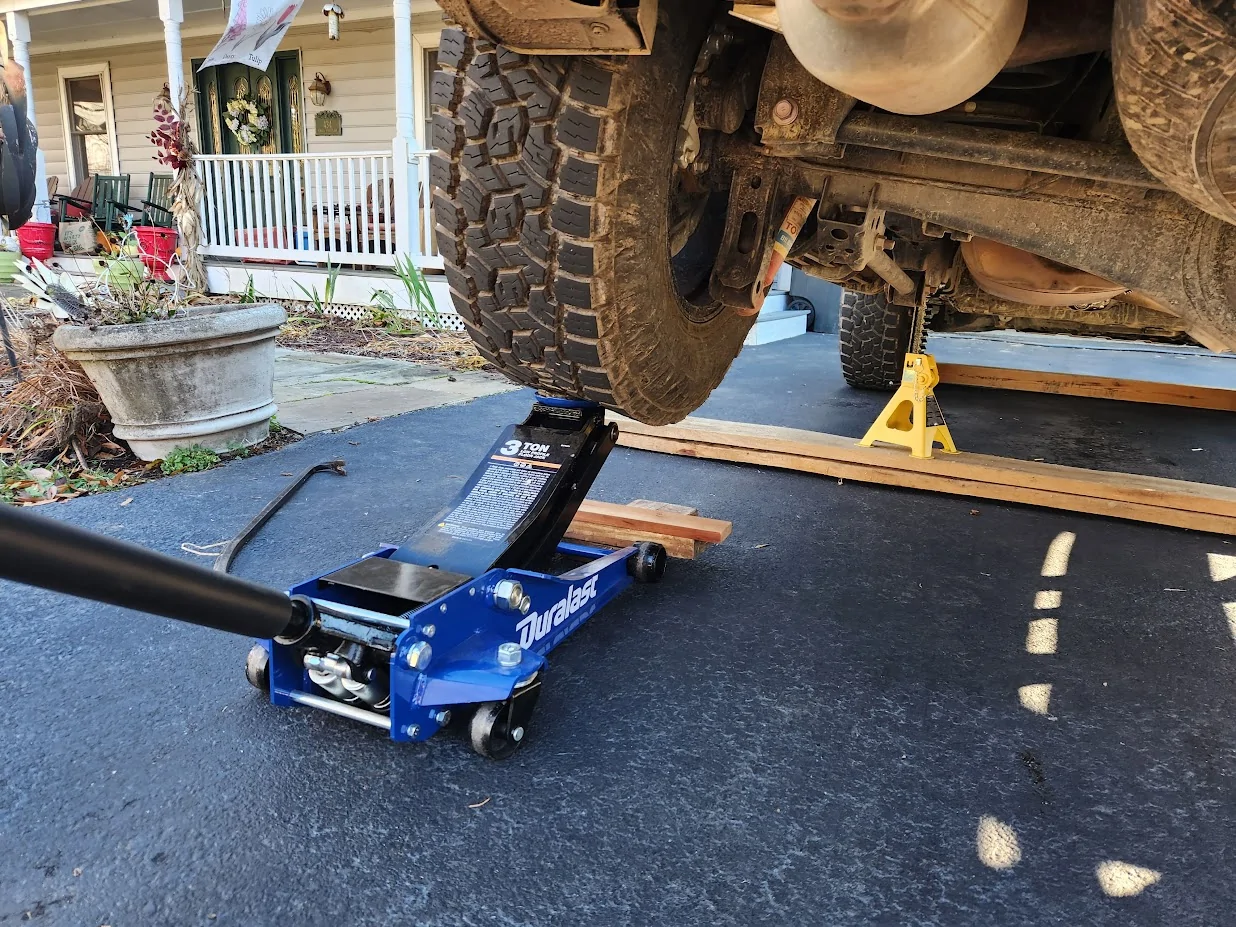

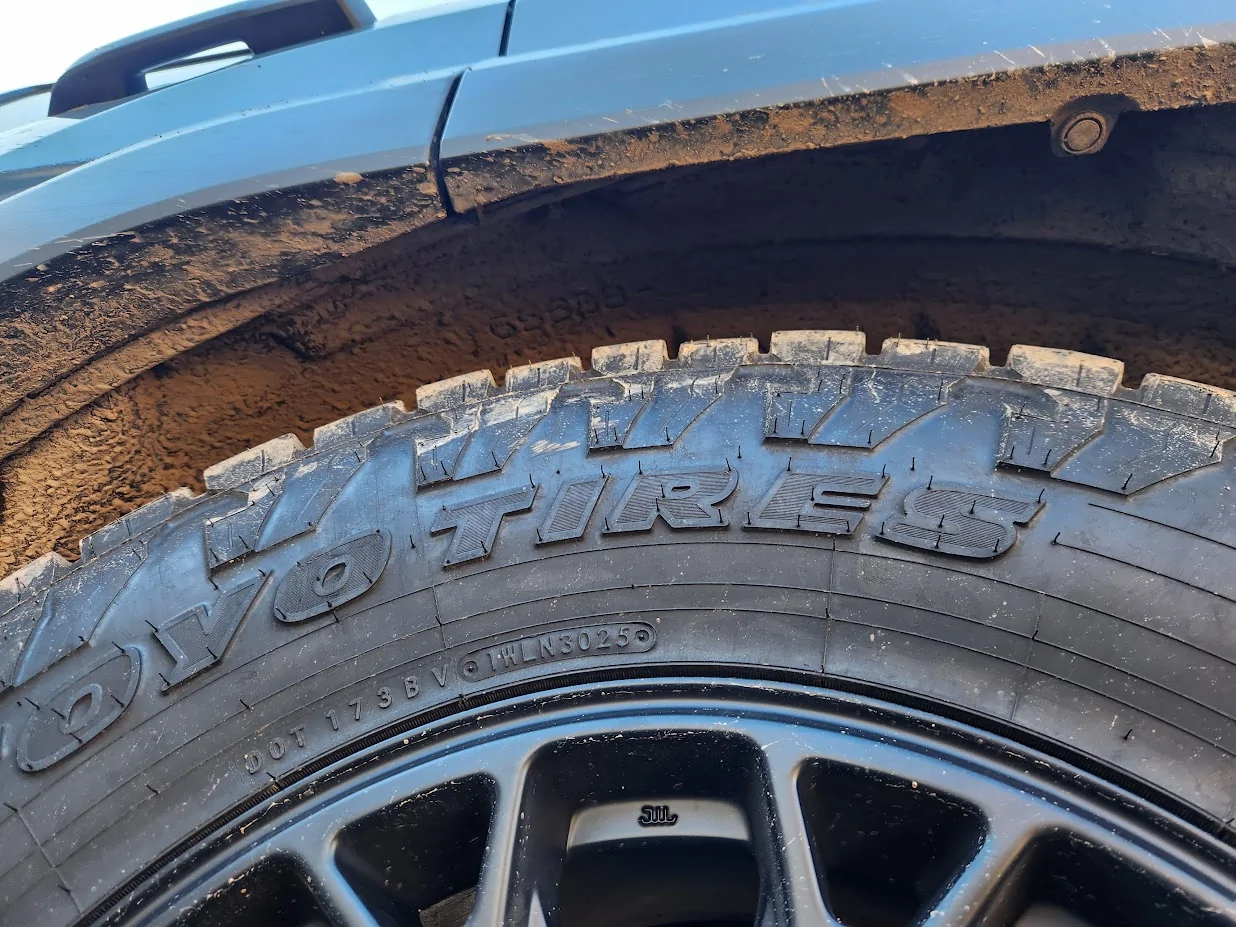

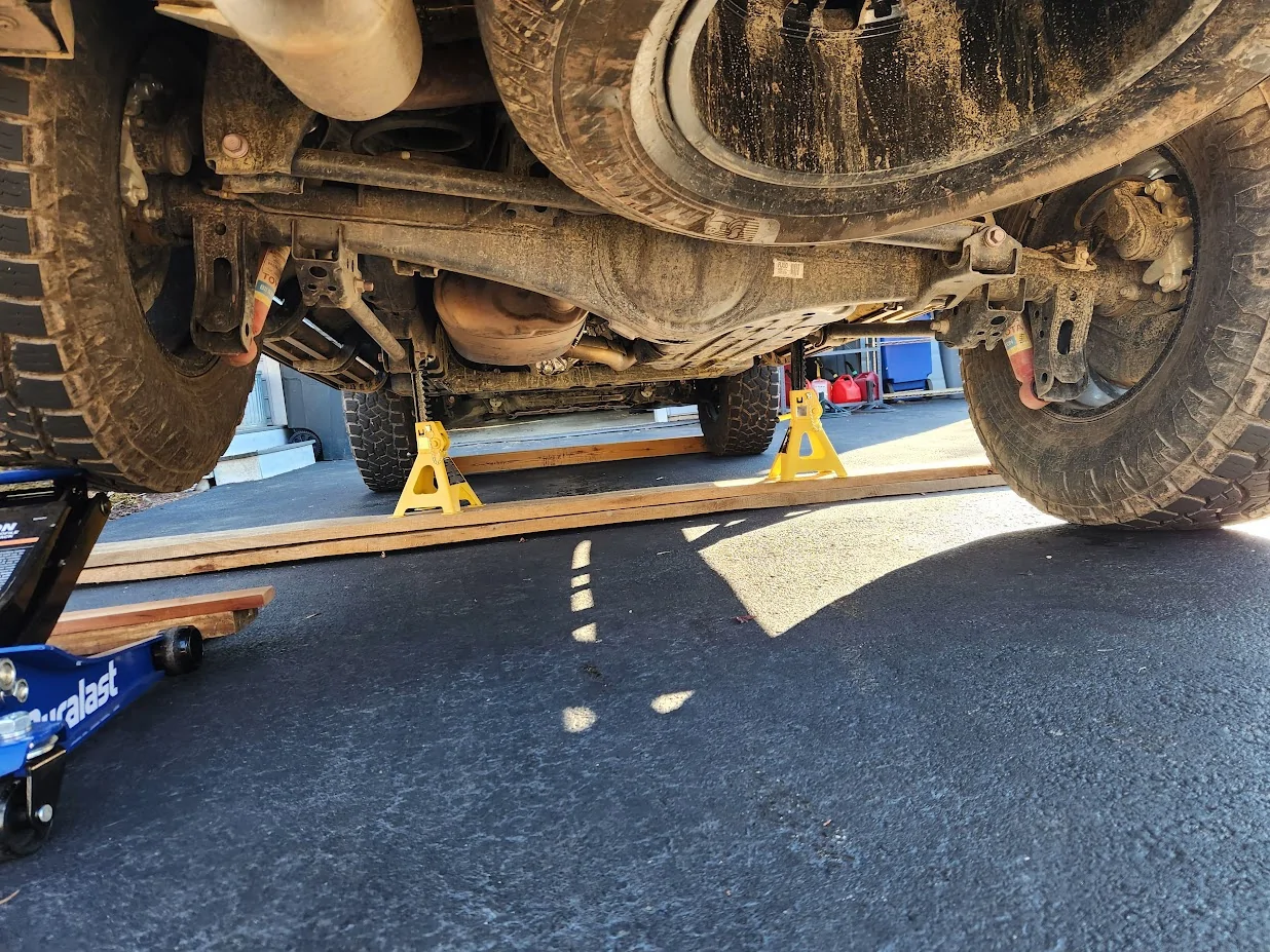

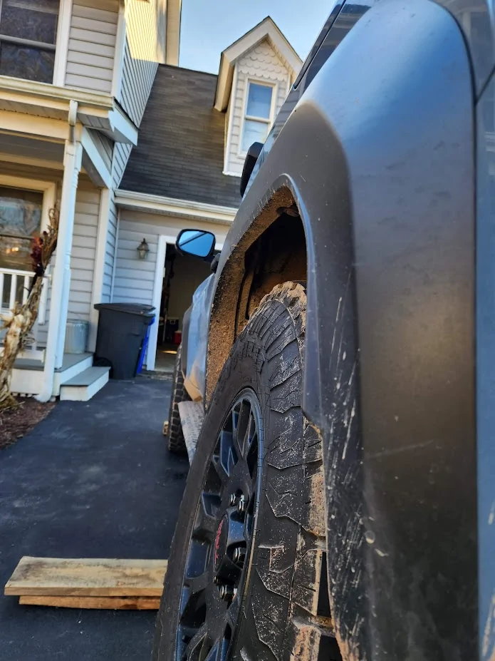

Here is my test to convince myself that I had fixed the rub by moving to the +45 offset wheels (I couldn't quite get this set up to full articulation but the angles and apparent clearance convinced me I had fixed the problem):

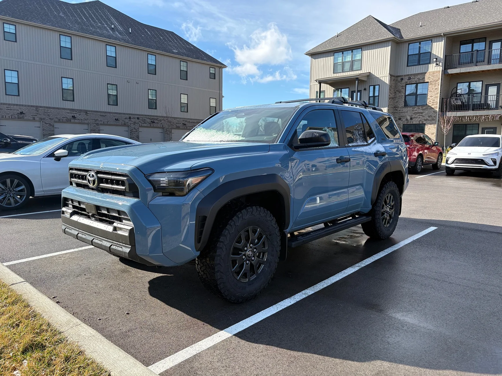

Thanks, all, for your suggestions! I had a set of KO2s put on yesterday in 285/70r17 and they look incredible. No rub or any other issues.
