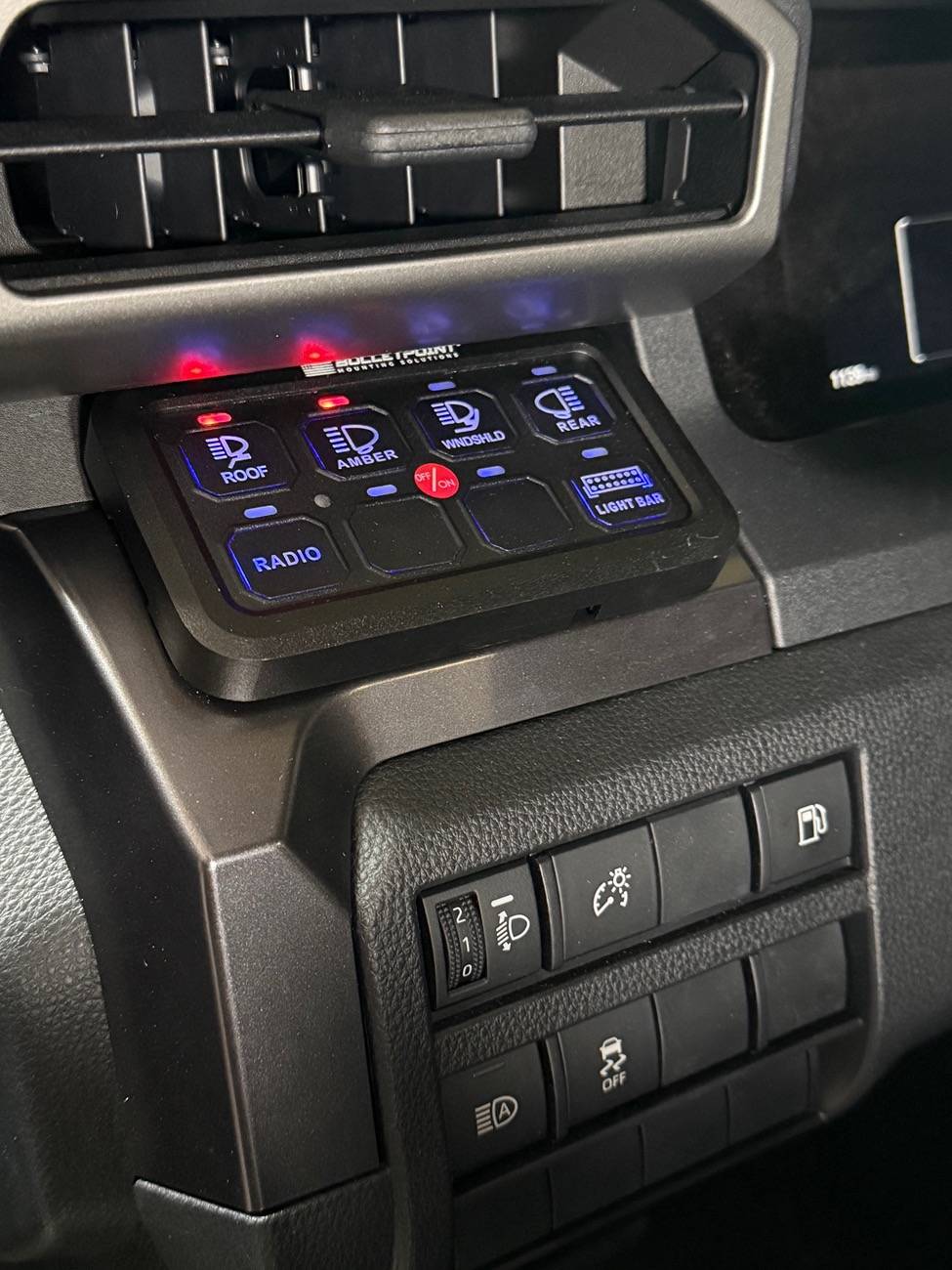

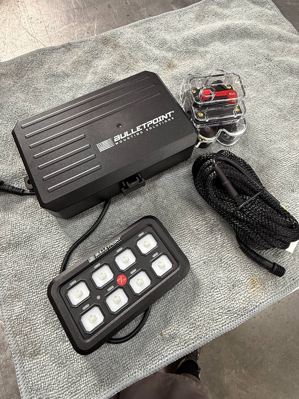

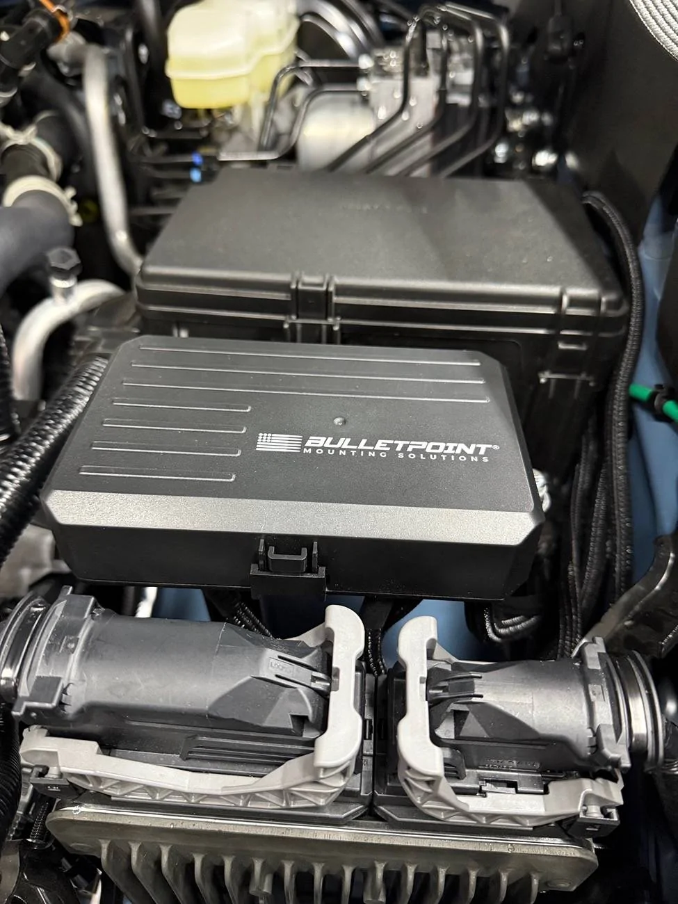

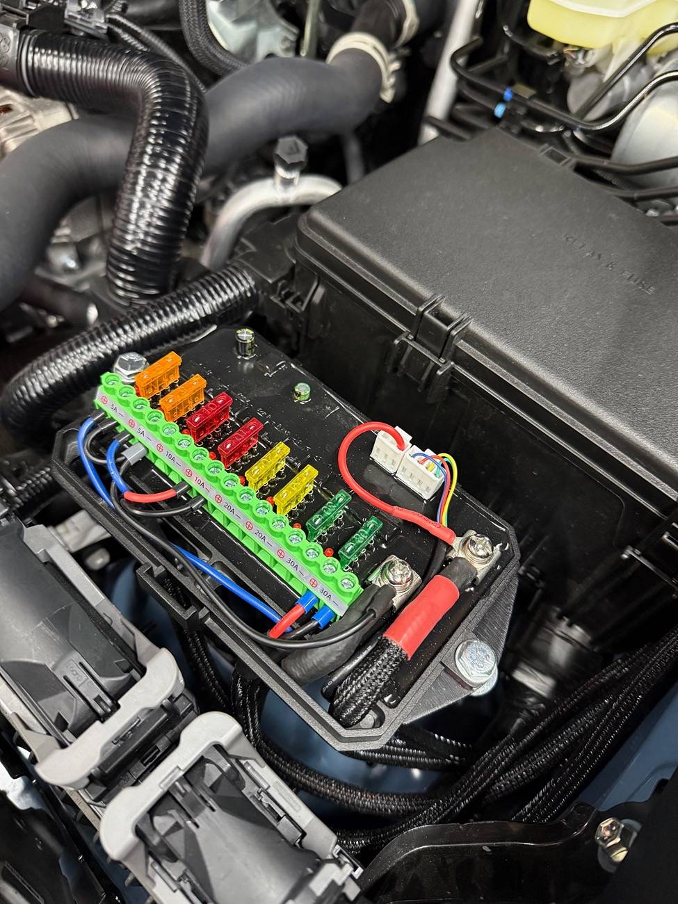

Installed many of these into a wide range of builds, yes you can add some factory switches, but these are way cleaner. You only need to run one small wire into the cabin area, all the rest of your acc wiring will be in the engine bay to the solid state relay block. With 80 amps continual , 2 30 amps, 2 20 amp, 2 10 amp , and 2 5 amp slots you can wire about anything directly to them. I custom made a mounting stand for it between the abs and fuse panel on the drivers side of the engine bay. Mounted the controller above the factory switch locations on the drivers side of the dash. The wiring I ran through the factory grommet with the stock wiring.

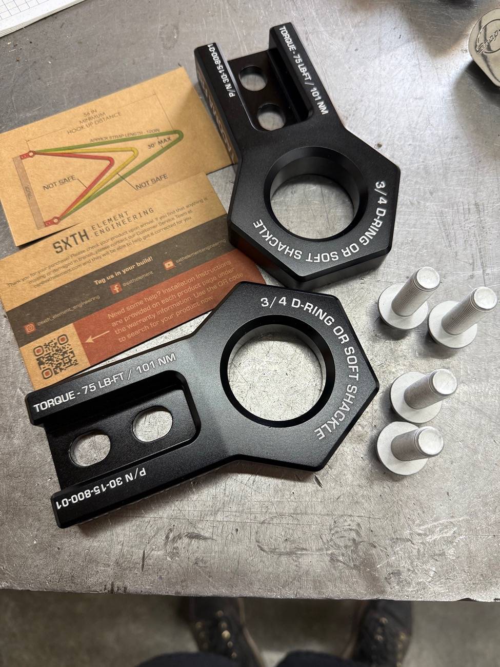

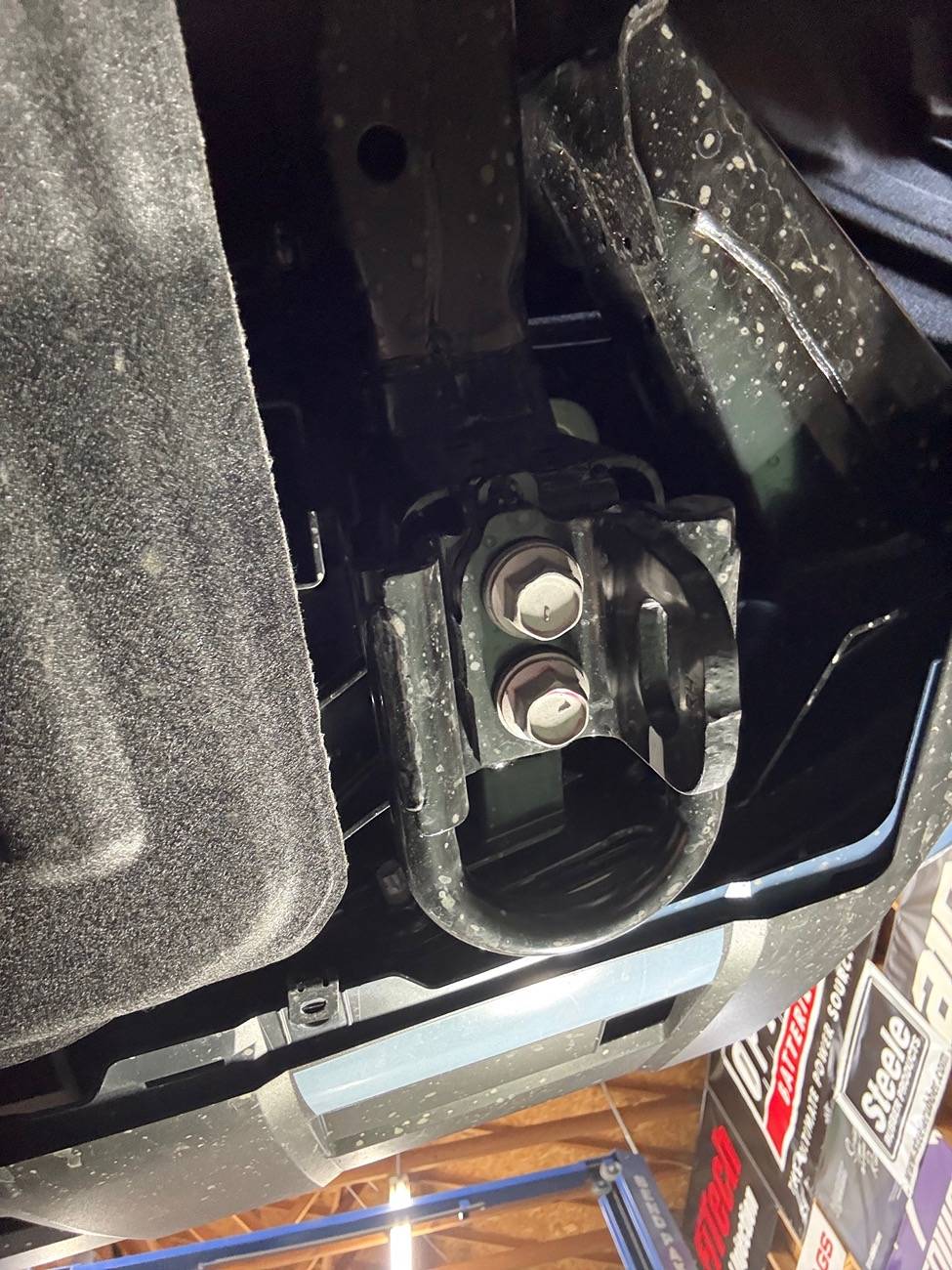

Installed some of etc SXTH element lower billet recovery hooks in black anodized and they look so much better the next stock!
These share the same fitment for the Tacoma. Its a simple 2 bolt swap, take out the stock units, bolts these in ,and have the confidence knowing if you need too, you have a solid recovery point now, and will look way cooler doing so!
