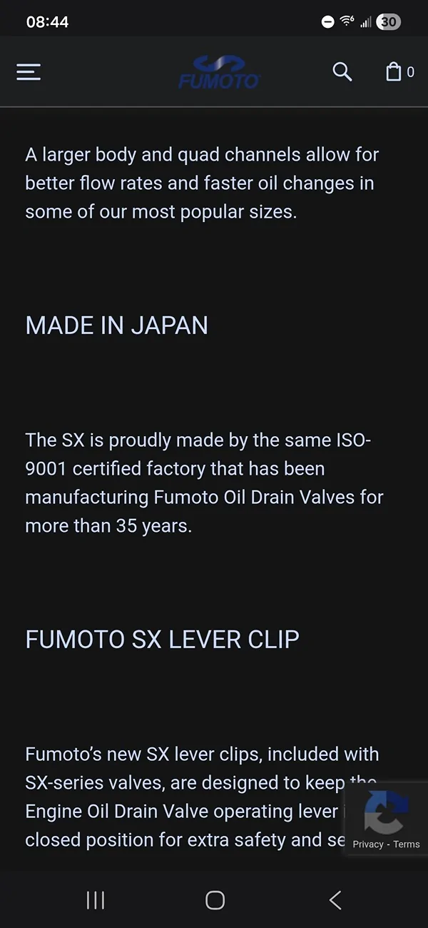

Recently ordered this valve from Amazon, as it said it would fit my 2025 4Runner. It was the F103SX, and it includes a quarter inch nipple for a rubber hose. I could not get it to fit as it seemed it was too big for my oil pan drain hole. Sent it back for a refund. Got on Fumoto’s Website, and dang if it didn’t say the same thing, the one that I had. Makes zero sense. Has anyone ordered this valve and successfully installed it? If so, please tell me the model number. I do want the 1/4” nipple though. Called Fumoto twice, left messages, but no response. Thanks guys!
