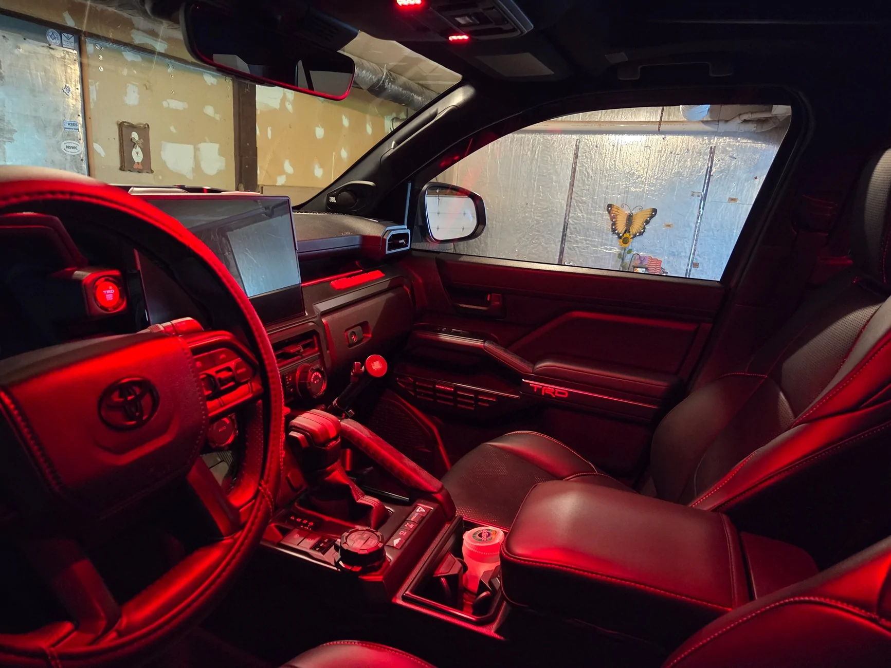

Meso Customs map and dome LED's
2025 2026 4runner 6th gen Fixing the Dim Interior Lights on the 6th Gen Toyota 4Runner 20260515_142544
are worth a look. Bright white or switch to red. Easy install.

The Meso Customs map and dome dual color lights are bright but not too bright. The red is easy on the eyes I keep them on red all the time. Changing to white is just a push of a button and are much brighter than stock. The map lights do require drilling of the overhead console assembly which is completely hidden after you reassemble it. The removal if the console is a bit difficult so if you do it just be careful. The dome light just requires removal of the center circuit board but it's simple to remove. There are videos on YouTube on DIY.
