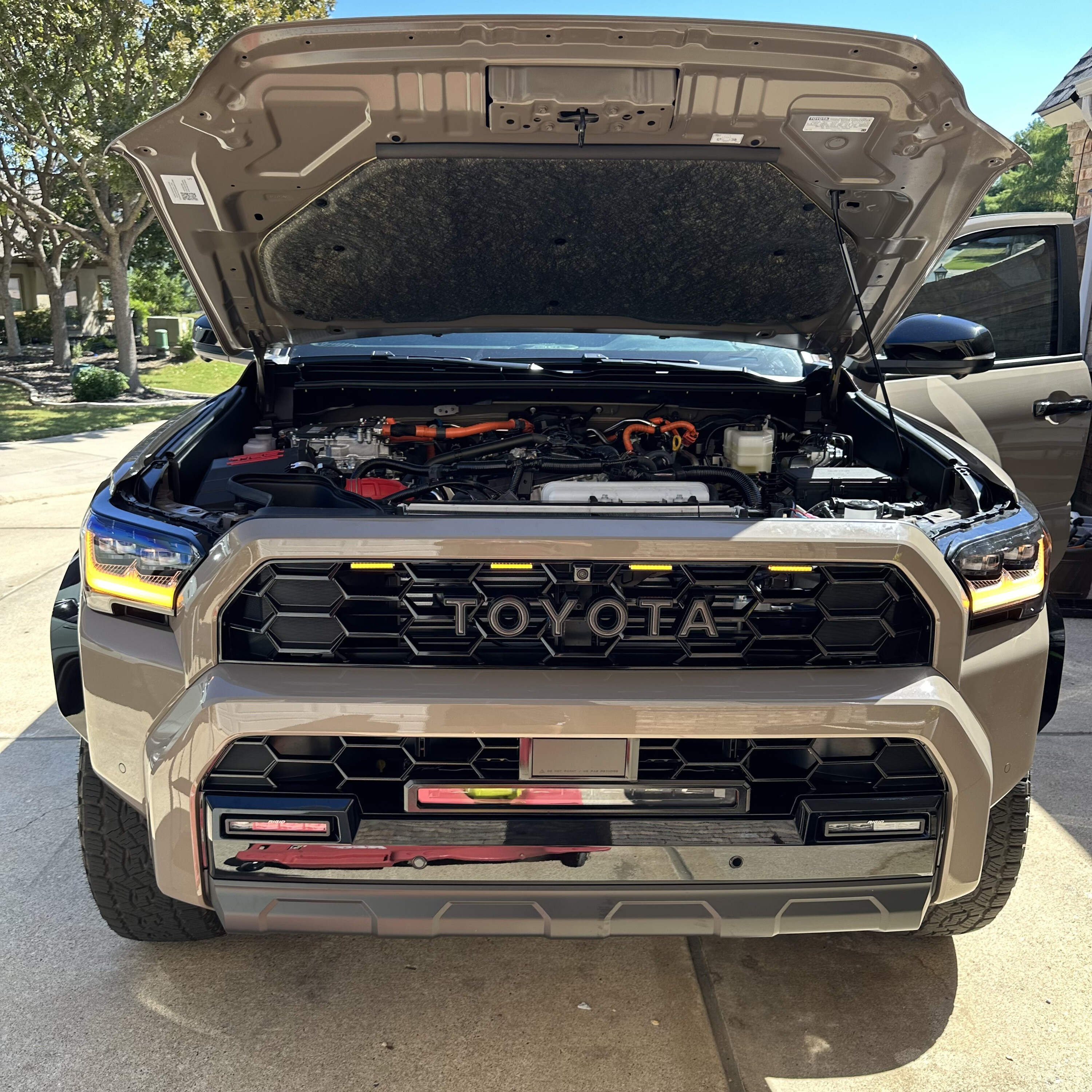

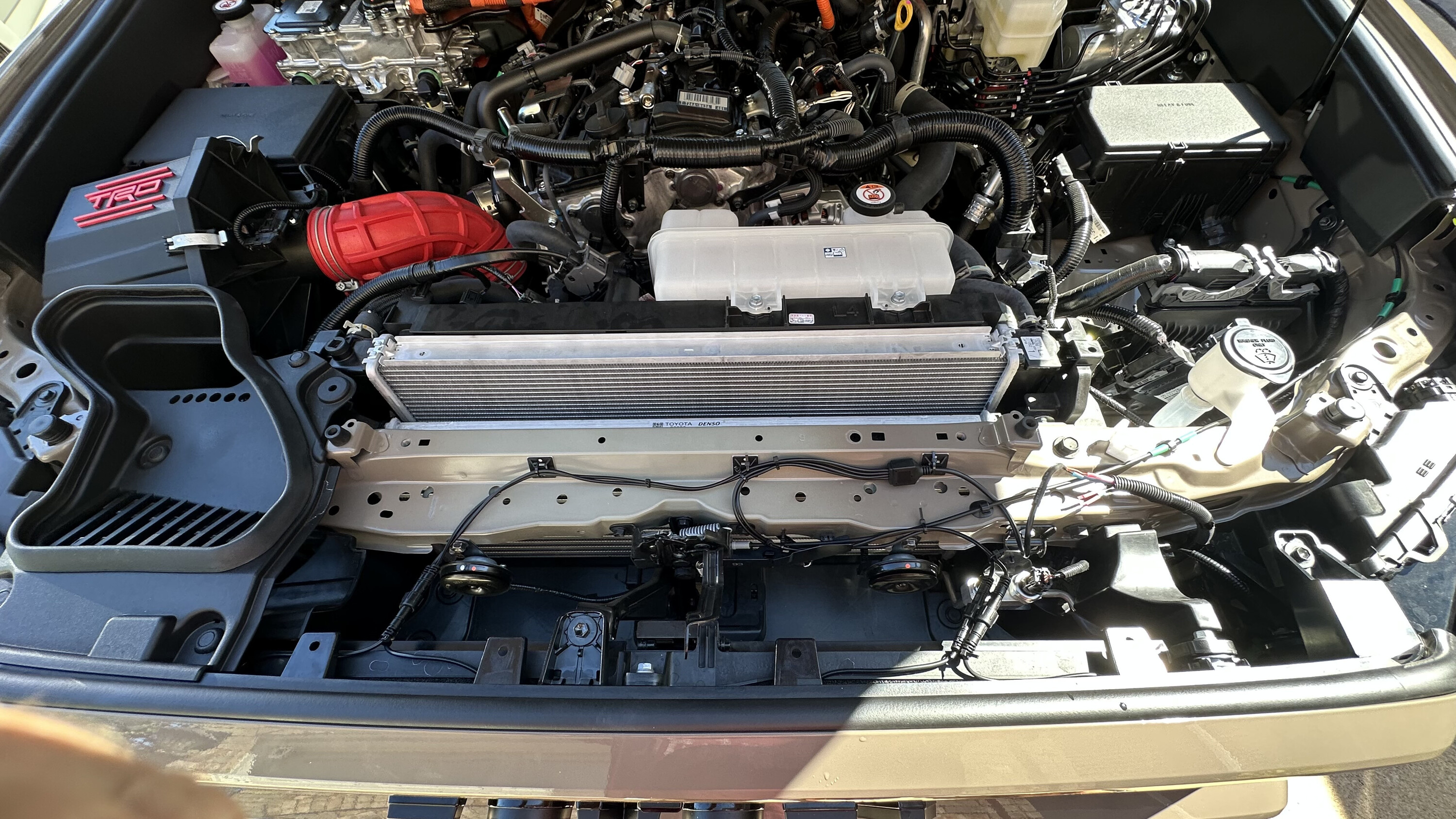

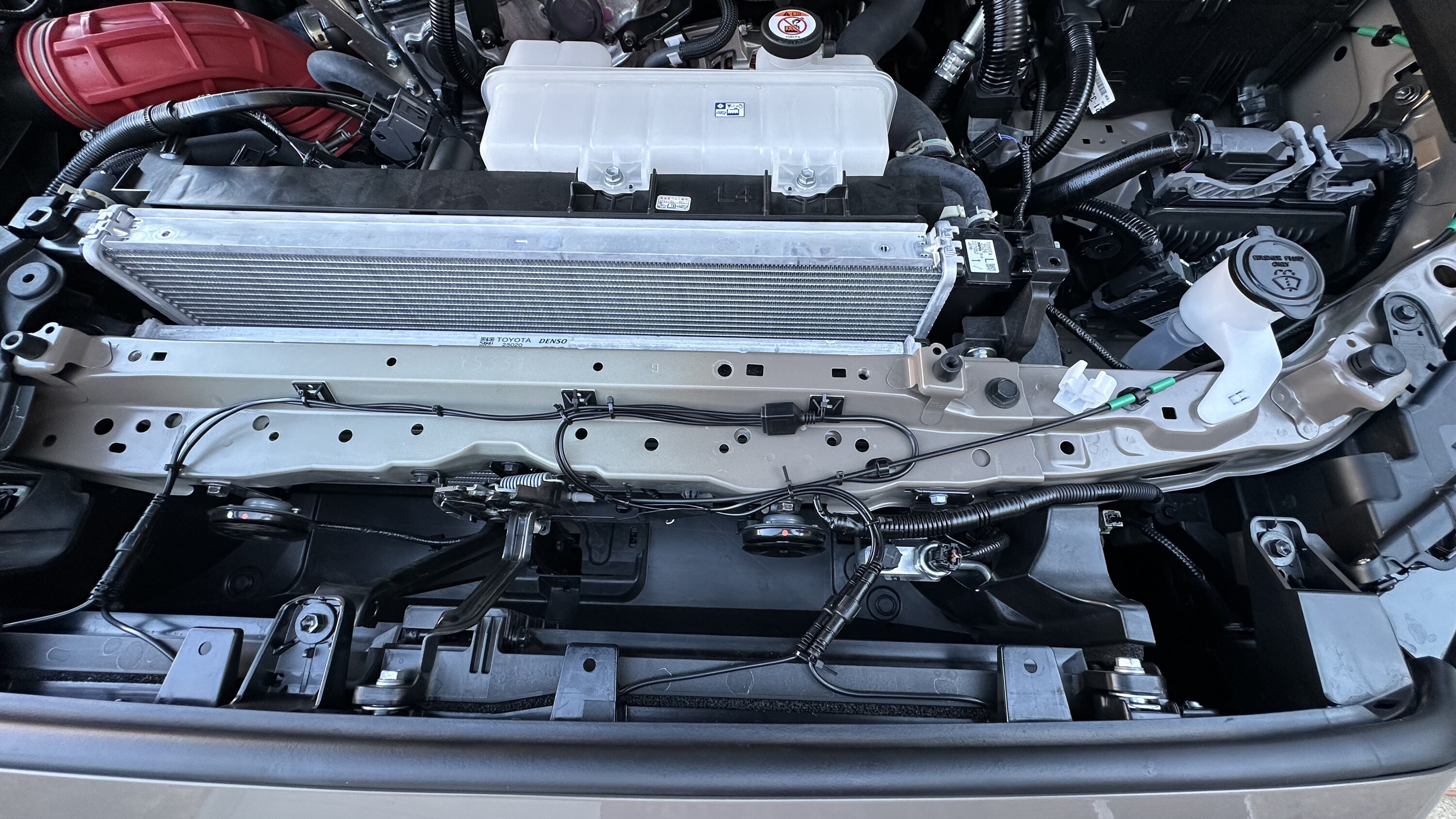

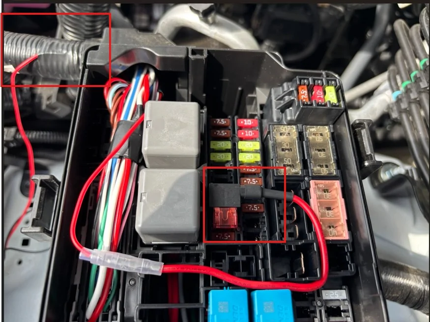

Here's the install video to help clear up fuse placement.
Any issues with these turning on at random times of the day? I park mine at work and get alot of people with proof that they’re on while off and parked. Any suggestions? Followed your video same place for fuse tap. Any help appreciated.
Yes they pop on for bout 45 secs as the system resets itself, which is totally normal. They do not stay on for a long time. There’s nothing to worry about or worrying about battery drainage.

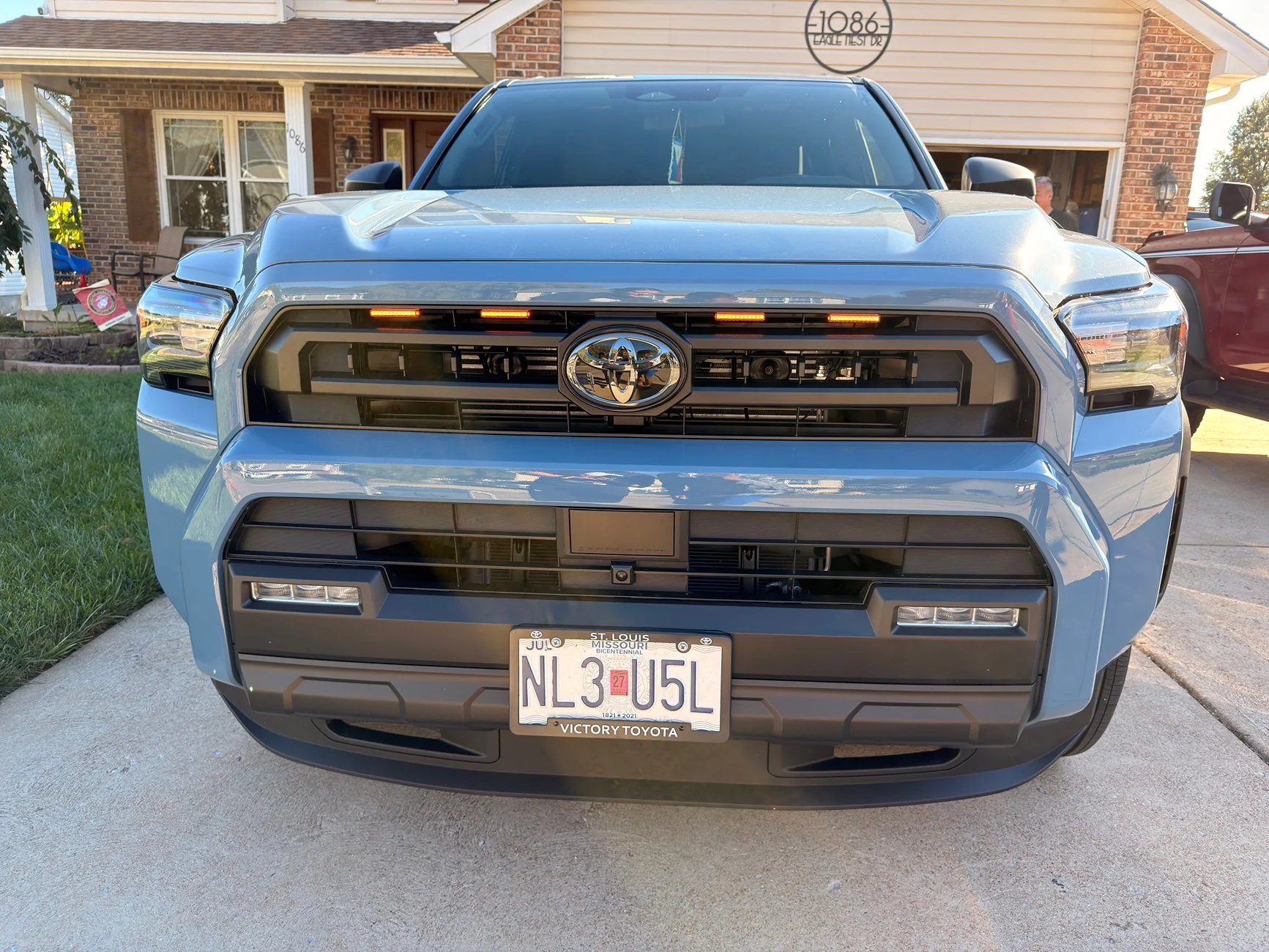

First little mod. Installed those amazon lights using the white always hot on ignition and the ground in the front pigtail. Waiting on some plastic conduit show up on the doorstep to clean up the transition to the pigtail, then gonna button everything up.

Hell yeah bought the same kit can’t wait to install them.

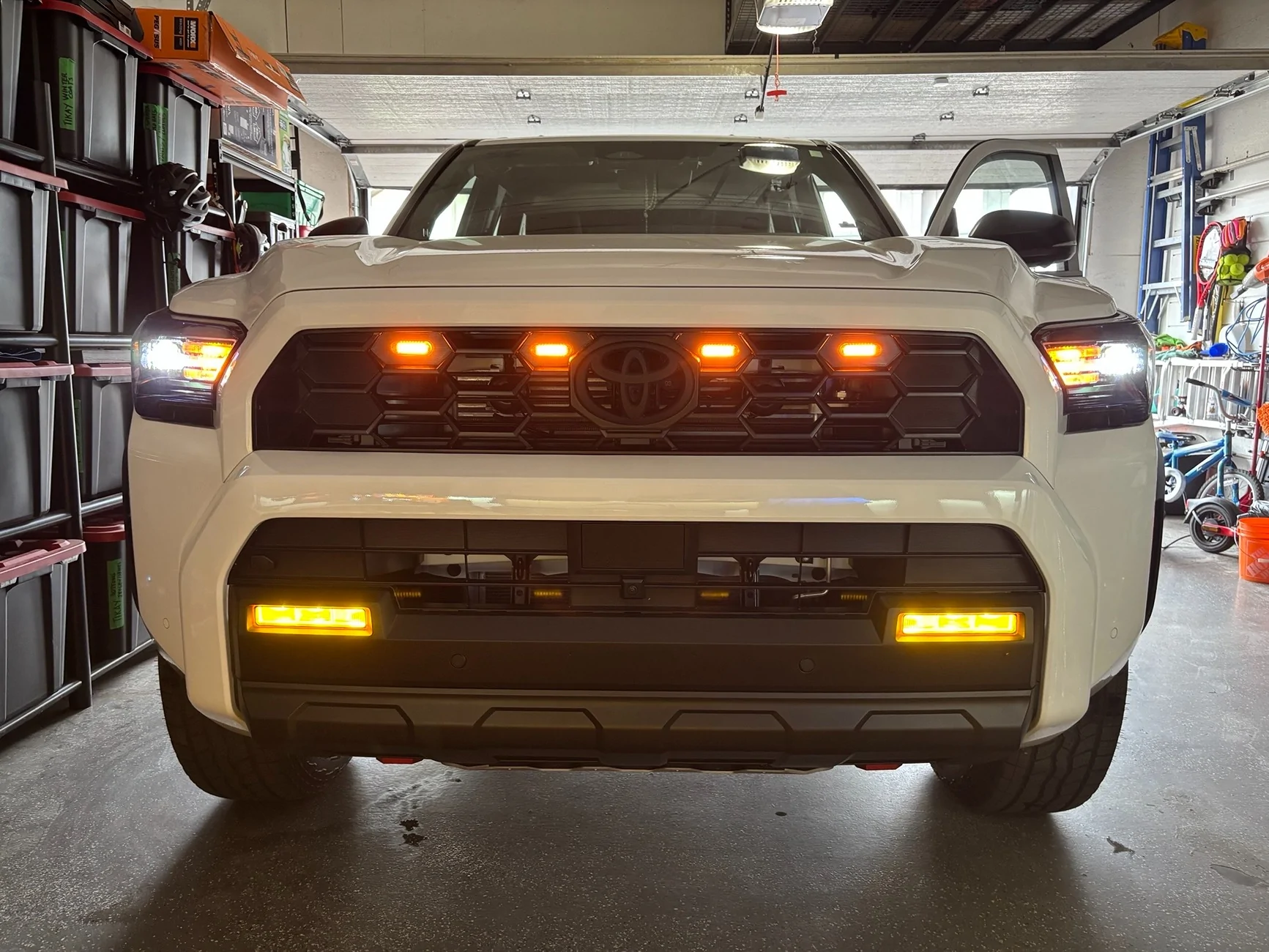

Cleaning up the transition. All buttoned up now.
So this may be common knowledge for others, but first time dealing with the plastic rivets that hold the plastic panel in place. Took the first one out with little screwdriver before I realized the error of my ways. They are three position rivets. Just press the button to release the rivet. When reinstalling push the little "rod" against something hard until it pops out all the way. When you reinstall, just press the button back to the original flush position. If you press it too far, it will unfasten again.

Anyone else noticing that these lights seems to run really hot for LEDs? Like hot af.
