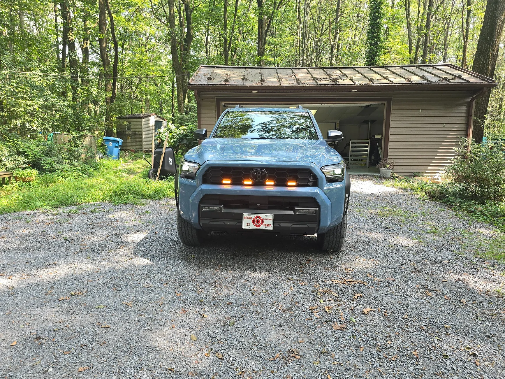

I completely install them so hopefully they will return them after I take them out. This is my first 4Runner and this is my first time doing any type of work on any vehicle. They look really good in my neighbor even said the same thing it looks like they're stock. I'm just not happy with the connections. Having a bare wire wrapped around a boat isn't something I'm happy about. Also I had to go by butt connectors I didn't install them yet I was going to work on that this weekend. I think I'll take this as a learning experience and pull them out. The only issue now is that I have a slot dremeled into the side of my fuse box. I wonder if her fuse box extender would cover that hole up? Have you seen one for the 6th gen 4Runner yet I know they have them for the 5th?. It's not that much a good deal cuz you can't see it with the fuse box lid on. Thanks for your reply like you said they just aren't designed wel. I spent a lot of money buying different connectors and trying different things to get this to work so it's a lesson learned. I don't think I'm going to go with the stickers like you have just because my OCD would drive me crazy not having them perfectly lined up perfectly. I don't even mind them being loose because they fit in uniform. My biggest issue is the connections.
I had the same initial thought about the Amazon ones being mounted with 3M tape. They’re actually perfect and they are absolutely uniform if you mount them correctly. So don’t worry about that at all. Plus they come with three different fuses as you see in my video. No reason or need to buy anything else to install them. The Hansshow ones clip in, are loose and will rattle. Plus the design of their housings do not match the design of the grill. It’s up to you, but they won’t last you long. Also, there isn’t a fuse box extender for the 6th gen yet but I’m sure it coming. You don’t need it though.

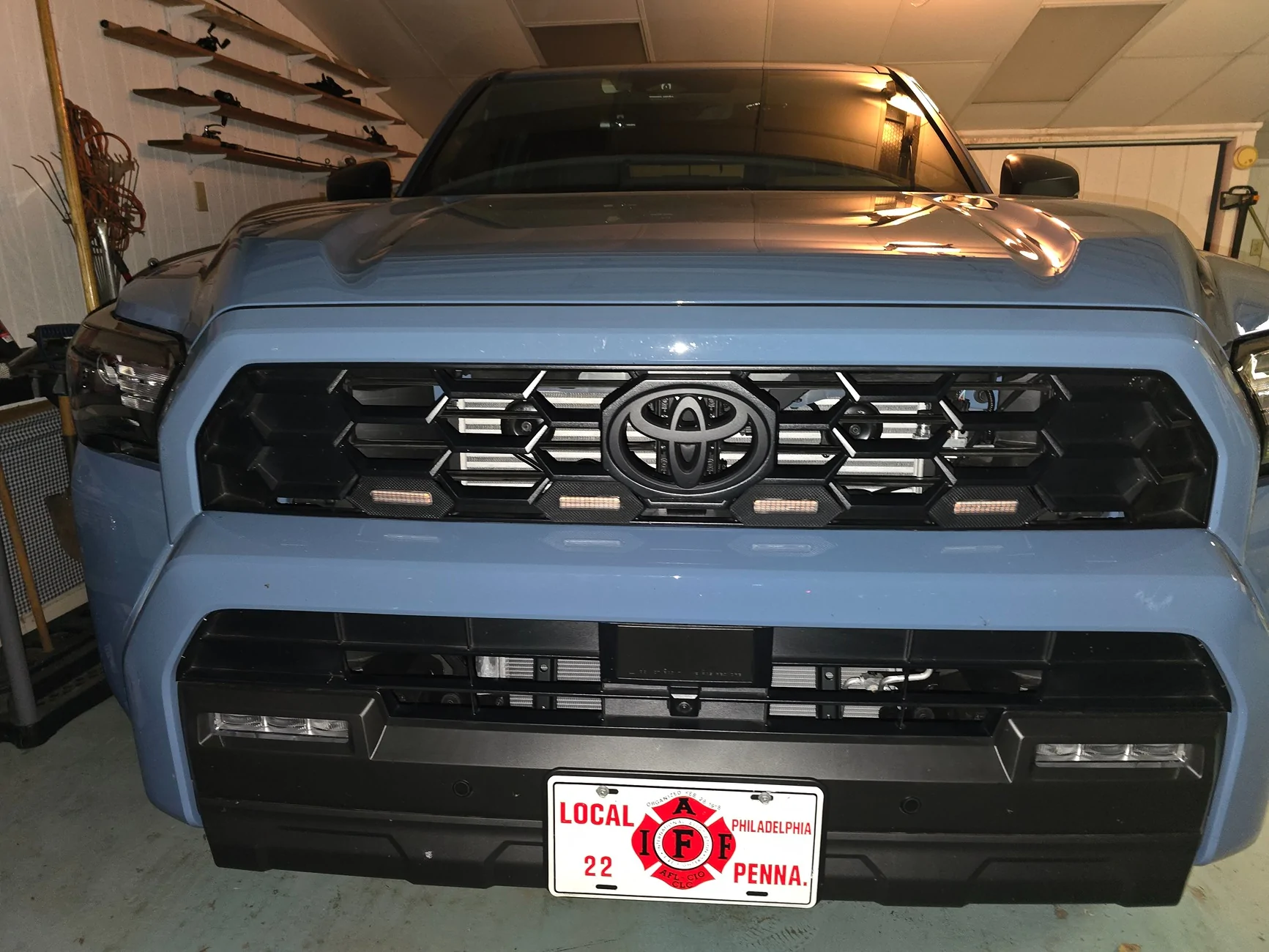

I just responded on your video but I figured I would ask here since you're pretty quick to get back to me. I'm really up in the air and trying to decide if I should return these things or just try to buy some connectors and make it a better connection. Where exactly did you ground the wire to I could not tell in the video maybe I skipped over it. Did the wire they provide come with an O-ring so it can be mounted to a bolt correctly or was it bare wire like the one that I received from the other company. Also how did you make the connection to the jumper fuse the ones I received I need to buy another male connector because all it was was a bare wire. I ended up modding it just to see if it'll work before I go out there and buy the right connectors. I'm really debating if I want to take all this off and start over again but I might have to do that I'm going to wait to hear back from the company though. This is my first time doing any mods so basically I'm learning as I go and learning lessons as well. I mean I'm only out like 70 bucks and a hole in my fuse box 🤣. I really appreciate the feedback still trying to make my decision. You see what you're saying it doesn't look as uniform as yours I'll probably get the one you got.

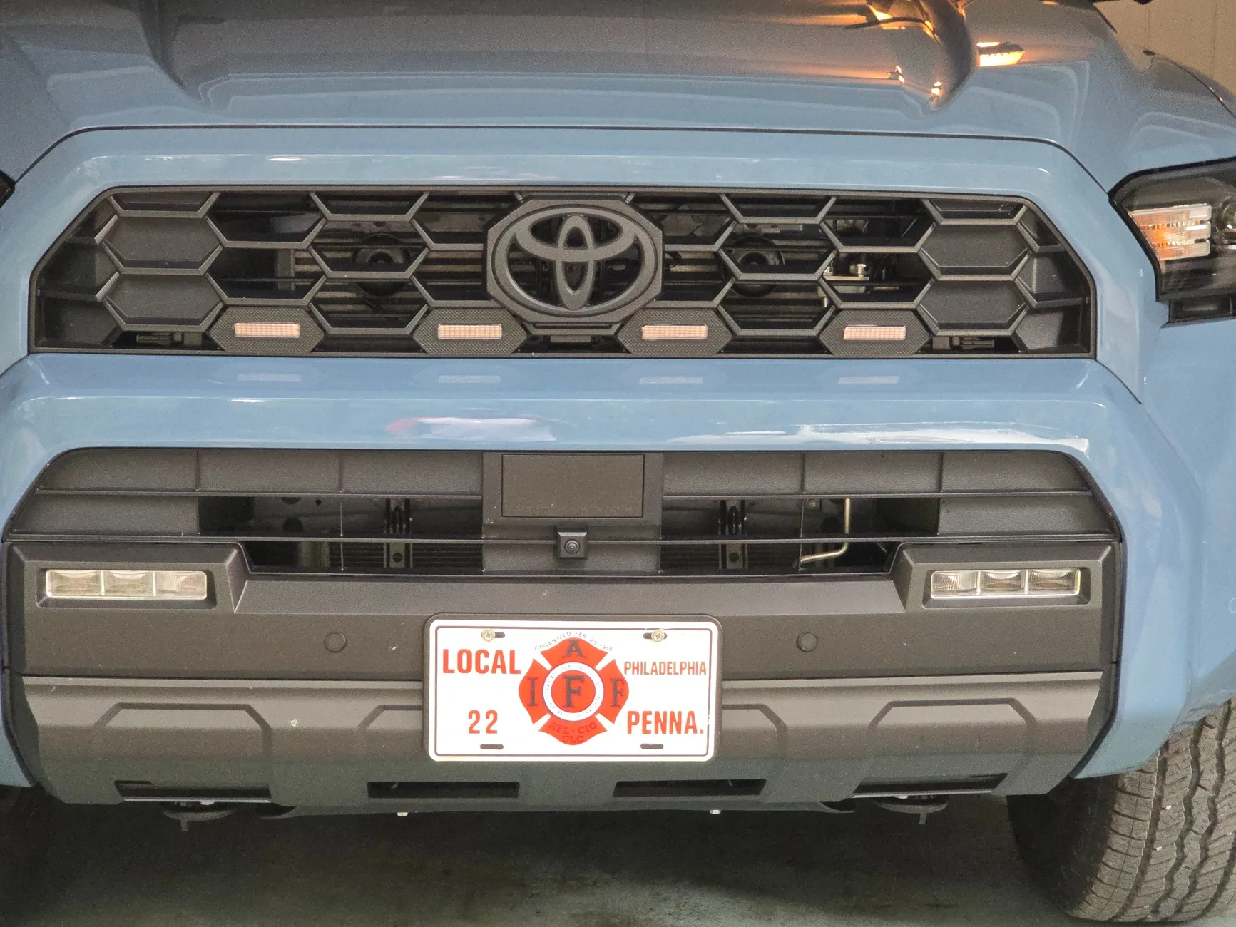

I also noticed you the hybrid which looks l to be a different Grill than we have on the TRD off-road premium. I'll take some measurements to see if I can get those stickers to line up evenly. I'm waiting to see if this company responds. I think I noticed you also purchased the door logo lights? If so how did they work out?
Flexte
Jul 30, 2025
80
PENNSYLVANIA
2025 4runner TRD OR Premium
So here's another picture without the Flash. Like I said I still wouldn't purchase them but if you're just walking up on them they look like they belong there are they fit right in. Even my neighbor said they look like they're stuck. Unfortunately with the problems with the install and the horrible customer support I definitely would stay away from the products until they fix those issues
