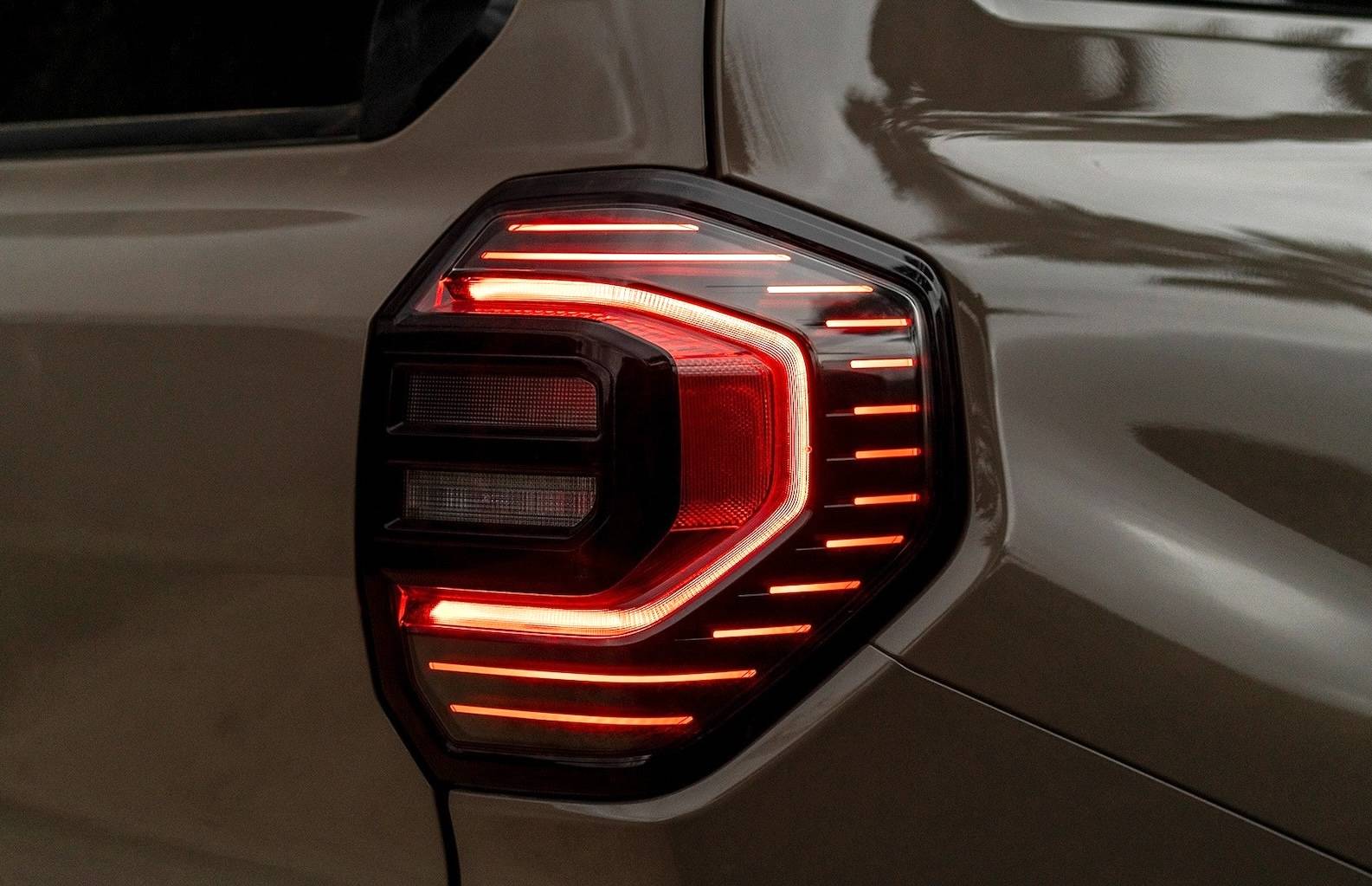

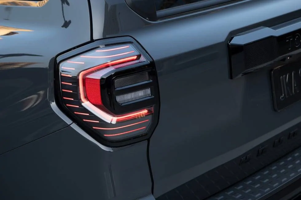

Ugly! 🤮 I think the OEM smoked black ones from Sport & Pro are much better.

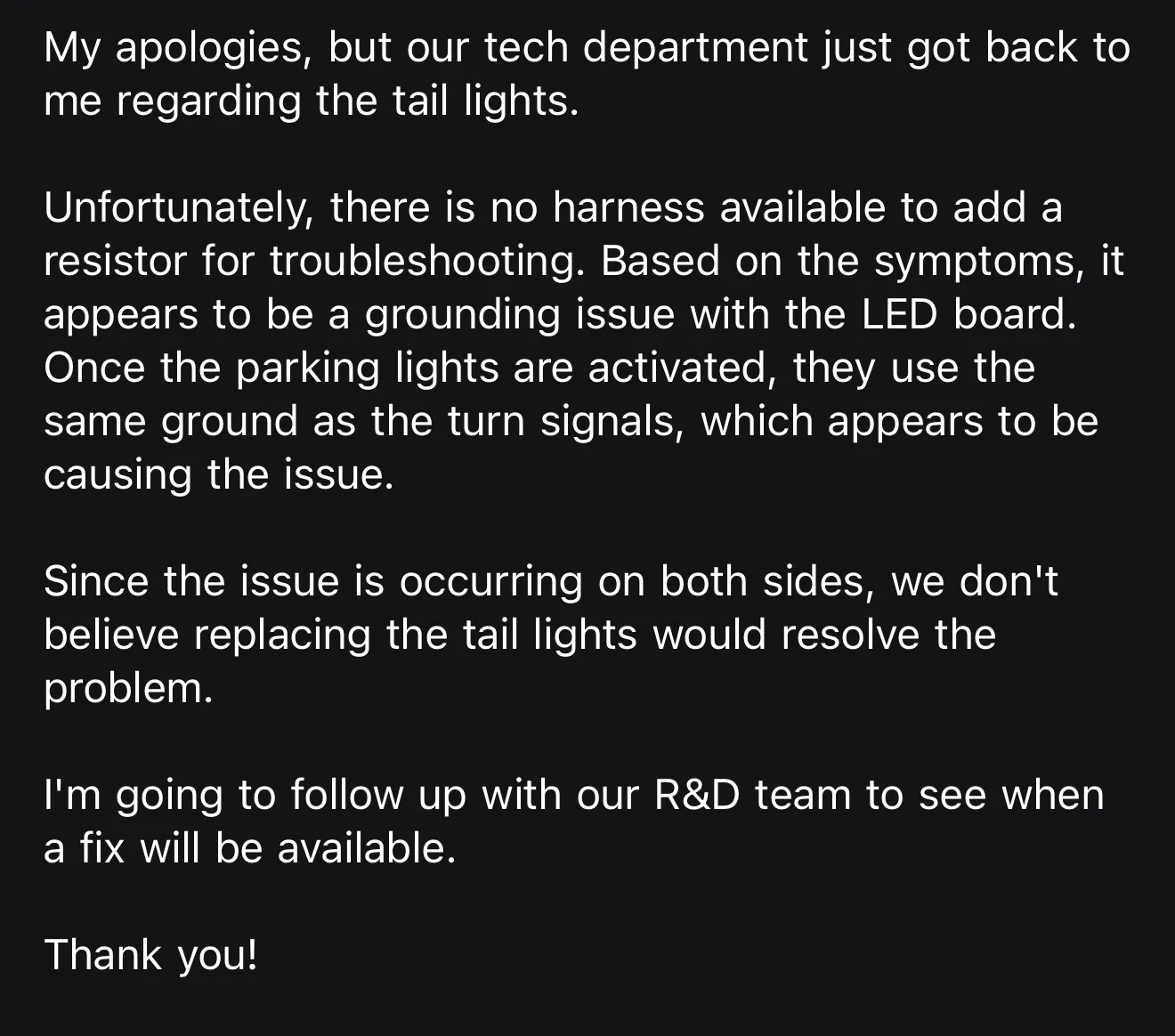

I put up an IG reel criticizing the problem with the tail light and - to their credit - Alpharex DM’d me immediately.

You hit it spot on. Who knows how long R&D may take if this has been an existing issue
I’ve been back and forth with their tech support person. She said they have a pigtail in process that seems to be solving the issue but they need a bit more time. It would sit between the two connectors.

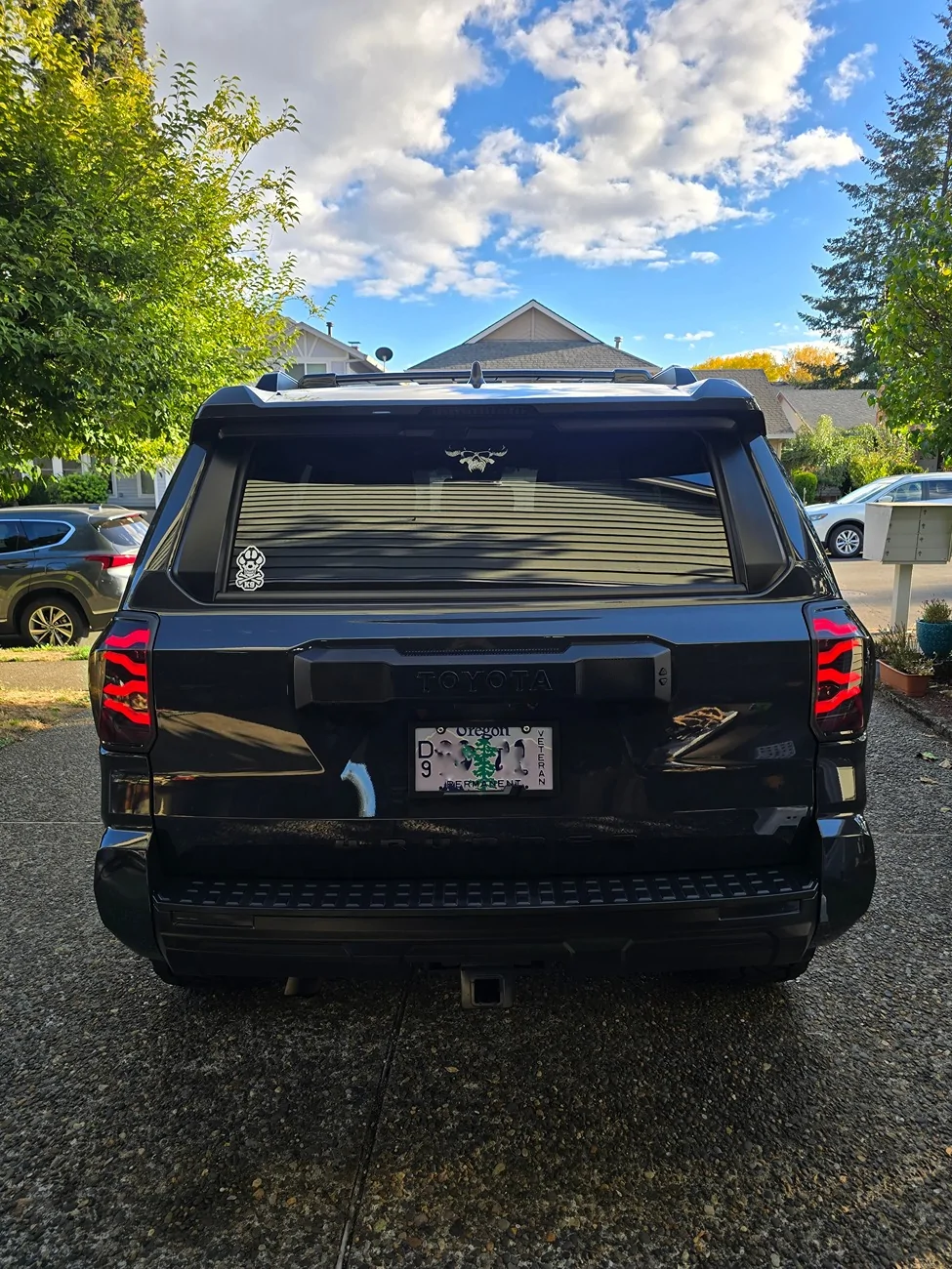

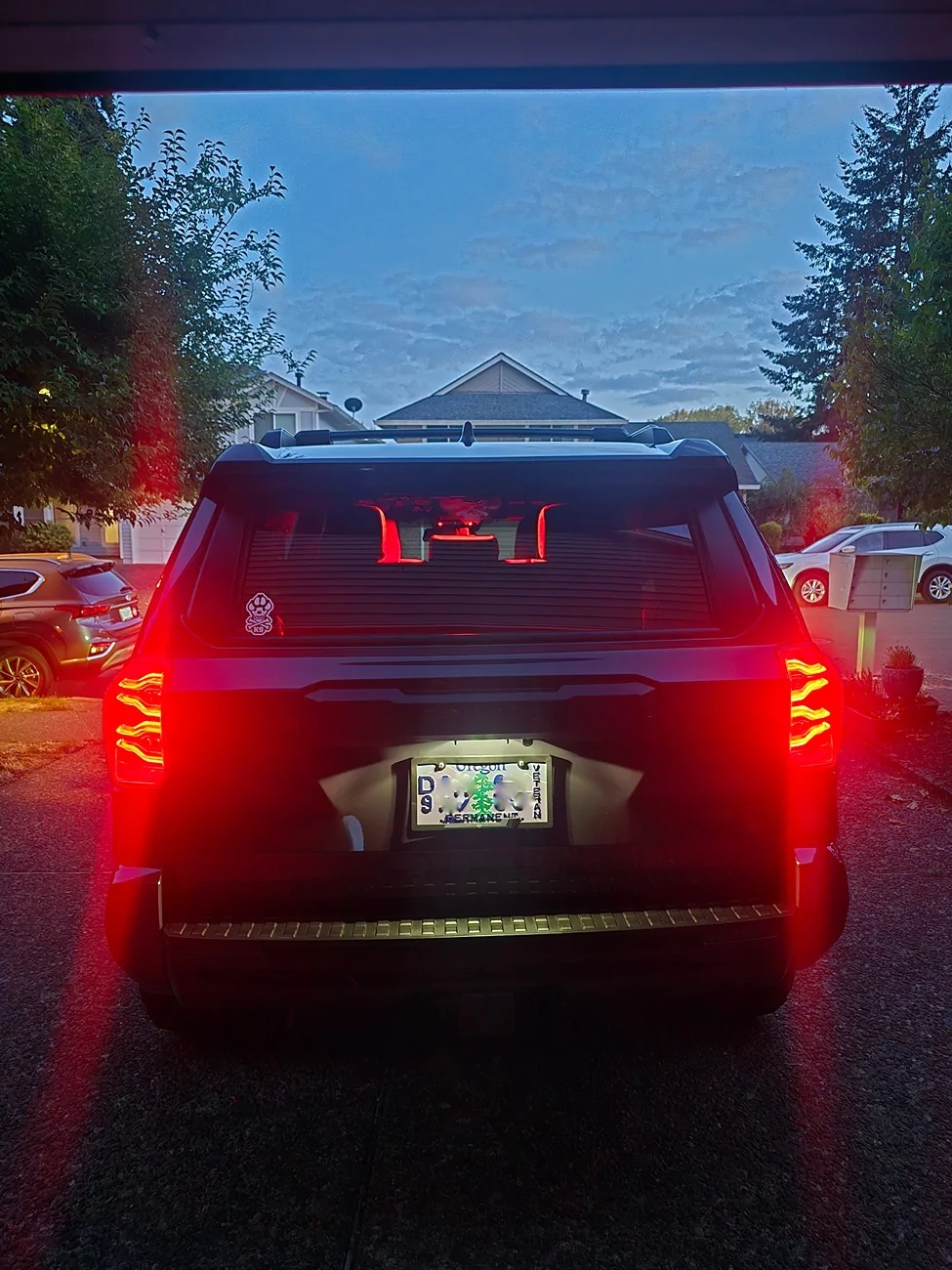

Just installed my Luxx smoke tail lights. No complaints! These are definitely worth the money. Only issue I had was not making sure the prongs were aligned correctly when I plugged them into the single connector. Once aligned, there is an audible click when you plug them in correctly.

I've been working with Alpharex and they got a T-Tap Resistor kit that I just installed today. Everything seems to be working now. If you want, DM me and I can forward any information to help get started on this for you.

I have a tech rep there I’ve been working with. I will bring it up with her. Thanks.
