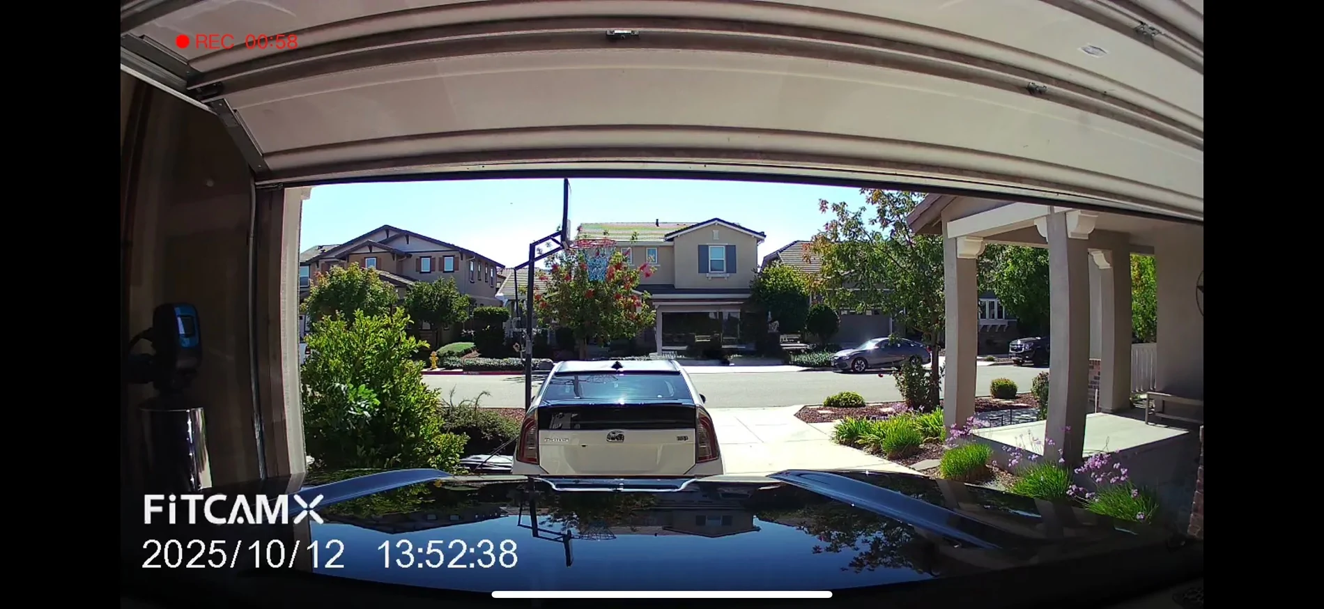

Thanks for the tips. That's exactly what happened . The bezel partially came off and then the console came down with a bit more force.
my problem now is that when connecting to my iPhone, it went into a weird loop with my car Toyota app.
finally I was able to connect the camera. When I open the app, I see the name of my camera but the app asks me to connect to camera
again since the car is on, it goes into a loop with the Toyota connection and app.
are there any settings I'm suppose to apply so it just connects and does not have any conflicts with the Toyota app and other connections in the Runnwr while it's on?
I've had other dash cams and doesn't have this conflict. Weird.
Update:
Only way I get to connect to the FITCAMX is to turn off my cellular data and my Bluetooth.
It works this way per their instructions.
Other than that, if I keep the current settings on my iphone, it's always unsuccessful.

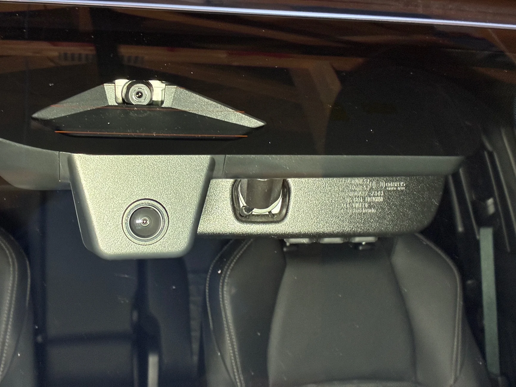

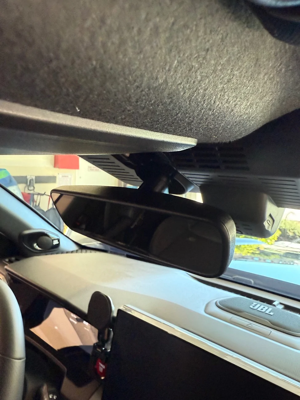

Thanks for the write-up and info! I installed this FitcamX on the weekend, including the rear camera. Other than breaking tabs getting the overhead console down, everything went smoothly and I am very happy with the clean installed look of both cameras.

Did you break tabs on the bezel or the actual housing? I pulled the bezel off trying to get the housing out and broke several of the clips and cracked the bezel. Looked to see if you could buy just the bezel, and could not find it, just the whole overhead panel which was close to $400... But I did find a take off on eBay from a Tacoma for $90 for the whole assembly, so i picked that up, removed that bezel and installed in mine, all good now!
