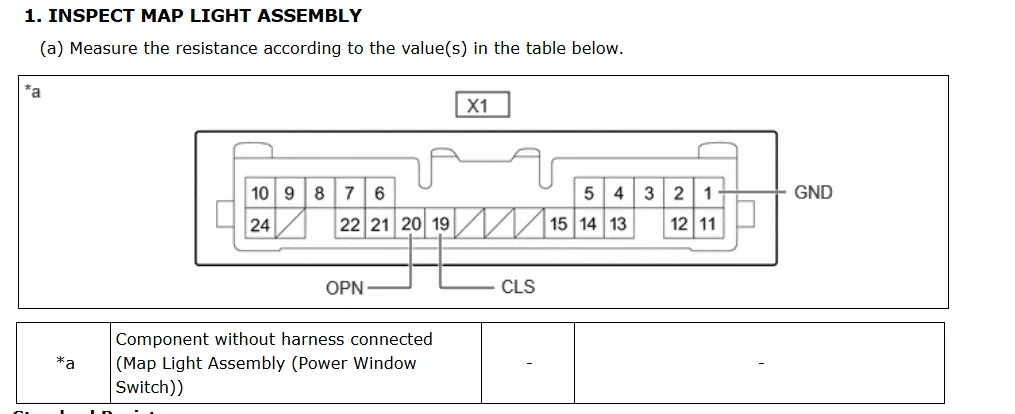

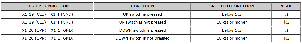

so, the back window switch seems to defy logic. press up to make window
go down, pull down to make window go up.
Well, if you drop the overhead console box the switch is direct connected
to the PCB, so not easy to make a change.
The connector though, is accessible. Anyone brave enough to flip
these pins 20 and 19 and make the switch operate like some of us think it should ?
Pull down, window down, push up, window up.
2025 2026 4runner 6th gen Are you gutsy enough ? Back window switch reversal 1780517045733-60
2025 2026 4runner 6th gen Are you gutsy enough ? Back window switch reversal 1780517264569-mh
NOTE: 20 and 19 are test points, there is no wire there
the actual wires/pins to flip are 22,21
21 sky blue - down
22 pink - up
