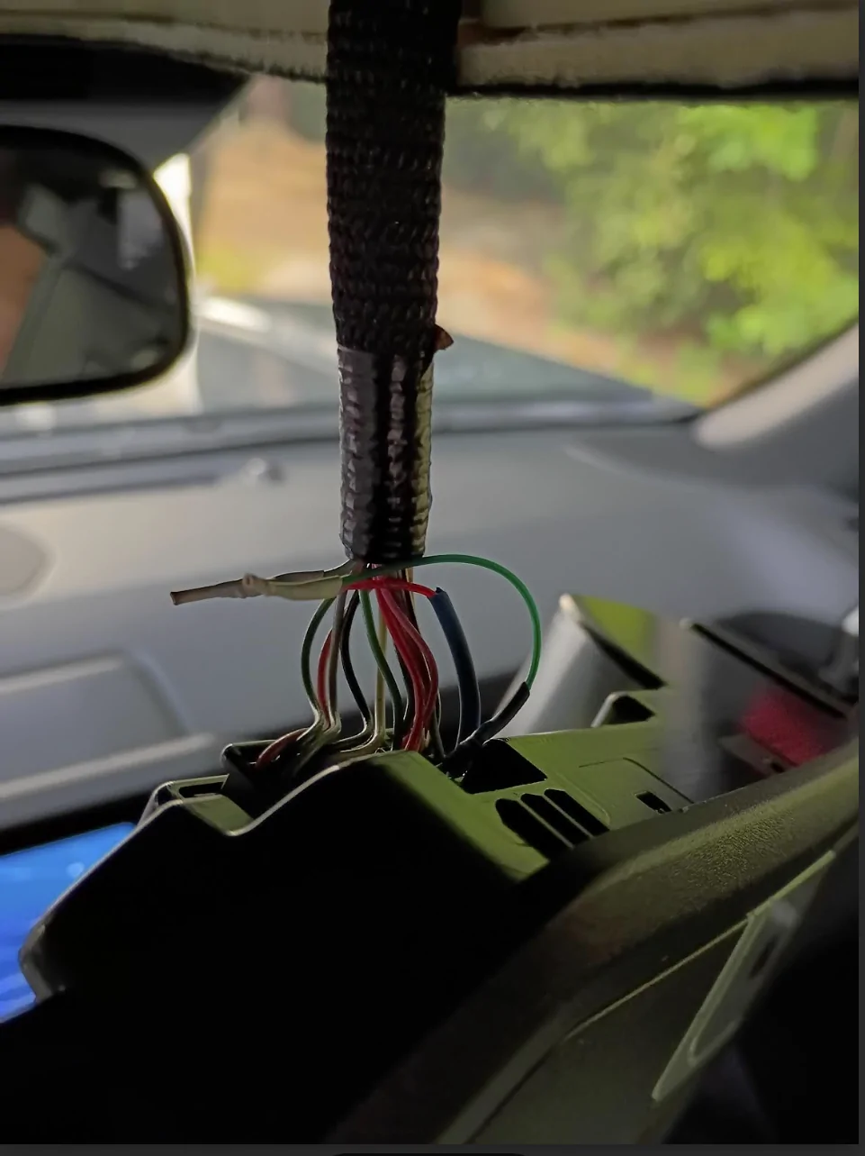

not my proudest moment, but I couldn't get the lance retainer lifted, so
I went ham and cut/twist/soldered/shrank
swapped sky blue with pink
21 sky blue - down
22 pink - up
now pulling switch down lowers window, pushing up raises window
...Finally! I can sleep...

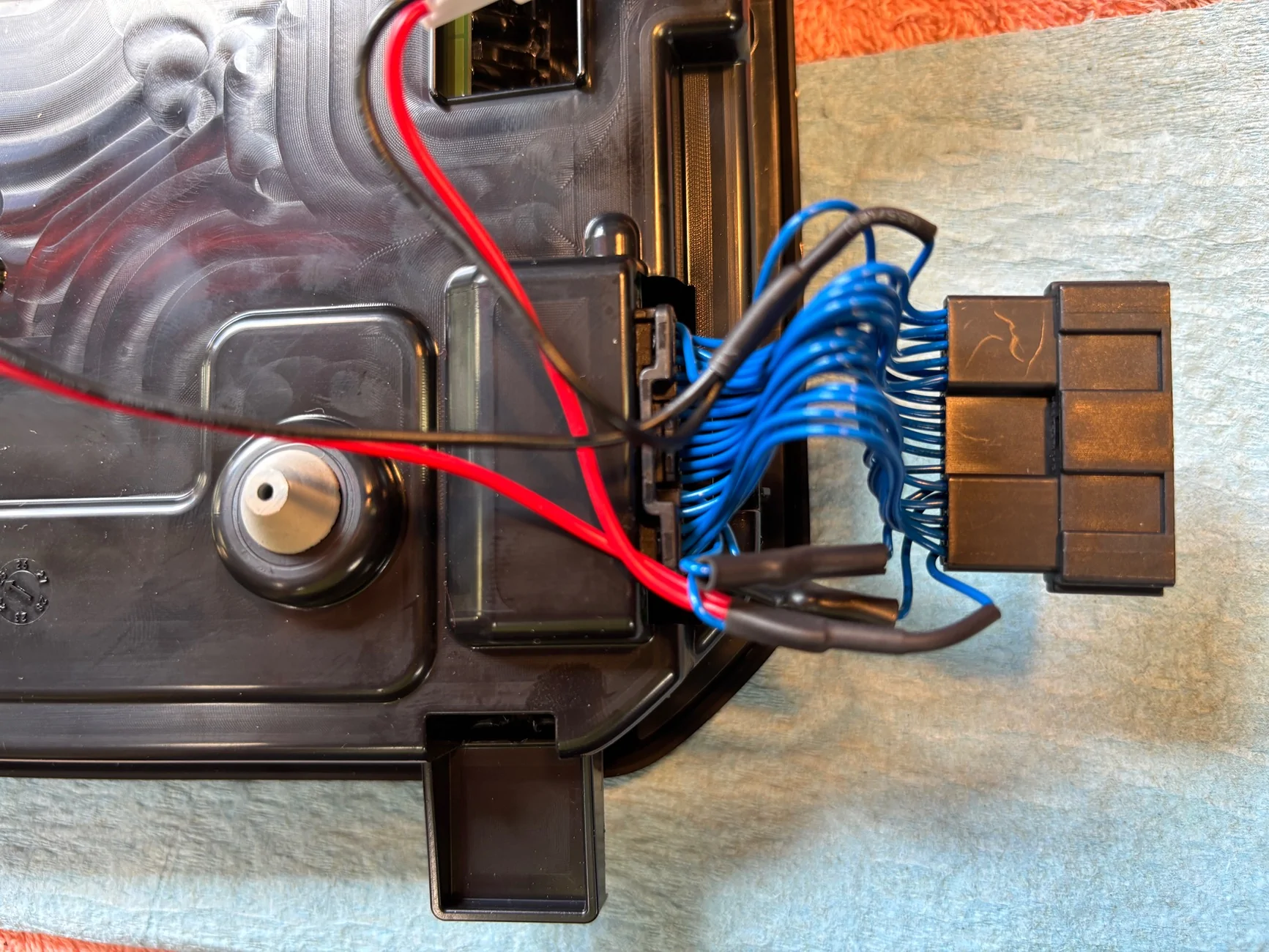

Since I had already installed the meso map lights, I switched the wires in harness adapter, and bam! Pull down and the window comes down, push up and the window goes up!
2025 2026 4runner 6th gen Are you gutsy enough ? Back window switch reversal IMG_3247
Woodsmith
Greg
Feb 15, 2026
62
Yakima, WA
2026 4Runner Limited iForce Max Hybrid,
so, the back window switch seems to defy logic. press up to make window
go down, pull down to make window go up.
Well, if you drop the overhead console box the switch is direct connected
to the PCB, so not easy to make a change.
The connector though, is accessible. Anyone brave enough to flip
these pins 20 and 19 and make the switch operate like some of us think it should ?
Pull down, window down, push up, window up.
NOTE: 20 and 19 are test points, there is no wire there
the actual wires/pins to flip are 22,21
21 sky blue - down
22 pink - up
