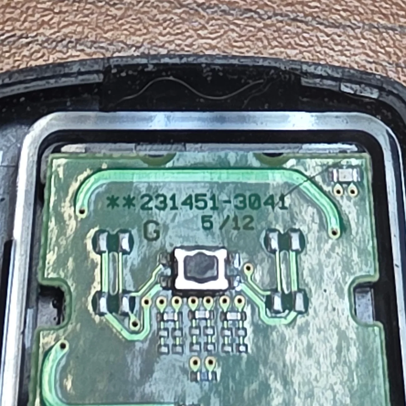

the problem with new fobs is the encryption between the fob and the vehicle.
it started happening with the G series fobs way back starting around 2014 and the new "H" series has even more encryption.
that reduces the range by a lot vs the old simple fobs.
you have to pop your fob apart to see the series etched on the circuit board.
this is from our 23 tundra
