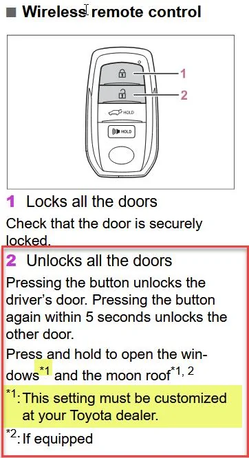

Carista device showed up, got it up and running in a few minutes and after plugging it in, the app connected and gave me a clear list of all configurable options. Super easy.
I can confirm the long hold window open works, along with any other feature I changed. Note, it opens the sunroof but it does not open the rear tailgate window.
What I would actually prefer, is a long hold of the lock button to close everything when leaving the car. That does not seem to exist. I was able to use the key and raise the windows, but taking out the physical key is a pain.

Just one note: keep holding the button until the windows are at the level you want. I tried it, and as soon as the windows started moving down, I let off the button, and they stopped. I couldn't get the sequence to repeat for them to go all the way down. A cool feature if you only want them down a little, but just be aware.
