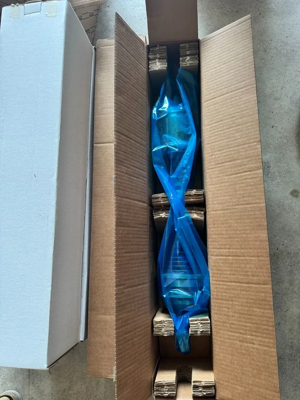

Regarding the Drive Shaft Assembly/Axel that is shown in your video: We Installed a 2026 4Runner with the ALL NEW 2.5" TRD Lift Kit, and that DangitsDan gave us a photo above, and Zcmack did some PN sleuthing:
Is that part in the TRD Lift Kit for the Hybrid? (we know its in the non-hybrid kit cuz dan got one.)

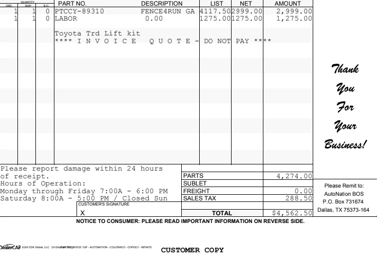

Here is what my local Autonation franchised dealer is asking when I used their parts quote form:
2025 2026 4runner 6th gen Any updates on OEM 2.5" TRD Suspension Lift? 1780756401316-z5
They've not price matched any of the usual sellers online for other purchases I've done, like skid plates.

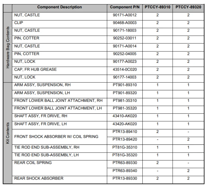

Here are the parts for the two lift kits for the T4R6G.
For fitmet and labor questions and compatibility, please refer to the chart on my Trail Teams website here: https://edmartintrailteams.com/trail-teams-lift-kits/
Thanks so much for engaging, Eric. Very much appreciate the data and insights you provide.
It would seem that the only difference in the two kits is the springs both front and back (and maybe some setting on the front shocks) - assumedly to account for the weight difference between the iForce Max and regular iForce trims (i.e., hybrid battery, traction motor, maybe a few other items) to achieve the spec height change. Please reply if I need to be corrected.
Thanks again.

Yep! Exactly my tohughts, weight correction is the only real difference.
