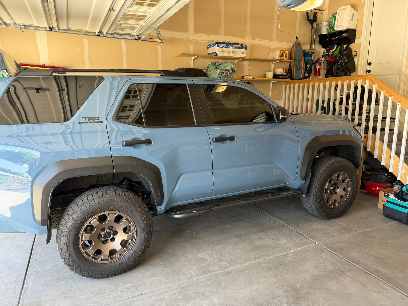

Picked up mine this afternoon.
Local dealer did the labor for $1275+tax.
They matched the alignment specs to a TRD PRO, per the work sheet.
Tracks straight and true, but also the suspension is a good bit better than stock OR in my opinion.
Much more forgiving on potholes and expansion joints, probably overall a 30%+ improvement from stock.
I'm going into the mountains this weekend, so will put it through it's paces.
Trailhunter wheels + 275/70-18 (33.4") tires.

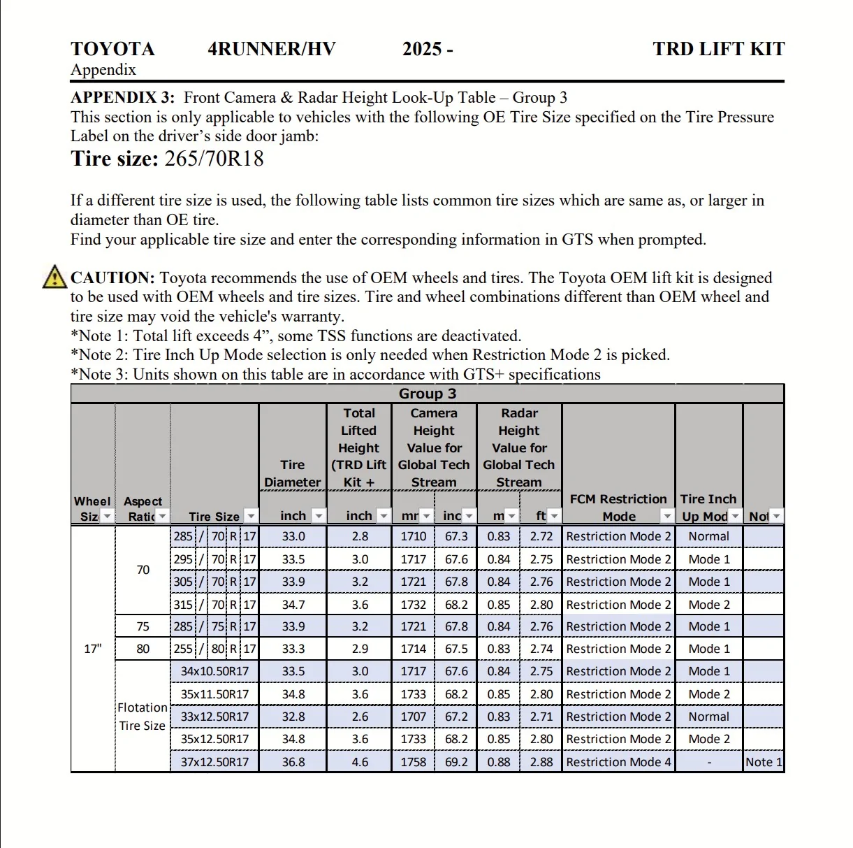

Here's the adjustment table for ORP. Note that there's a different table for each trim based on original tire size.
Looks like total lift with my 285/70r17s is 2.8". I will say this looks and feels much higher than 2.5"...
“Tire inch up mode” column is very interesting… maybe this is how they can adjust for new tire diameters independent of this particular suspension upgrade?
In other threads it’s been implied there is no calibration possible for diameter changes…

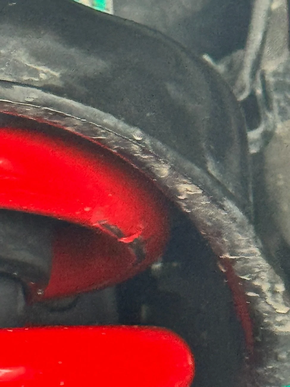

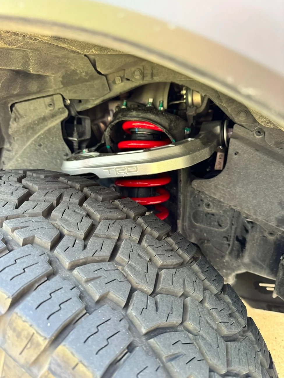

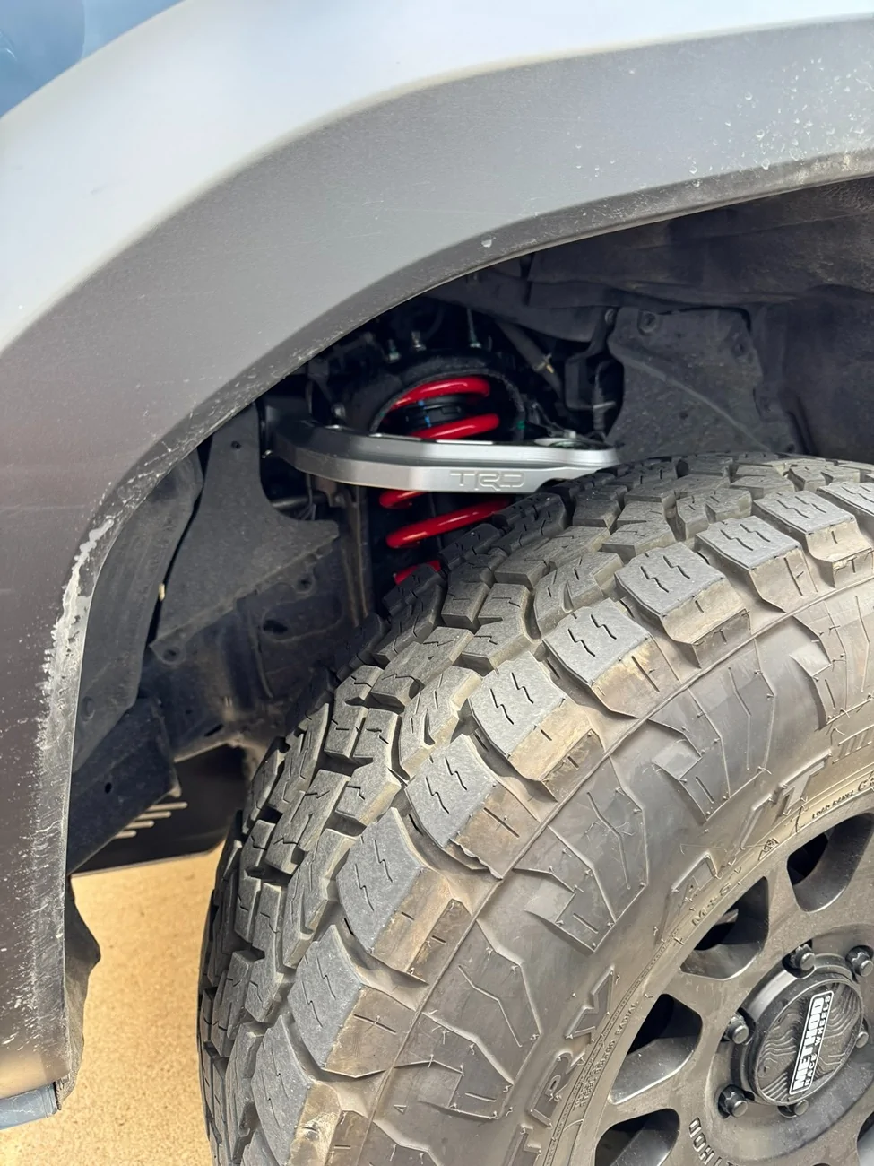

Couple quick closer shots and a little driveway backout clip (peep my neighbor's heritage blue house) lol. Looks like the shop put a nice little booboo on one of my coils, so I ordered some red dobinsons coil paint to patch it up.
Got a chance to drive it some more and I gotta say it is night and day over the stock setup. It takes bumps at speed like a champ and no extra body roll that I could detect yet.
I was a little worried that my wife wouldn't like it bc she's 5'2" and we have our first baby one the way, but she just took it to run errands and came back with a grin on her face and said "I thought about just driving around a bit more because it rides so nice now". I think I will swap the OEM rock rails for some that have a step to help with her challenged height.
Last point I will make for now is that it finally feels like a 4runner should in my opinion. Rugged but not like a wrangler. Just high enough. Commanding stance and driving position. I think I can now finally part with my 5th gen to get her a mom mobile.
More pics after I give it a good wash this weekend.
