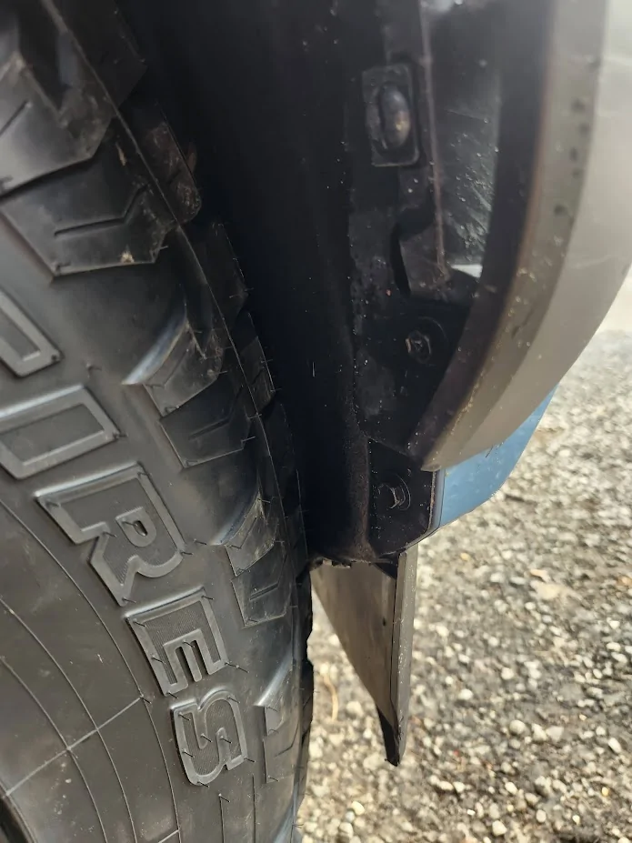

@MikeD Did you add a lift running 285/70R18 on TRD Pro wheels or stock height?
Yea - guess I should have noted that. My 285/70 rubbing with PRO wheels (+20 offset) that was alleviated with TRD Flat Black (+45) includes the Peak 1.25" leveling kit (5/8" spacer at top of strut assembly). This definitely impacts overall ground clearance (along with the bigger tires), but I don't believe it has much impact on rubbing - the rubbing contact point (air dam tab) with +20 PROs is just above (1"?) the horizontal center line of tire - so without the top spacer I believe the same rub would occur (not worse?) just at or below the center line - with not much difference when articulated. (I don't KNOW this for certain but I THINK its true) - and this rubbing is eliminated with the move to the +45 wheels.
Forward rub contact point with TRD PRO wheels & 285/70/18 Toyo A/TIII (inc Peak level kit):

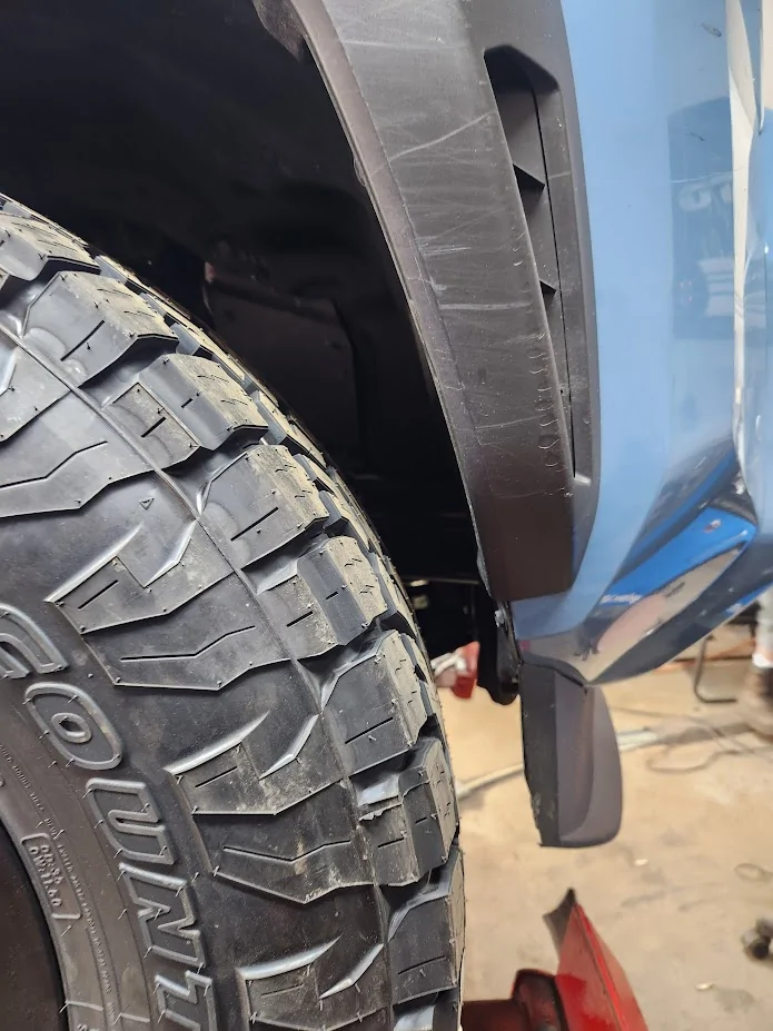

FWIW this is during install with vehicle lifted from frame - full natural sag:

Hard to see detail on this shot but this is immediately after install of leveling kit and new wheels/tires (note: I was able to avoid front rub by removing air dam, bending screw tab up, heating felt and pushing it forward and removing crash plate)

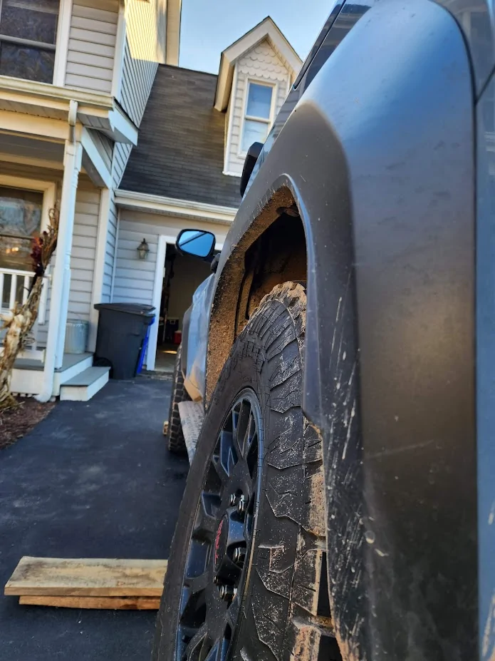

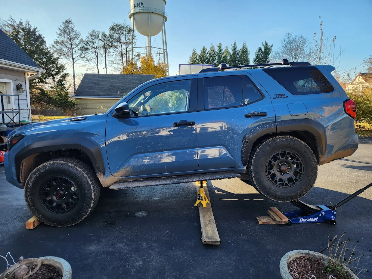

So, I could have lived with this situation EXCEPT when I went off-roading and had full articulation on the rear wheels - they rubbed against the fender flare/wheel well on the edge. (The larger fender flares on the PRO/TH do matter.) This is what triggered me to get the TRD Flat Black wheels to go with the 285/70s and it seems to have solved both rubbing issues.
My attempt to prove to myself that the wheel offset eliminated the rub on rear fender flare (I just didn't have the tools to push the tire all the way up like I've seen from Tinkerer's Adventure - fitting 37s on stock Tundra (I think this video shows what I'm talking about). And subsequent full articulation of rear wheels off road have not resulted in me hearing/feeling the same rub as before.

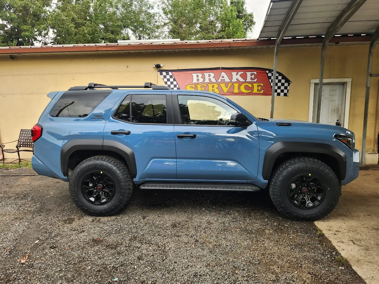

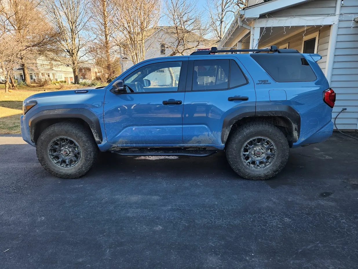

Note that I am running the 285/70s with TRD Flat Black wheels for winter and off-roading - and swapping in the OEM Michelins (265/70) on the TRD PRO wheels for long distance travel because of the significant range/MPG improvement (I also put the air dam back on).
Here is current setup for winter - including recently installed CaliRaised step edition rock sliders (will post the running boards for sale once I get the chance to clean off the mud from my last adventure - I really like the running boards but wanted the extra protection from sliders):
2025 2026 4runner 6th gen Any mods / accessory / upgrade regrets? 20260119_115951
I guess I could have given a simple answer but your question seemed to need a bit more than that. Good luck

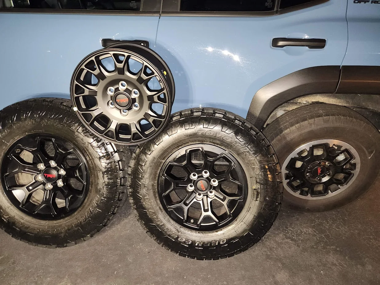

Which offer do you prefer aesthetically? I love the pro wheels but love the way the ‘TRD flat black’ wheels sit.
I slightly prefer the look of the PROs. Something about the way the openings/spokes are arranged seems cleaner to me. The extra "hub" metal on the TRD Flat Black seems to take away slightly from the ascetic. But I've got both so its all good:>) And just for grins, here they all are for zoom in comparison to anyone who cares (including stock TRD OR wheel which is now living on my sons 5G4R SR5 Prem. in Denver with SL 265/70/18 A/T IIIs):
2025 2026 4runner 6th gen Any mods / accessory / upgrade regrets? 20251028_060730
