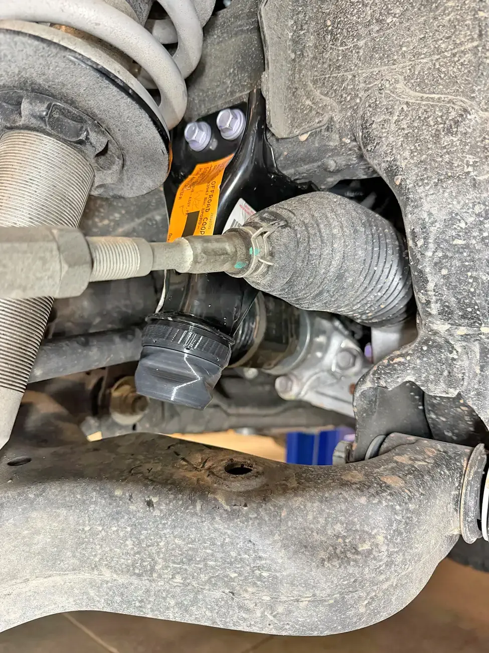

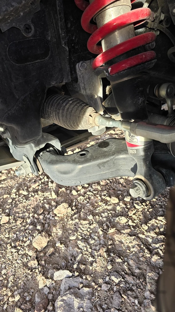

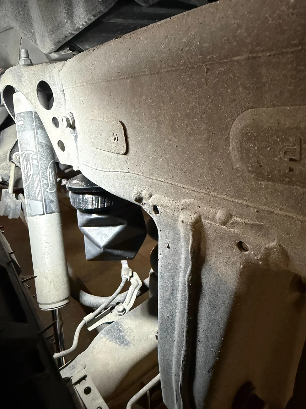

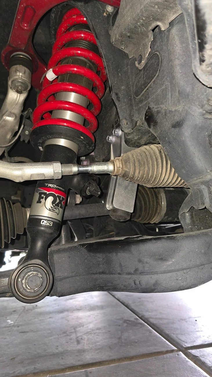

Hey guys!
For 4Runners that do not have front bumpstops, it is possible to purchase front bumpstop brackets from an LC250 / GX550 at your local Toyota dealership and they are a direct bolt-on to the 6th gen 4Runner. We just test-fit some prototype v3 Perryparts bumpstops that should be releasing in January.
Partnumbers that are needed -
1x Driver side bumpstop bracket - 51604-60060
1x Passenger side bumpstop bracket - 51603-60060
6x Fastener - 91674-N1030
We will be posting a howto video on our youtube channel soon!
2025 2026 4runner 6th gen Front & Rear Bumpstops Upgrade (brackets from LC250 / GX550 are direct bolt-on) 26077-ebc8fb7be2089be97b315ddca004ec3
2025 2026 4runner 6th gen Front & Rear Bumpstops Upgrade (brackets from LC250 / GX550 are direct bolt-on) 1765576680550-ra
