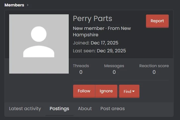

Patrick at Perryparts plans to offer the bumpstops for sale with the towers and fasteners included I believe for 6th gens. This is probably why they will be more expensive when they release.
He registered to participate in the forum but I do not believe his account has been approved yet.

Last I emailed with him, he said that he wasn't going to stock the OE towers and use a disclaimer on his website that they need to be supplied independently. He's at King of the Hammers now. I wish the admins here would approve his account so that he can comment directly.

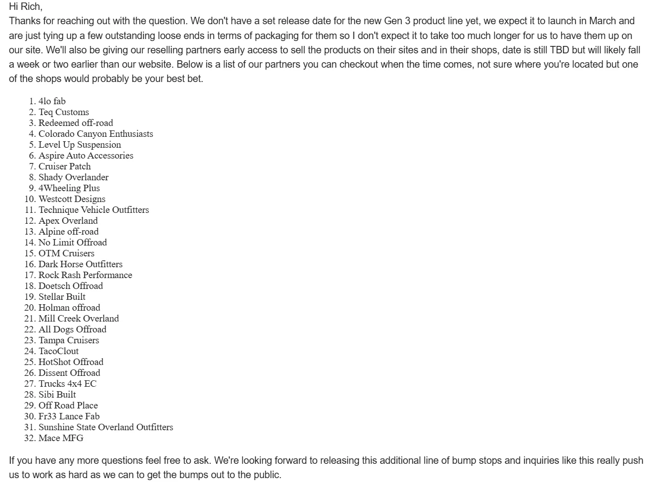

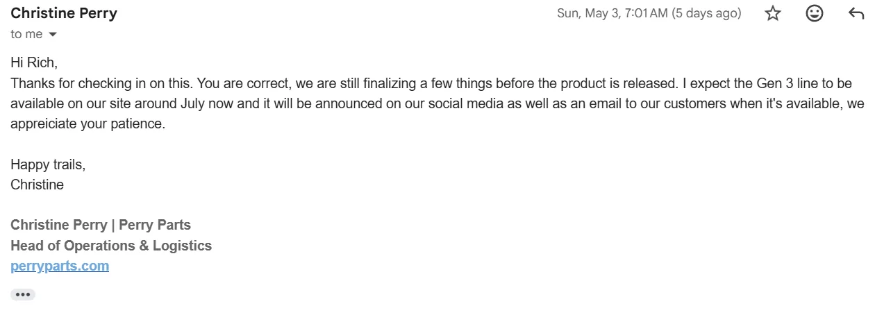

@griegert if you wait just a bit longer, you can get the gen 3 line from perry parts.
email from Christine:
2025 2026 4runner 6th gen Front & Rear Bumpstops Upgrade (brackets from LC250 / GX550 are direct bolt-on) 1778260614998-w3
