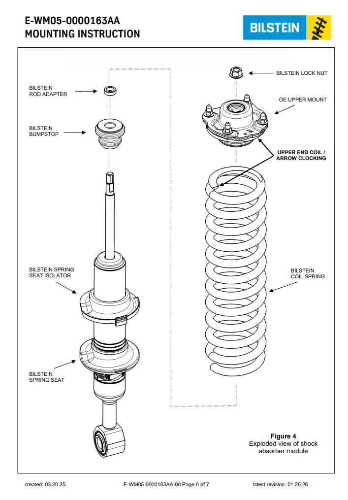

@alldogsoffroad I have a question for you
I purchased the Bilstein 6112 front and 6100 rear kit for my rig. Obviously I will be upgrading the rear bumpstops to Perryparts V3 when they're out.
As far as the front goes however, the 6112 has an integrated bumpstop on the coilover. Do you still recommend adding the bumpstop tower from the LC250 to the front? In addition to the integrated bumpstop?
Pic from the 6112 spec sheet:
2025 2026 4runner 6th gen Front & Rear Bumpstops Upgrade (brackets from LC250 / GX550 are direct bolt-on) 1779588180467-l

If you're offroading aggressively I would recommend it. If you're mallcrawling then it isn't necessary.
