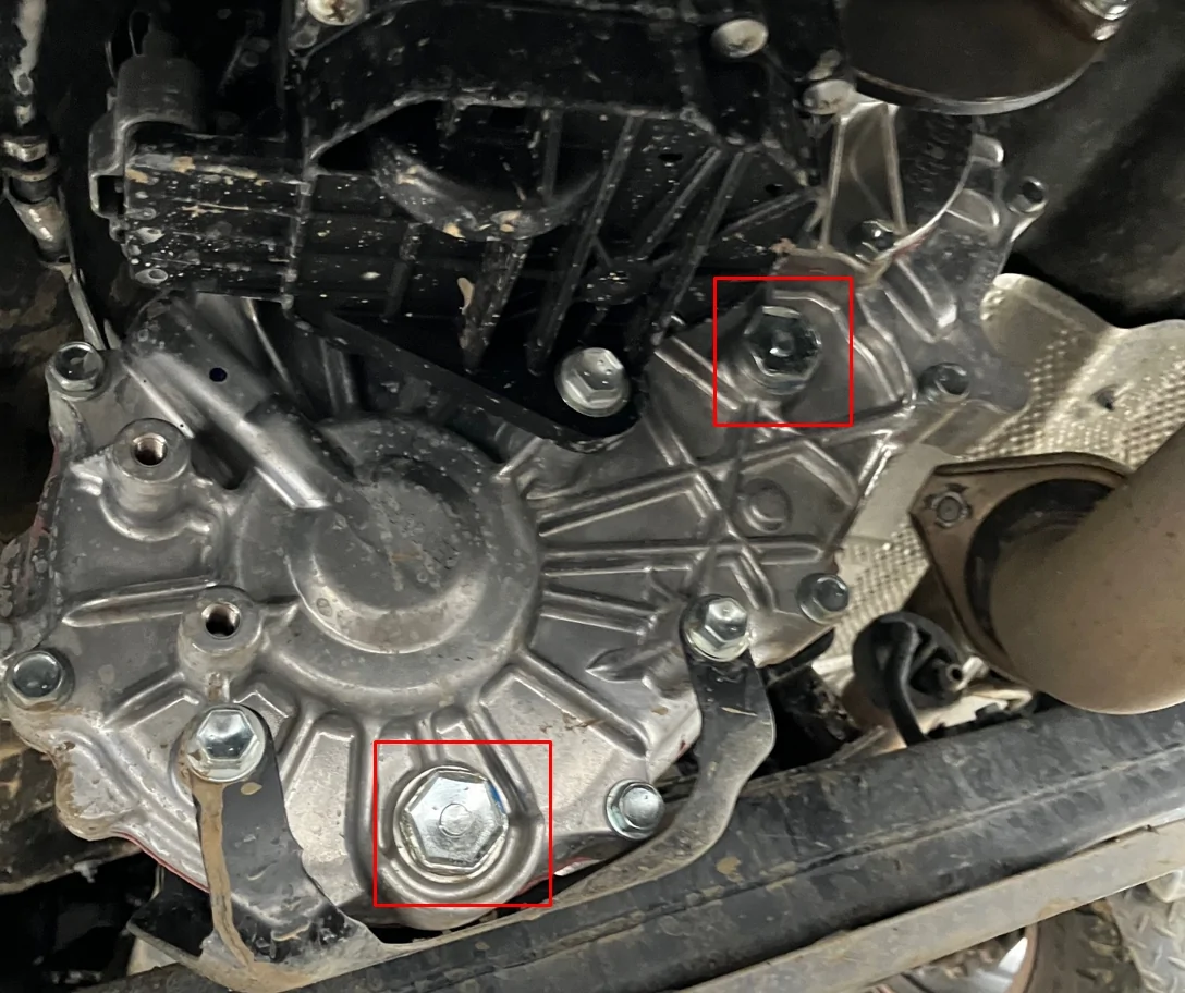

REAR DIFFERENTIAL
Video of rear differential change:
1. Lower Spare Tire
  • Remove the tool kit from behind the rear passenger seat
  • Insert and rotate the tool through the rear bumper port to lower the tire fully, then slide it out
2. Loosen Fill Bolt
  • Using a 24mmsocket, break loose the fill bolt first
    • The fill bolt is located high on the rear diff cover
    • Loosen it first to ensure that refill won't be a problem
    • Do not fully remove it yet
3. Drain Oil
  • Place your drain pan under the differential
  • Remove the 24mm drain bolt and drain into pan
    • Expect a larger volume than the front (4+ qts)
    • Remove the fill bolt to help it drain completely
4. Reinstall Drain Bolt
  • Clean the metal sludge off of the magnetic end of the drain bolt
  • Replace the old crush washer with #12157‑10010
    • Verify no old washer is stuck on the housing
    • Place smooth side toward the differential housing; rounded/seamed side toward the bolt head
  • Tighten the bolt to 36 ft‑lbs (432 in‑lbs)
5. Fill Oil
  • Add 5.9 qt (except Trailhunter) or 6.9 qt (Trailhunter only) of 75W‑85 oil in fill hole until the oil slightly weeps out
    • Fill through the upper port using squeeze packets or a pump
      • The rear diff is very easy to refill using squeeze packets
    • The correct level is reached when fluid begins to overflow the fill hole
6. Reinstall Fill Bolt
7. Reinstall Spare Tire
  • Slide the tire back under, align the cable, and crank it up until fully seated
    • Verify it is centered and snug

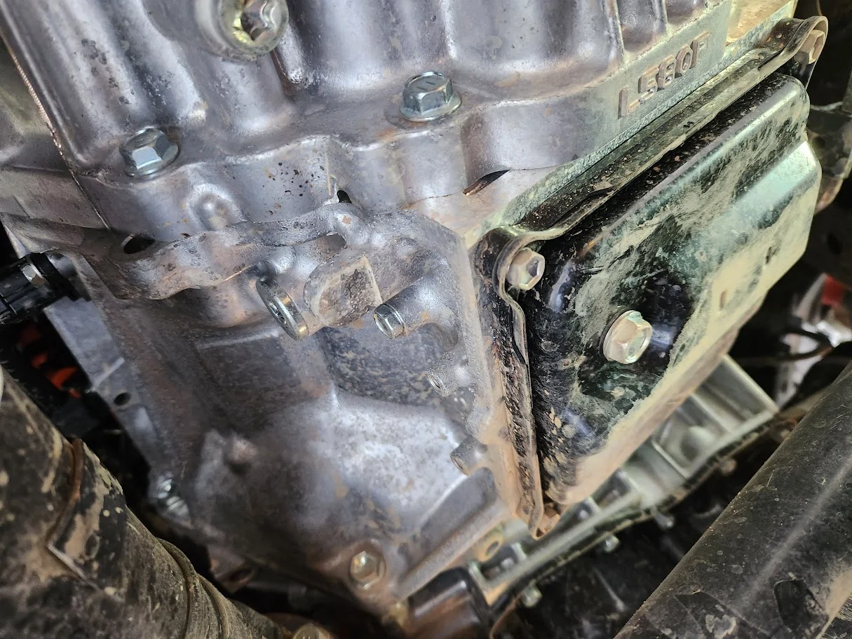

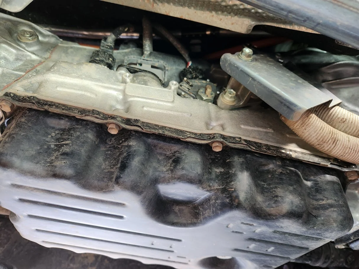

I think this is the transfer case drain plug but its not at all obvious to me where one would put oil into the transfer case. I'm sure some more googling will get me the answer but happened to be under the vehicle installing the skid plate that covers this area so took a few photos.

I believe those images are : Electric motor and transmission oil pans. Transfer case is further down the drive line.
Yep - I think you are correct. And the diagram on this Transmission Fluid replacement instruction shows it clearly (yea - Land Cruiser instruction but its still our L580F transmission)
Trans Fluid Replacement
- not that I fully understand the instructions.... can't figure out for sure if the "transmission case adapter refill plug (step#9)" is the same as the "transmission oil filter tube" (steps #3 & #4 of c & d). So for now, not something I will try to do on my own.... I'm just a bit unsure of the details.
Now to crawl back under and see if I can figure out where exactly the transfer case is. But this video gave me the answer at about the 2:45 mark: Undercarriage of 2025 4Runner Sport (Yea- the video is off a ICE no Hybrid so things are a bit different)
Not enough detail to see where to drain and fill the transfer case oil but at least I now know where it is. Any chance the transfer case is integrated with the transmission and does not have separate fluids? (I've been totally unsuccessful searching for transfer case oil change and it seems like the transfer case is virtually part of the back end of the transmission. And clearly I don't know what I'm talking about so this is just a guess.)
Thanks for the correction.

Good to see you learning here with shared knowledge and experiences. That's the essence of a forum as such.
If my instinct is correct, Toyota transfer cases have been quite the same since the mid 90's (sure updates like manual and electronic shifting). What I mean is that they have not reinvented the wheel here and it seems to be the case for this one. Even the Fill/drain bolts look the same as an 87' pickup.
Please correct if I'm wrong here but see pic below.
And I apologize for hijacking this thread.
3. Drain Oil
5. Fill Oil
Final Checks
  • Wipe down all components and confirm no leaks.
  • Dispose of old gear oil properly (O'Reilly Auto / AutoZone / etc accepts it for free)
  • Test drive for several minutes, then recheck for seepage.
Notes & Tips
  • If a washer seems missing, it's often stuck to the housing. Remove it gently.
  • You can do the entire job without lifting the truck, but lifting improves access.
  • Slight metallic fuzz on magnets is normal; chunks are not.
