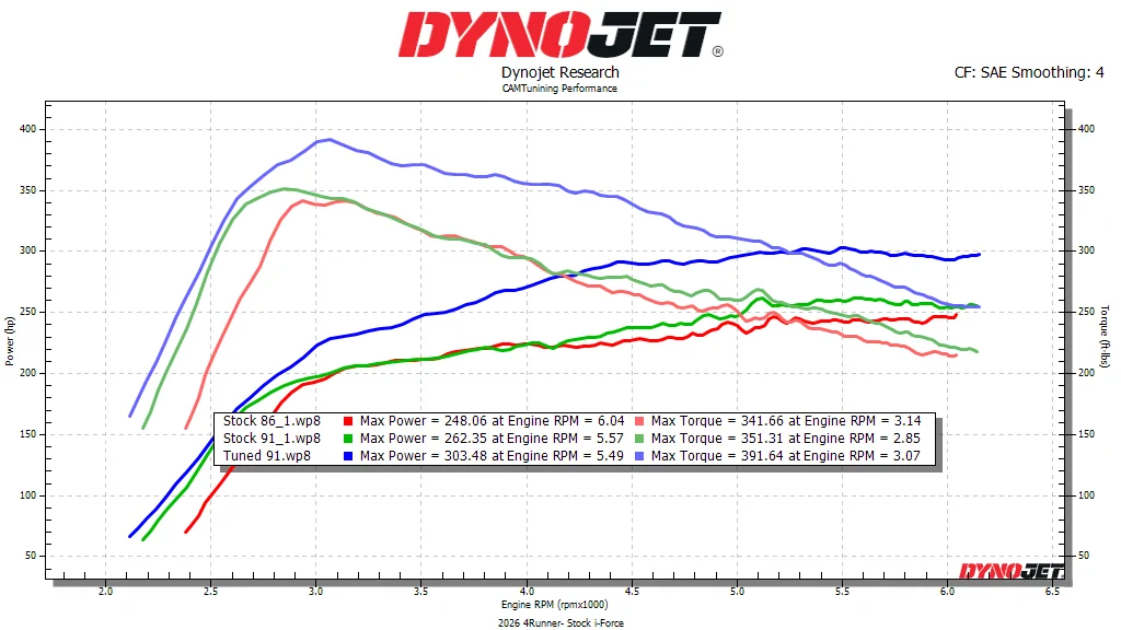

I'm back with the information I promised I would get. I spent almost three hours on the dyno, letting the vehicle cool down between runs, and I took the best of four runs in all cases.
One thing that I have characterized on both the 4Runner and the Tacoma is that the first run after an ECU reflash always reports lower power on the dyno. I have not quite nailed down why but it is something with ECU learning certainly.
On the stock tune with 91 octane the KCLV value was 18 to 19, meaning that the confidence level of the ECU was very high. When I first dynoed it on 86 octane it was 13 to 14, meaning that it was actively reducing timing. I did runs on the stock map and then I tuned the ECU on 91. You can see that in the very low RPM there was not a big difference but in the higher RPM when charge temps start to climb and knock is a lot more likely, the 2 curves diverge quite a bit. You will notice that I used a different base line here, and that's because we dynoed on 86 again, and it was warmer today. I wanted to have a direct, same condition comparison to keep everything as accurate as possible. This was the best of 4 runs, with the lowest being 242whp. 91 was added on a low tank, so there was still just a small amount of 86 in it.
In summary:
  • Peak HP was just over 14whp higher on 91 vs 86, and tq was ~10wtq higher. I didn't quite nail the run start on the 86 run, so I will say that the peak tq gains were likely a little less. What you'll note is that the hp and tq curves begin to really separate around 4200rpm, and stay apart.
  • You'll also note the bump in both 86 and 91 octane runs around 5000rpm. This has been present on every stock tuned 2.4T I've tuned. You'll note that it's not present in the 91 octane tune.
In summary:
I commend you for efforts, time and participation in this community. This is notable information to have received & I don't dismiss it. I consider it at face value with very little doubt about the accuracy of the information you've graciously obtained & provided here. Thank you. 🙏🏻
It's interesting that there's a “minimal” increase in HP & TQ using 91 octane versus 86 octane which was stated previously...but again, as has been said previously, to the average commuter it won't be perceived while driving & in my opinion doesn't justify the added cost. Where it might make a difference is increasing efficiency and life expectancy of the overall engine processes & operation. But we are really discussing HP & TQ gains here. Also, I can only speculate that Toyota doesn't advertise the slight gains when using higher octane gasolines because the gains are negligible & not widely perceptible to a majority of drivers. Again, speculation about this on my part but I've yet to find or see any documented claims from Toyota on the topic.
Without a doubt though there is clear benefit to aftermarket tuning even when only using 86 octane. This I didn't doubt previously. I personally won't be seeking to have mine tuned because I simply don't need the main benefits it would provide nor what I imagine is increased stress overall from the increased outputs. I do respect those who choose to have theirs tuned though as they clearly have a need for or simply want the increased outputs based on their personal use case scenarios.
For my use case scenario & region, I plan to heed the suggestions of ChatGPT based on the graph you provided by choosing my gasoline grades (in Texas) strategically...
• Cool/Cold weeks/months = 87 octane
• Hot/Scorching weeks/months = 89 octane
• Towing/Heavy Cargo/Traversing Steep Inclines = 91-93 octane (I likely will never have a need for this.)
This is because I do tend to believe there is some small benefits of reduced stress on the engine processes & operations using 89 octane which I want for engine longevity...not because I believe the very minimal HP & TQ gains are worth paying more for. I don't see the tangible or financial benefits of fueling with 91-93 octane in my typical use case unless 87 and 89 octane are not available or unless I'm filling with Costco's 91-93 octane which is usually priced very competitively to surrounding brands' 89 octane gasoline.
