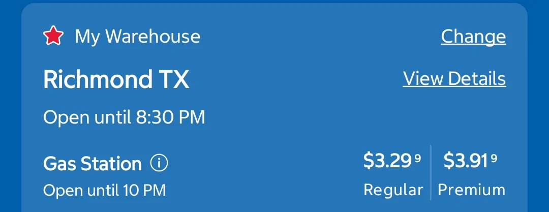

I do want to call attention to your math though...“Want to save $3 a month in fuel?”? That's not actually factual from someone insisting on people posting factual information. Your math ain't mathin', bud. Let's think about this. I've attached a screenshot of what is currently the gasoline prices at a Costco nearest to my residence. Costco typically always offer the lowest prices around for Top Tier certified gasolines...at least in my area. As an example, if I fill with 19 gallons of Premium instead of Regular then I'm paying $11.78 more for one fill up & for what...maybe a 5-7% increase in HP that is likely inperceptable in real world driving scenarios. I personally fill up at least 4 times a month so that would be $47.12 more than if I had filled with Regular grade gasoline. People are free to spend their money how they choose to. I'm just not seeing the value in paying for Premium grade because it's very likely not doing very much at all that's going to make my 4R last longer than Regular grade Top Tier gasoline would be doing because the engine is not tuned to benefit from higher octane gasoline.
Oh but wait...what about detergents in the fuel? The U.S. government mandates that a certain amount of detergents must be added to all gasoline sold in the U.S.. All grades have the minimum required detergents but Top Tier certified gasolines exceed the minimum required amount of detergents which is one reason why they cost more. What is false is that Mid grade & Premium grade contains more detergents...it's practically false advertising. There is a study in particular conducted by AAA using brand name gasolines that proved that the only differences between grade is the octane rating...the detergent amounts are approximately the same between grades. I digress again but you're welcome to search for the AAA study & review the Top Tier Fuels website if you want to know more.
