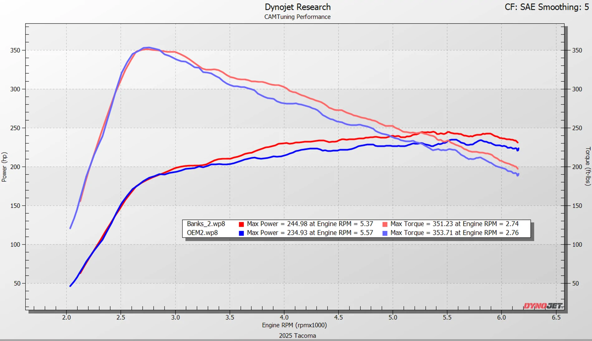

Can you post just the banks and OEM to make it a little easier to read power under the curve. Also, did you do this test with the OEM vs aftermarket charge pipes?

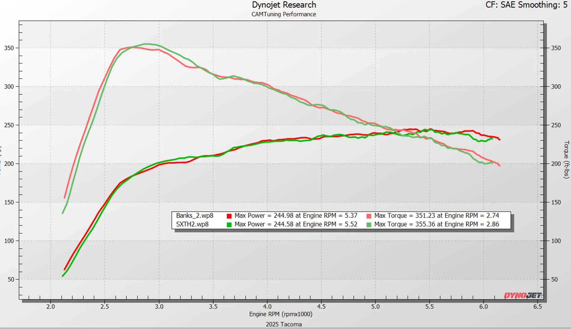

Here you go:
2025 2026 4runner 6th gen Intake Power Gain Comparison (Factory, Banks, SXTH, K&N) — Same Truck, Day, Dyno, Surprising Results 1780527286304-il
you will not see any gains from the charge pipes even with an intake. they're just additional parts needed for a tuned setup that would also most likely include a bigger intercooler.
I tend to agree here, but may test just to test my assumption. I have a set of brand new Banks charge pipes, and a brand new 4Runner I need to do some dyno testing on. I will likely repeat my SXTH vs Banks Intake testing, then add the charge pipes.

Here you go:
Thank you for taking the time. It doesn’t look like that’s the OEM and banks though?
Sorry I misread the request and thought you wanted just sxth and banks. I’ll get the other graph when I get back to my laptop.
Stock vs Banks. Peak numbers only tell a very small part of the story, so even though tq peak seems like only a very small gain, there is tq gained everywhere after peak.
