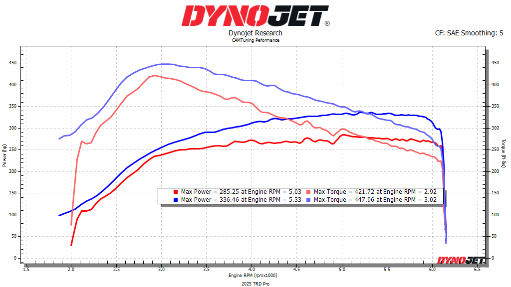

Interesting results. Wondering why it has 15 less hp than the tacoma. Is this a gas or hybrid model? Hard to believe it can do 350 wheel torque when it's rated for 317 or something.
Have you also dyno'd a 5th gen 4runner/3rd gen tacoma? What do those numbers look like?

This was not a hybrid. It's not 15 horsepower less because it's a 4Runner. It's 15 horsepower less because it is on lower octane fuel and the ECU is adapting to it by reducing timing and torque targets. I agree that the torque numbers are quite high but they are consistent with what I've seen on the many 4Runners and Tacomas that I've had on this dyno, including my own. This is common across other platforms as well and probably has something to do with the way that you are able to load the engine up with the drivetrain on a chassis dyno and allow the turbo to spool the same way it would if it were on the road. The manufacturer rates these by using an engine dyno but I would assume they also load the engine in that case. I've never had any of the older generations on this dyno- before I started with this platform I primarily focused on other 4 cylinder turbo platforms, primarily Subaru.
Here's a stock versus tuned hybrid for comparison
