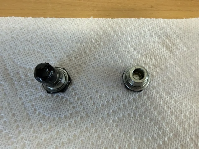

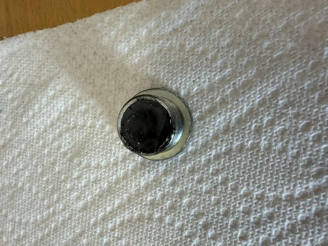

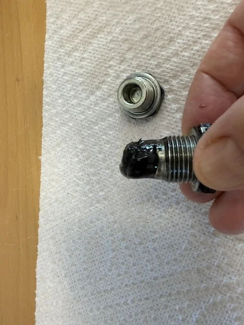

Drained and refilled the front and rear differential on the 4Runner today, it had 5529 miles on it. I decided to not use OEW gear oil and opted for Amsoil 75W85. I was shocked on much fine metal was on the magnetic drain for the rear differential. The gear oil was dark black. The front probably didn’t need drained but I like to get the break-in oil flushed out before 7,000 miles.

I did the same thing (but with Redline fluid) at 5k miles and had a pretty similar amount of particles on the magnet.

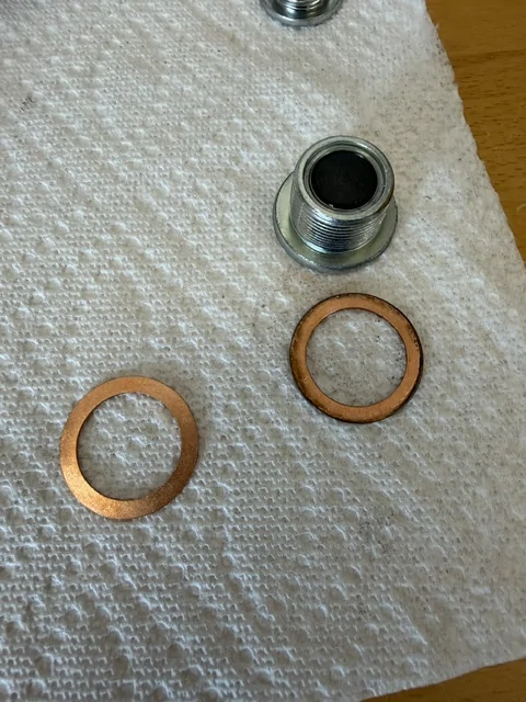

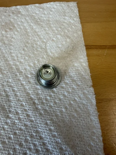

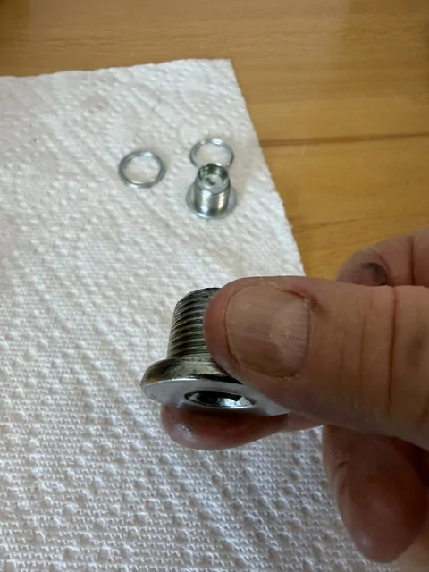

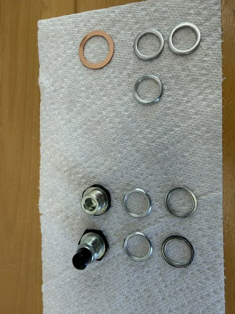

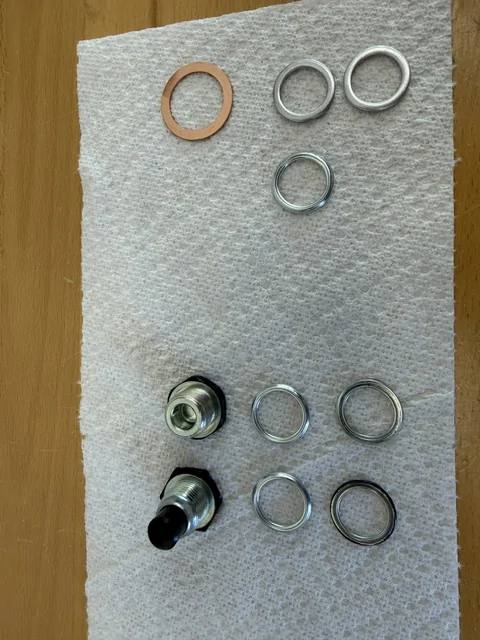

Three of the "12157‑10010" (silver) fill and drain for rear and fill for the front
and the front uses "90430‑24017"(copper) for drain.
Wait so is the bottom ones the old ones? they all look the same
