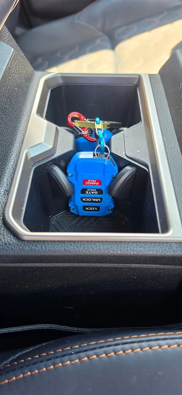

as stated quit taking the fob outside the vehicle :)
you do know the fob fits perfect between the cup holder clips
2025 2026 4runner 6th gen “OMG Stop Beeping at me!!”. How do I mute or muffle the door and hatch beeps? 20260625_120148

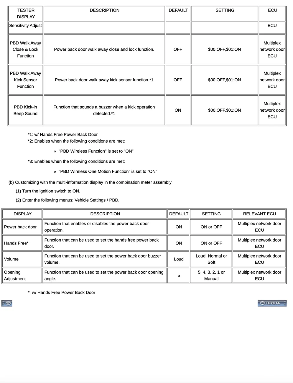

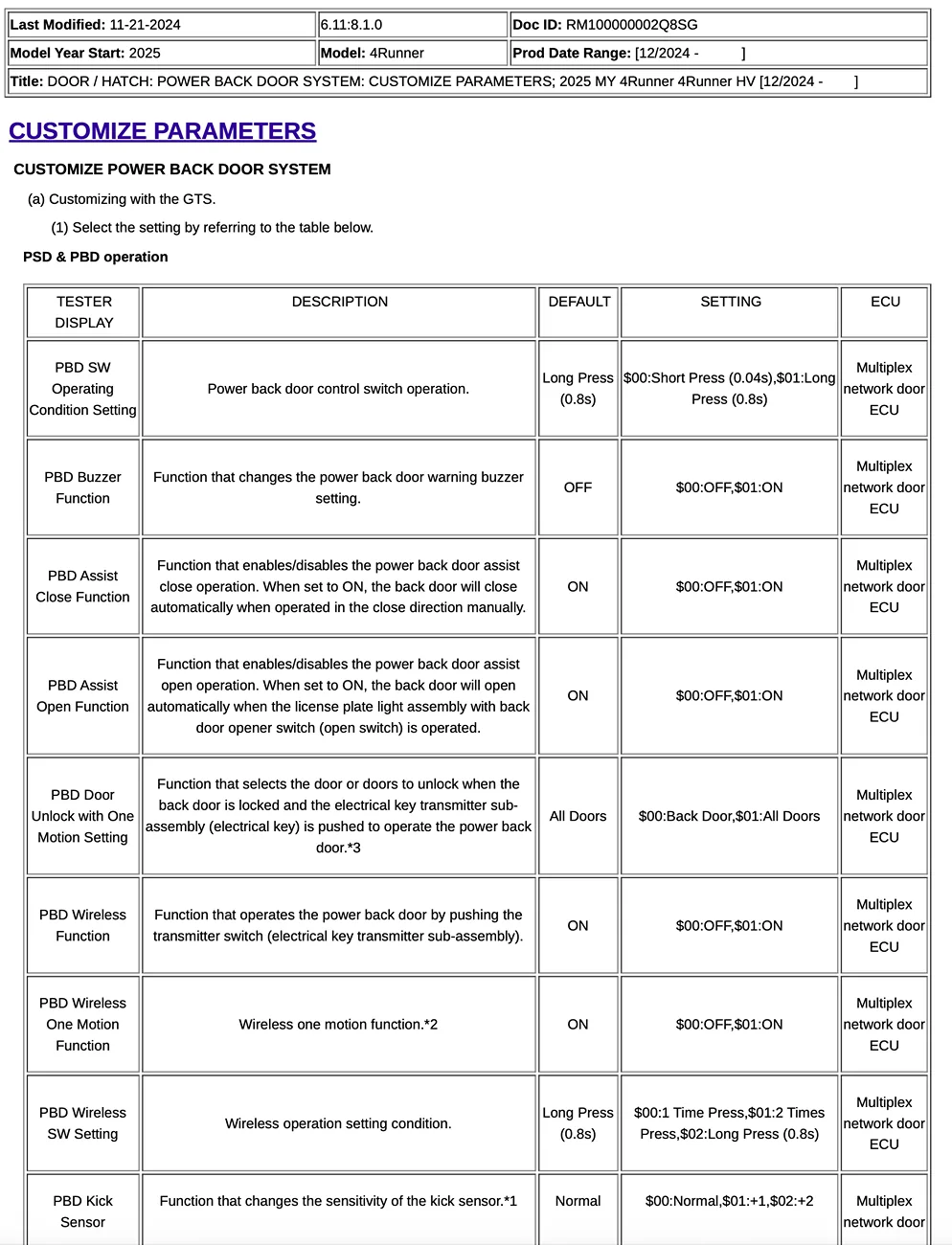

Here is a list of things the dealer can change
from the repair manual.
2025 2026 4runner 6th gen “OMG Stop Beeping at me!!”. How do I mute or muffle the door and hatch beeps? Custom Parameters Pg1
2025 2026 4runner 6th gen “OMG Stop Beeping at me!!”. How do I mute or muffle the door and hatch beeps? Custom Parameters Pg2

Is there a complete list of parameters for the entire vehicle?
for the things you can change as a customer its in the manual
other things requires (most dealers) a service charge since it requires a tech to connect a laptop (GST - global tech stream) to your vehicle to change settings.

I meant a dealer accessible list. I understand how they would do it.
