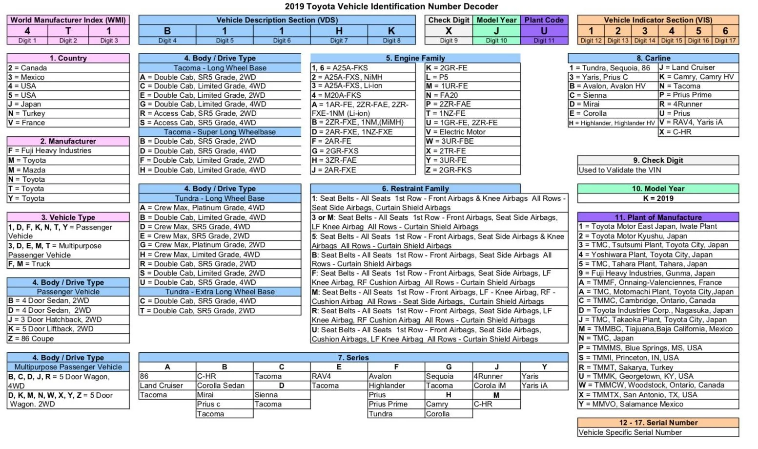

unfortunately i cant find a newer decoder breakout sheet but here is the closest i can find
2025 4runner 6th gen VIN Decode:  JTEVA5 vs  JTEVB5 1767700924934-uf
