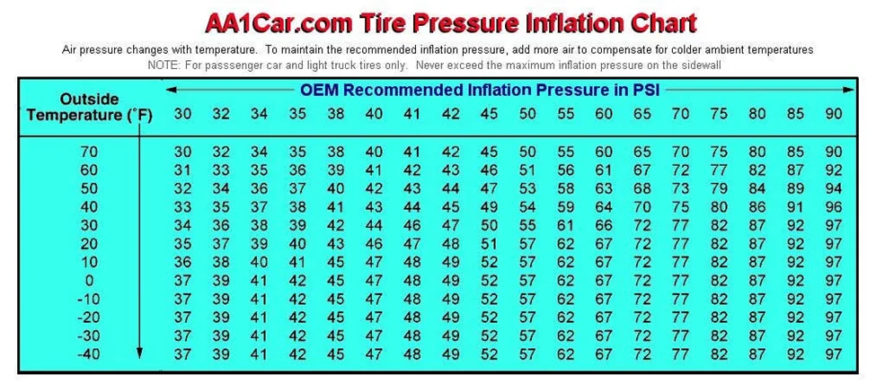

This what I use: For every 10°F change in temperature, tire pressure changes by about 1-2 PSI.
Love the chart. I have nit seen it before but have been making adjustment ad-hoc. So the chart is claiming 70 deg F is the temp the OEM psi is set at. Interesting.
Thanjs for sharing.
