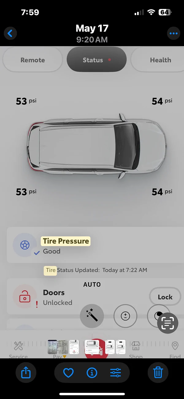

Mine came in a t 40plus.

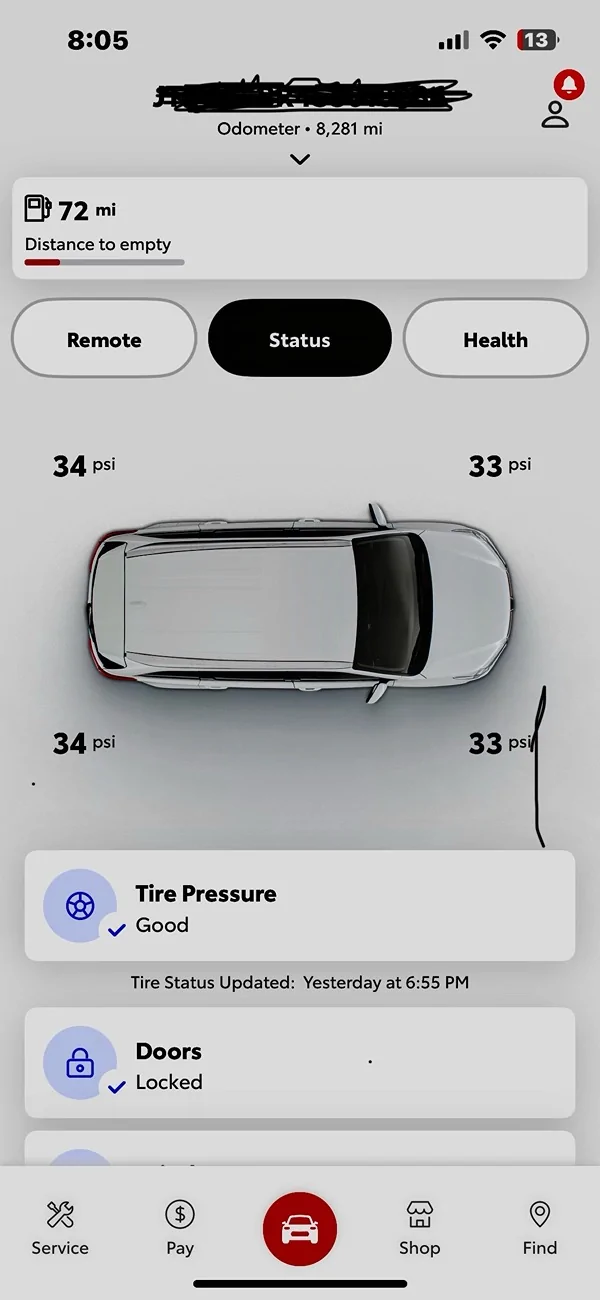

We are currently starting at 31psi cold, after a 2 mile lite highway speed of 60, they quickly rose to 33 to 34. Watching the depth wear closely. 25 TRD Off Road Premimium.

Mine came high (close to 50) as others have said. Once I realized that (pretty quickly) I set them correctly (33). On its first (5000 mile) service the shop set them to about 38 "based on recommended pressure by the state of CA for fuel efficiency and emissions" (that is by memory, but close). I have never heard of that before. Theoretically it would increase MPG (and therefore reduce emissions) but still sounds odd. However, I left it that way at least for now. Interestingly the next fill I got insanely good calculated mileage--hybrid engine, about 28 MPG; I had been getting consistently 23. I put that down to some error of mine--recorded miles or gallons wrong, or something like that--that should show next fill. However, I do seem to be getting noticibely better mileage. I find it hard to believe it would be that much different though. I will try to remember to follow up here when I get more info.

I saw a big jump in MPG raising my PSI to 36-37 range. I’m averaging over 25 MPG now. I guess I’ll leave my PSI like this.
