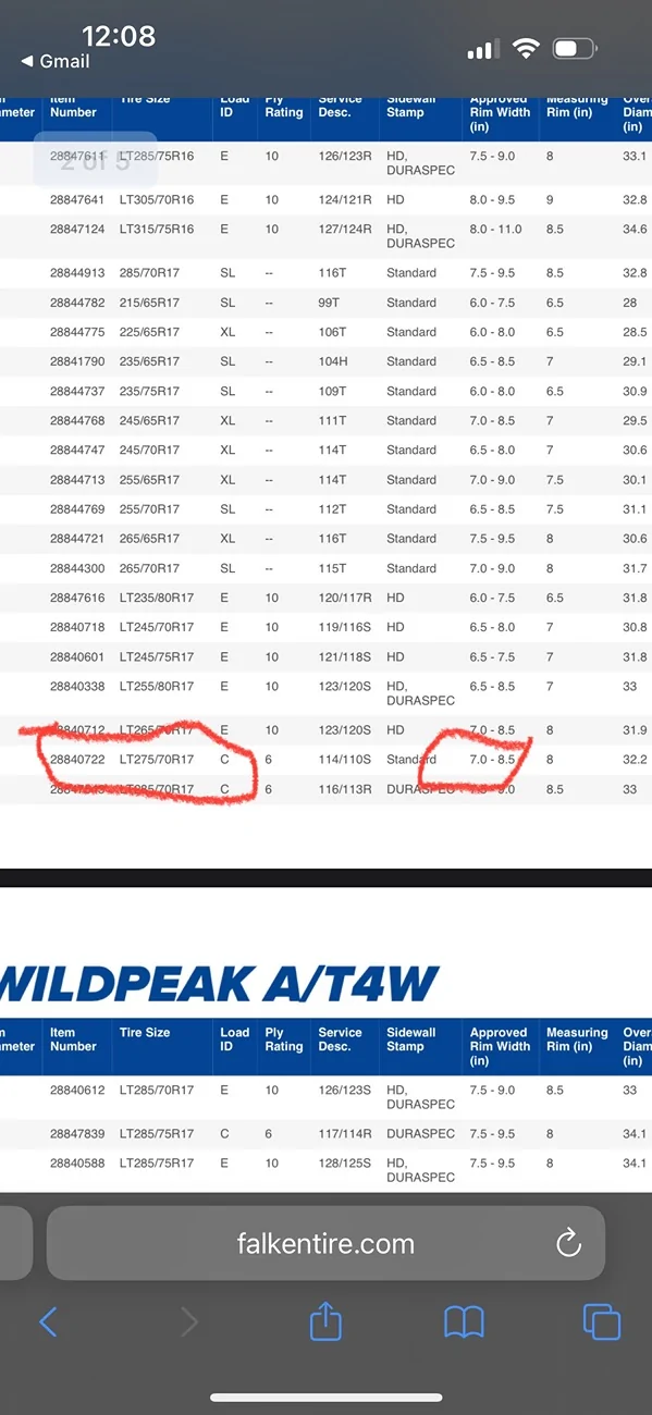

Replaced the factory Geolander 245/70/17 with Falken Wildpeak 285/70/17 A/T4W.
No lift and no rub at all on the stock rim. I can feel the weight of the tire at first drive but seems fine after taking a few short drives. Tires seem as quiet as the factory ones that they replaced. So far very happy with the look and stance of the SR5. Also upgraded to the TRD center caps.
Will post an update in a few days.

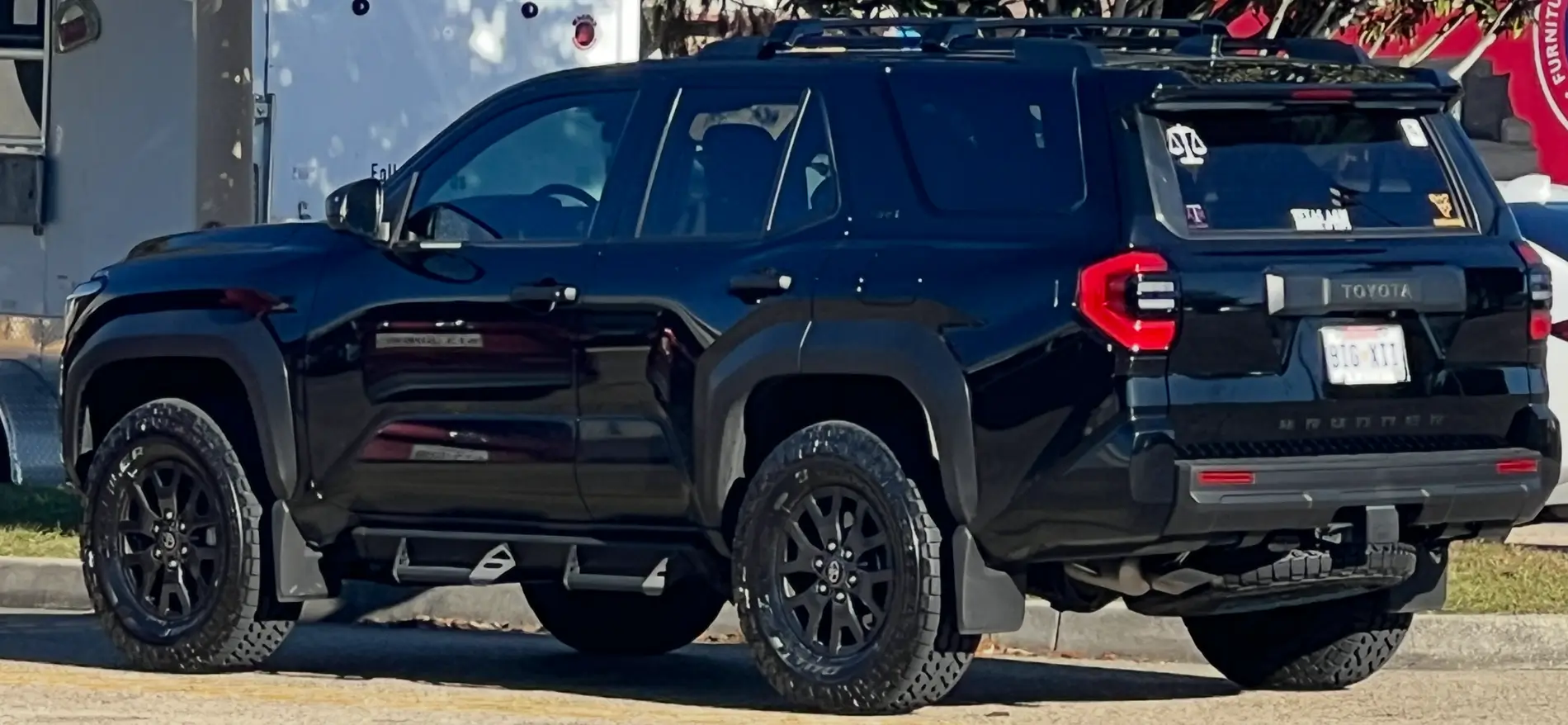

i put 285 70 R17 from the stock Yoko 245 70 R17.
2025 2026 4runner 6th gen SR5 Tire Upgrade: Falken Wildpeak 285/70/17 AT4W (33" 33's). No lift no rub IMG_6112
