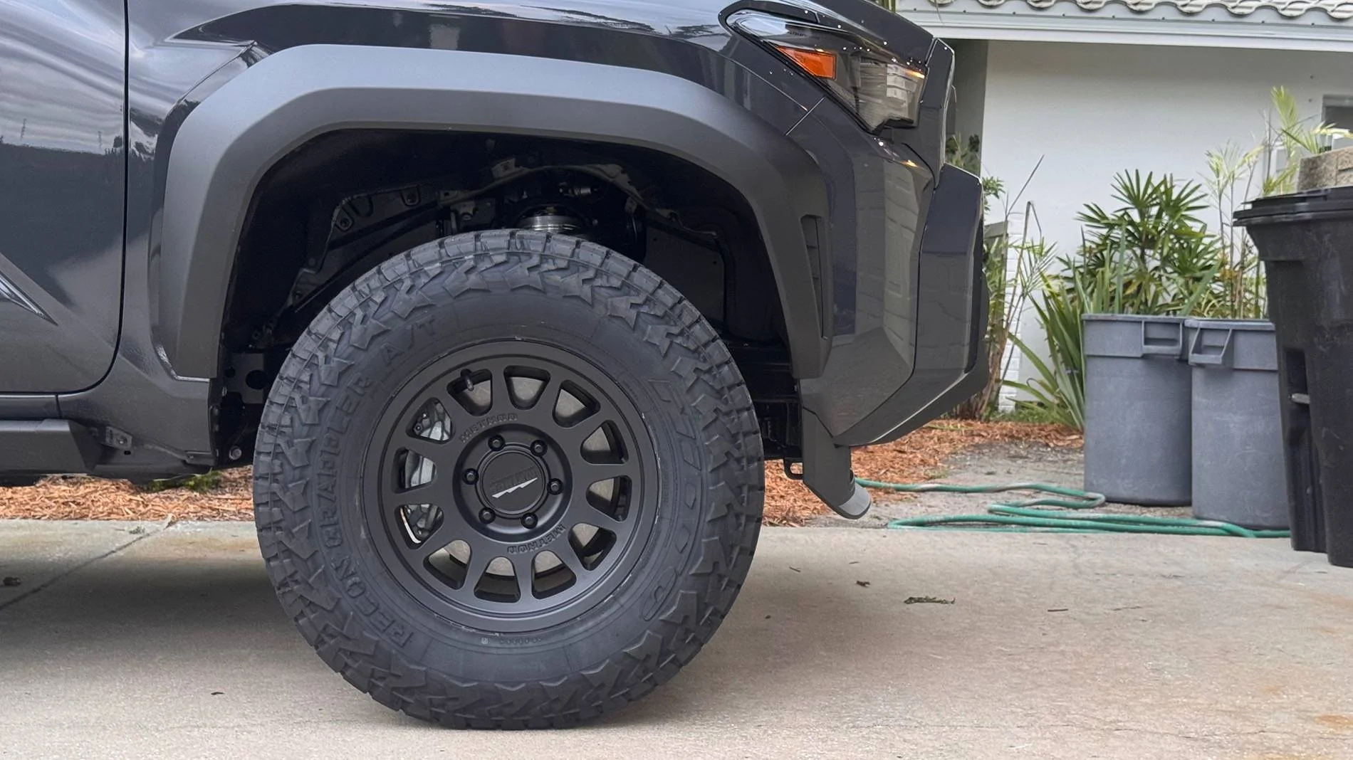

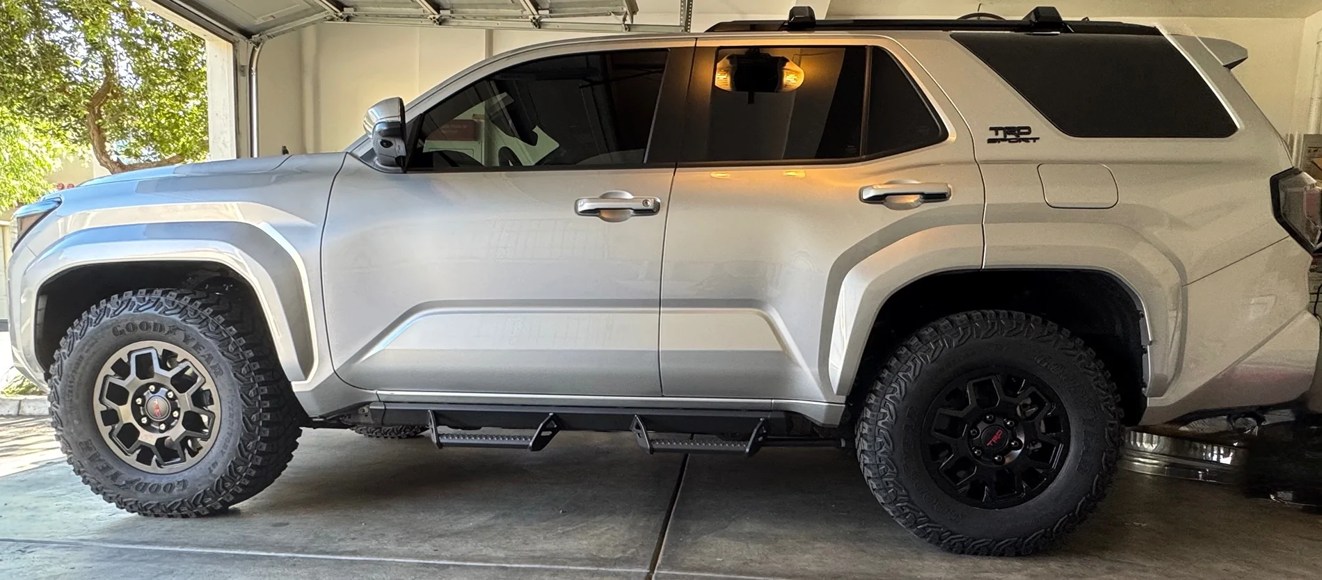

Quick picture.
2024 Tacoma trd off road wheels powder coated all black with Goodyear territory mt in 285/70/17. No rub…not even close. There is PLENTY of room in the wheel well!
not shown in the picture is the land cruiser front skid plate with the air dam removed.
fox 2.0 going on sometime after the holidays. Thanks to All Dogs Offroad!
2025 2026 4runner 6th gen 285/70/17 Tires (33's) biggest tires that fit on stock SR5. No lift & no rub (photos) IMG_0025
2025 2026 4runner 6th gen 285/70/17 Tires (33's) biggest tires that fit on stock SR5. No lift & no rub (photos) IMG_0026

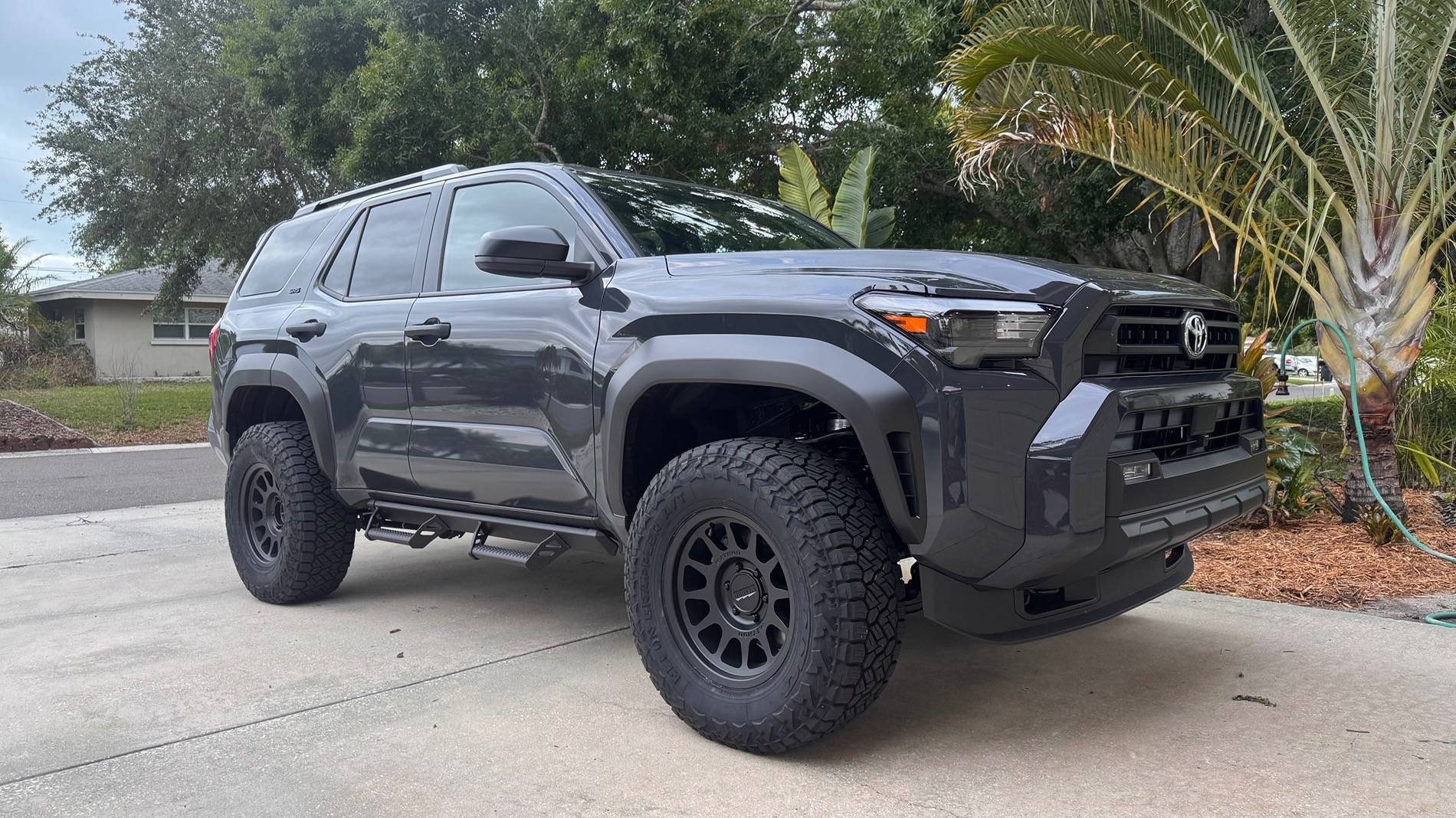

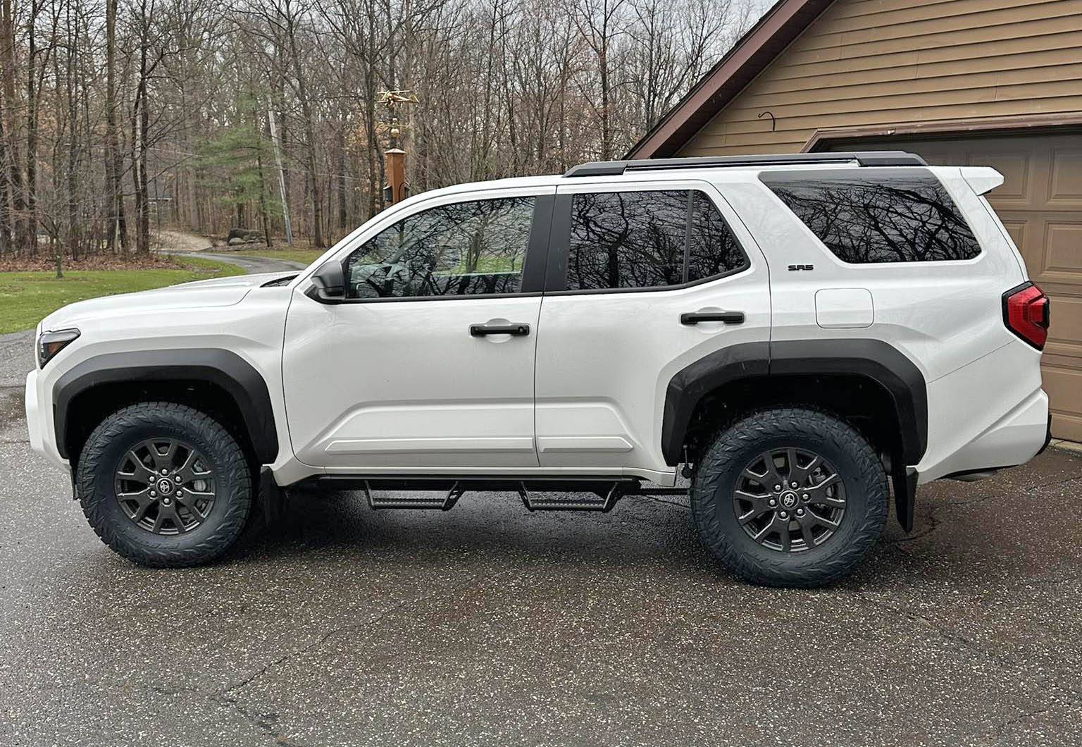

I also just put 285/70/r17 tires on my stock height and rim SR5. No rubbing at all and rides smooth. Let me know if anyone has questions.
@JBaughman, are those the oem mudflaps? If so, you have no problems at all with the bigger tires, even with the wheels at a full turn like making a U-turn? No rubbing against the mud flaps?
I always wanted bigger tires that still fit with the oem mudflaps without a lift Kit.
when you get a chance, let us know. Thank you. Ride looks great!
