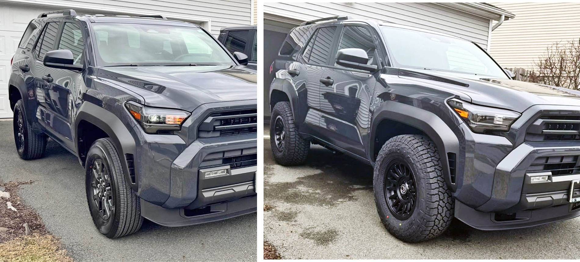

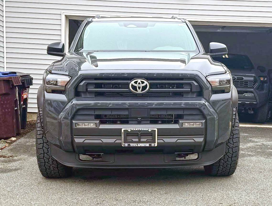

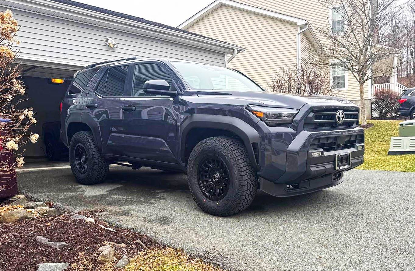

Before & After on SR5:
Tires: Falken Wildpeak 285/70/17 A/T4W SL
Wheels: Icon Alloys Recon SLX Satin Black 17x8.5 +25mm Offset
No lift
No rub
The Wildpeak AT4W are great.. they ride smoother than stock with a very slight hum. Not noisy by any means though.

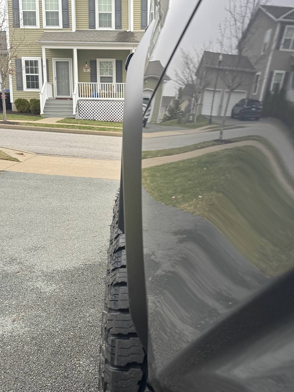

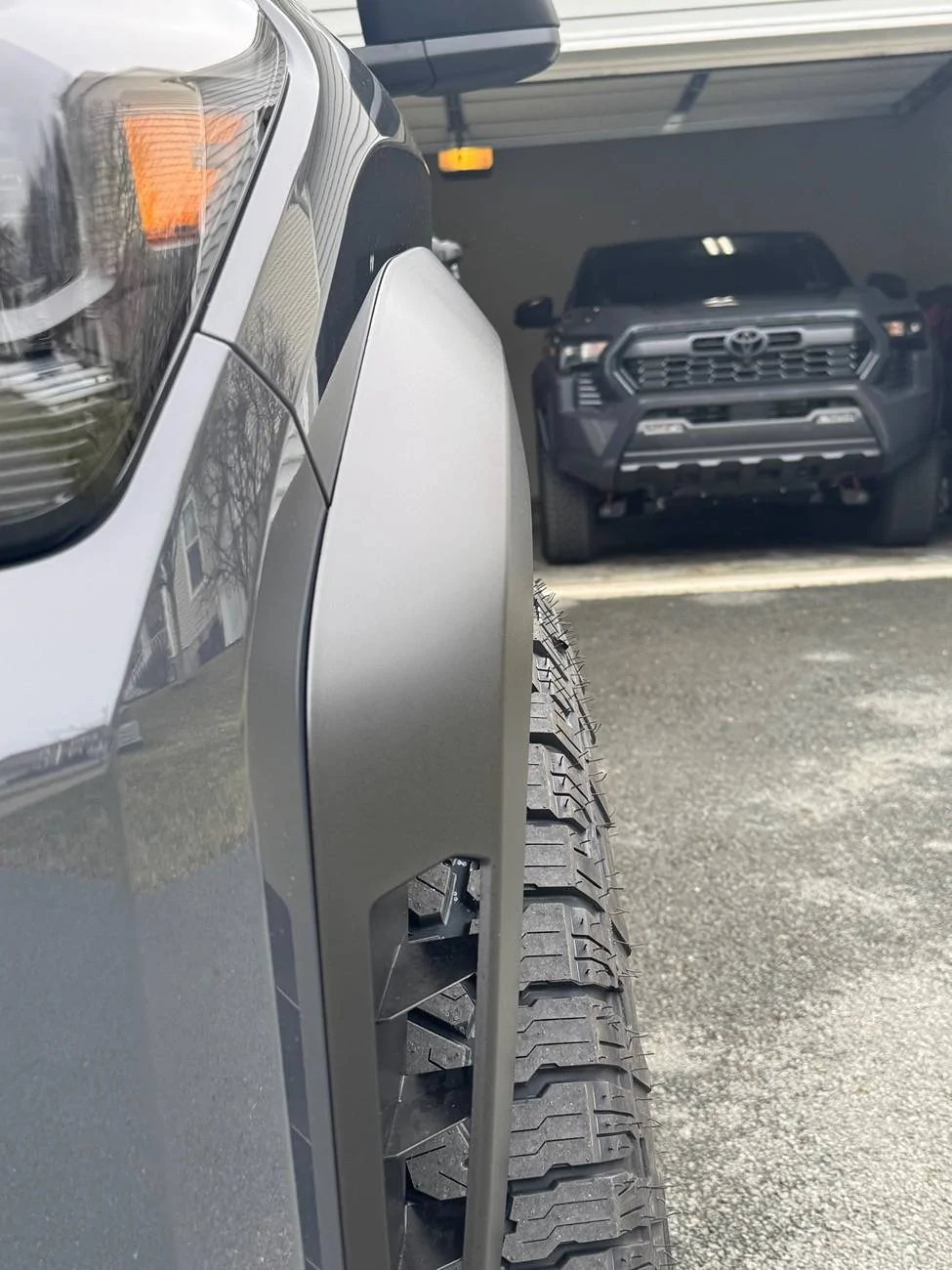

Can you tell me how much tire poke you have outside the fender with the +25 offset. If possible, can you take a picture as this is the same tires and offset that I would like to use.

Just posted some pictures. Check those out. I’d say +25 is perfect. Slight sidewall poke but no tread past fender which is exactly what I wanted.

Thank you for the pic's, that's exactly what I'm looking for!
