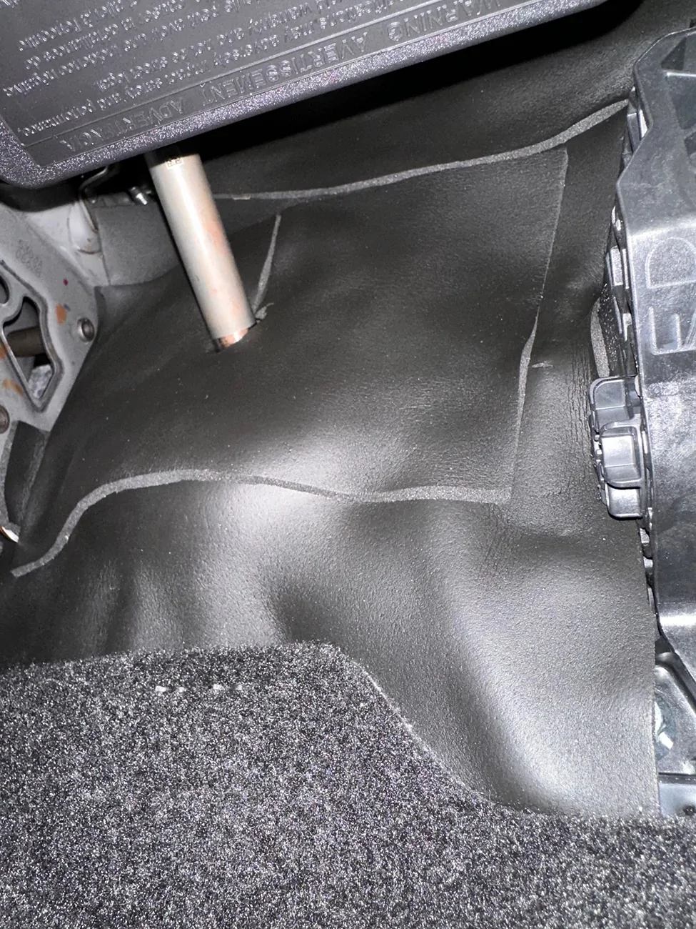

Started sound deadening the interior. Want a quieter ride and hopefully helps on the sound quality of the stereo system. Using the stuff from Amazon. Considerably cheaper than Dynamat and the like . It goes down the same, doesn’t smell. Topping with a foam layer.
Did you do the lift hatch as well? How did you pop off the cover for the lock hatch?

I have done the SoundSkins deadening on my doors (inner, outer, and foam layers) and it made a tremendous difference. I spoke with the company yesterday and they plan to have a precut kit for the rear hatch sometime next month. I kept some extra material for that project.
