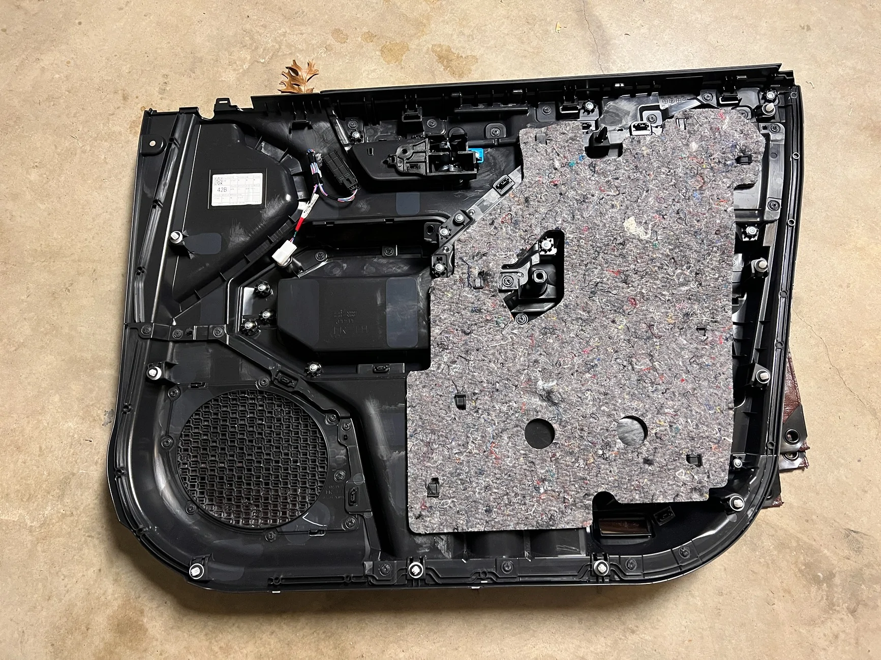

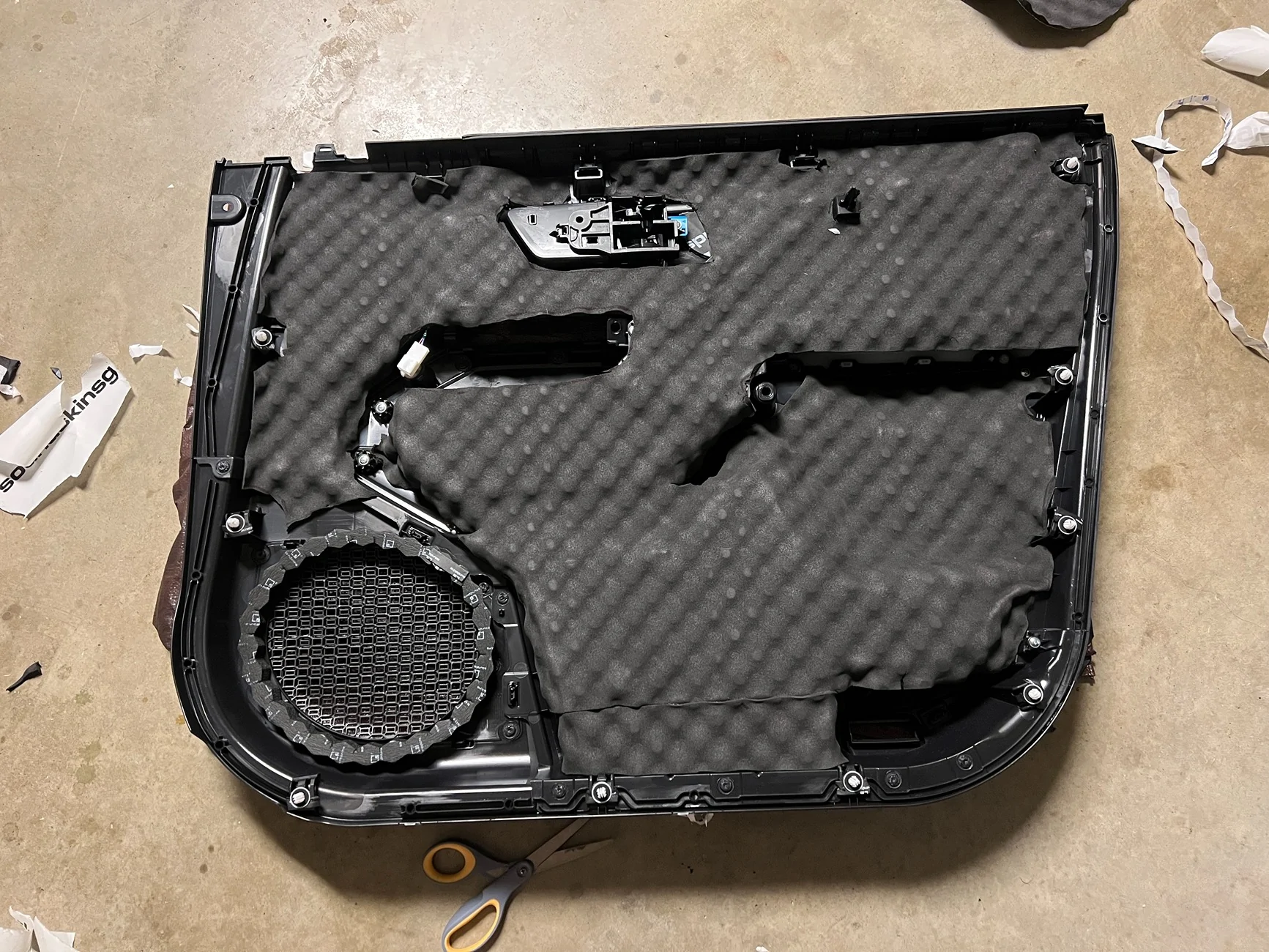

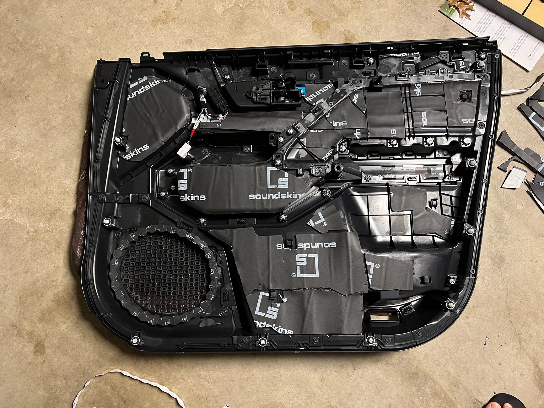

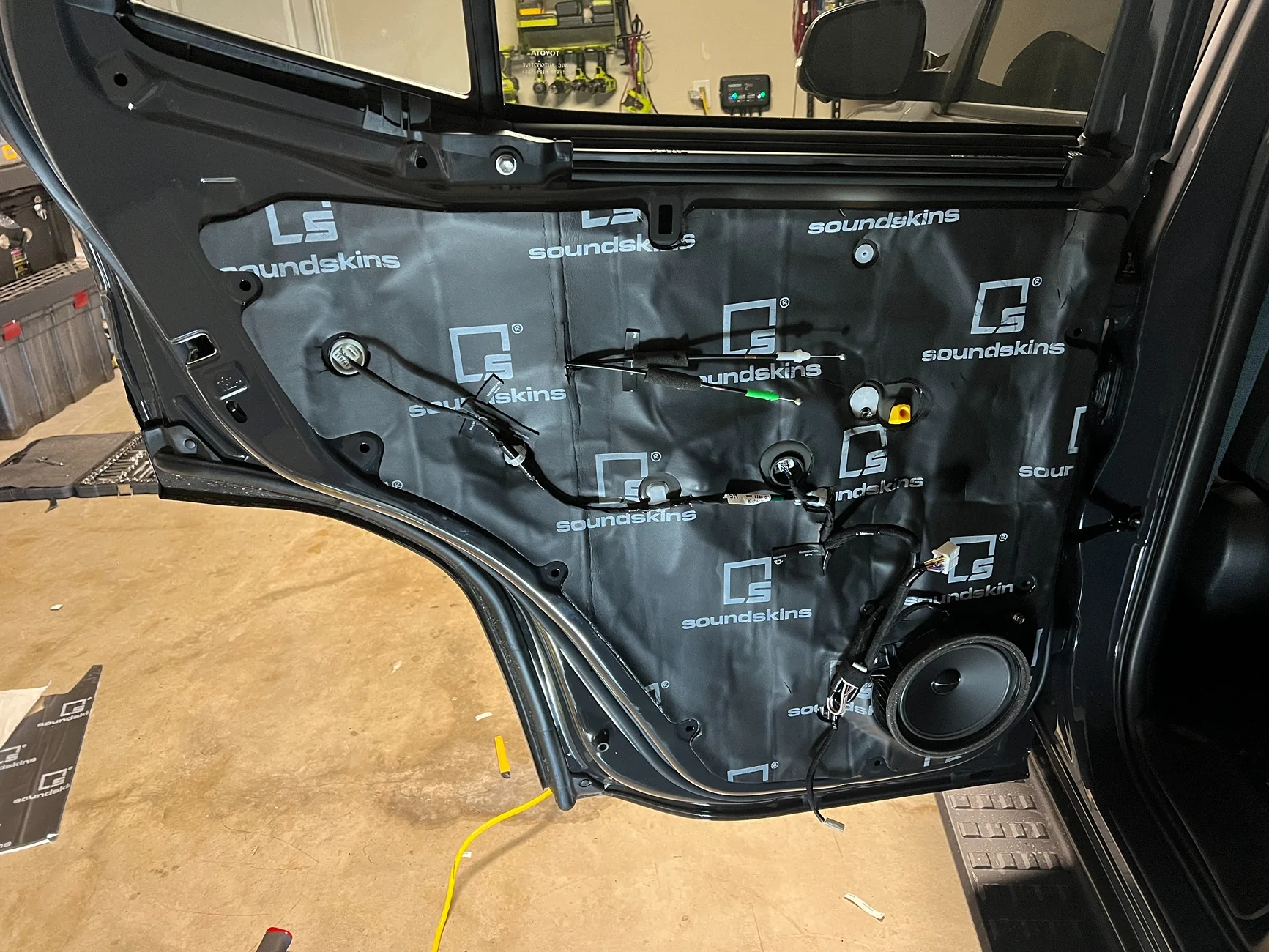

I have done sound deadening on all four doors. The front doors make a huge difference. Rear doors a slight to no difference. I went with the SoundSkins precut kit and bought extra material for the inner part of the door. I also purchased wavy foam from them for the door trim. There is a thread somewhere where material is placed on the front door window runs because they can rattle at specific bass notes. I am waiting on the rear hatch kit to be released by SoundSkins this month to use up the remaining material I have.
The doors sound great when closing now and I would say the stock speakers sound louder and better due to the lower sound floor. I did this all myself and it was also fun to learn about the car and work with my hands.
thanks for the pics, i have the soundskins ordered, i didnt think of sound deadening the door cards also
