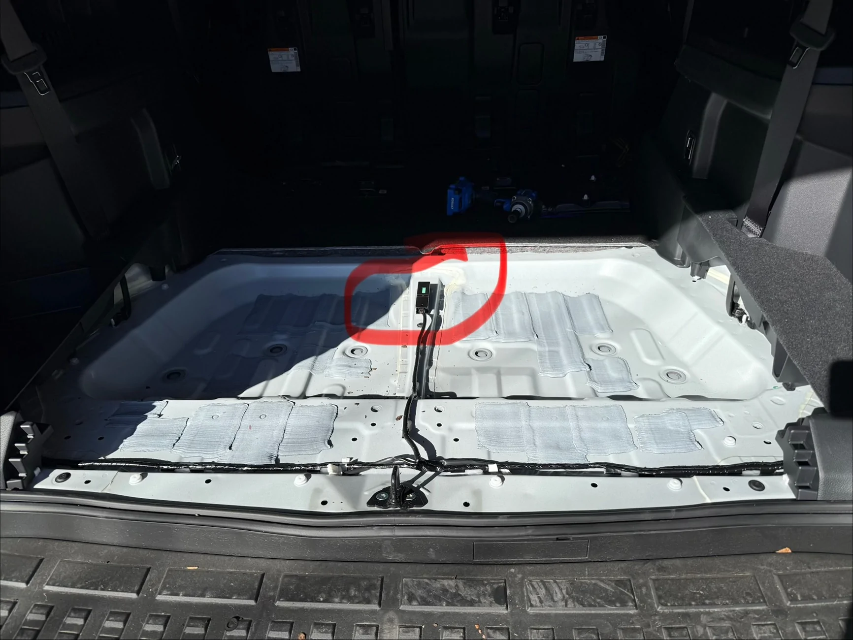

Working on 3rd row seat delete on my 25 sr5 non-hybrid

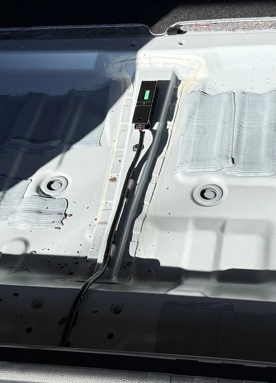

I found a sensor that I can’t figure out what it goes to..can anyone help out? (Circled in photo)
2025 2026 4runner 6th gen 3rd row seat delete project - what is this sensor? IMG_5346
2025 2026 4runner 6th gen 3rd row seat delete project - what is this sensor? IMG_5345

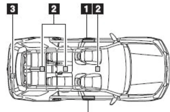

one of three smart key sensors. it need to know if key is in front seat, back seat or outside the vehicle and how far away. there are multiple sensors so it can always triangulate where the smart key fob is.
Ah, good find, thanks for sharing. I’m going to build a slightly raised mount for the plywood slab so these harnesses can stay where they are without getting squished
