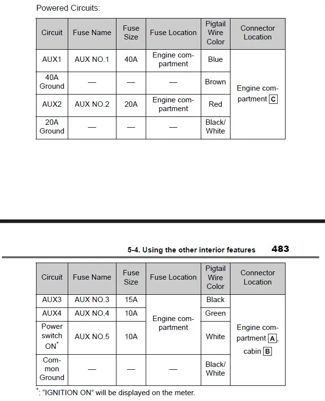

My raptor lights have just red and black wires, how did you join them to the Toyota harness?
Red would go to the corresponding hot wire on the wiring harness (depending on which AUX switch number you want to use, see below) and black would go to the corresponding ground wire.
2025 2026 4runner 6th gen Prewired AUX on ORP? 1759804558058-qv
I believe AUX1 and AUX2 are handled by the pigtail with the larger connector, and AUX3 and AUX4 are handled by the smaller one. You should receive 2 of the smaller ("Lo") pigtails in the box - that's because that one can be used in the engine bay and cabin locations concurrently.
That’s my current plan. After I started looking in to it all I kinda figured it all out. I thought each connector was its own aux button. Thanks for confirming my conclusion. This isn’t my wheelhouse and I needed it!

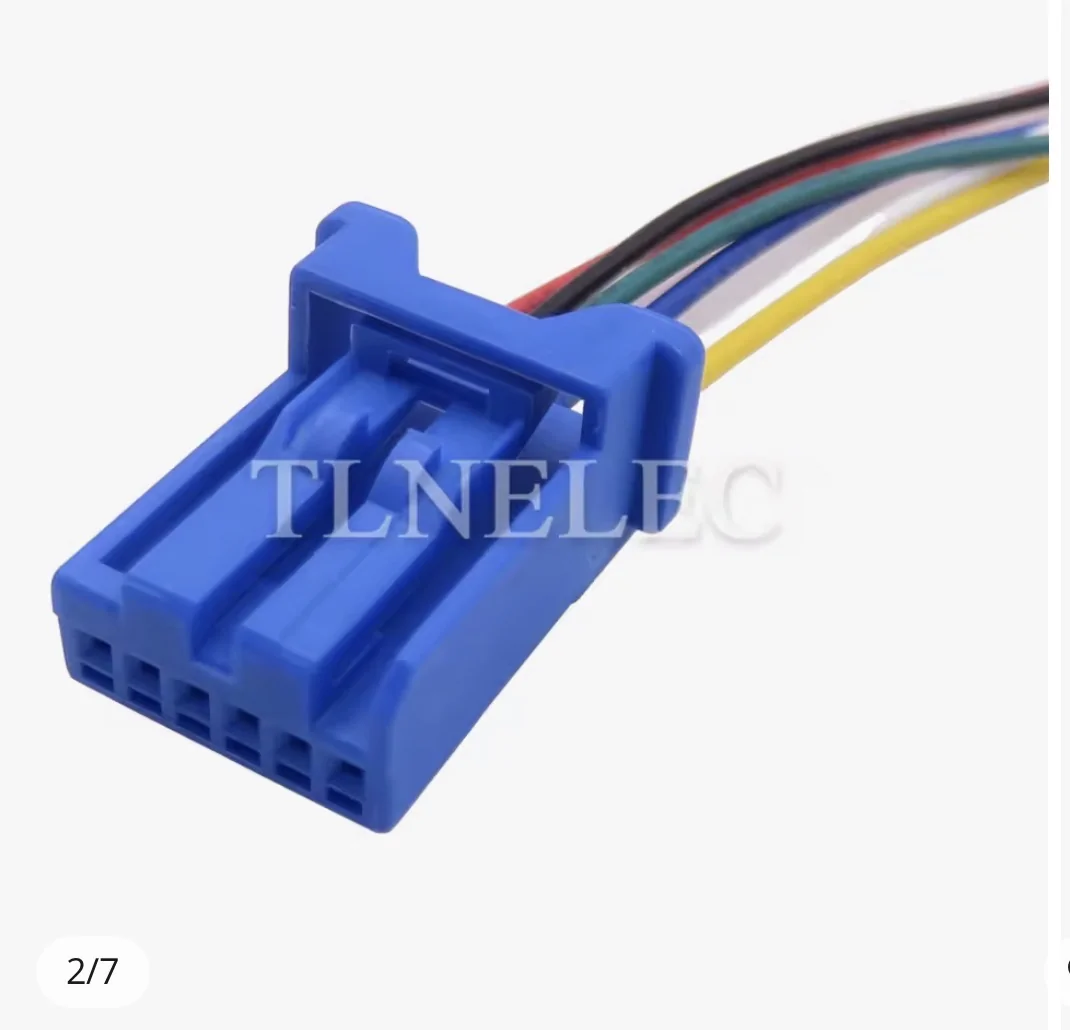

Sorry if I missed it, but does anyone know how I could order wiring pigtails for the OEM switches? I have three that I want to add but nothing to even begin wiring them with. Thanks!

Ty! I think I may have found some on Ali express I’m going to try. I need the actual harnesses that plug directly into the back of the oem switches themselves. I’ll take another run through the thread though, wouldn’t be the first (or last) time I blatantly miss something.

All I’m sorry but I’m not seeing them. I see the below but that is not what I need. I found and ordered harnesses from AliExpress and will try them.
PT974-892514RUN Wirehar Auxiliary Hi
PT974-892524RUN Wirehar Auxiliary Lo
This is what ordered:
2025 2026 4runner 6th gen Prewired AUX on ORP? IMG_0848
