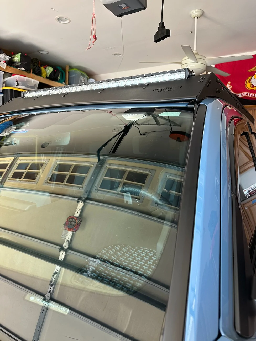

Sorry random question also, i just noticed that if you install a light bar on top, the only way to route the wire is on the side of the windshield correct? I just noticed it recently on someones install, and then i started trying to see other peoples car, and I could kind of notice it being router on the side of their windshields, with black plastic, but i can never get a good image or video to see if it really is the wire.
I saw a video can't remember who put it out but on the drivers side the black trim has a channel built into it that could fit a wire and it leads all the way into the engine bay.
That's how I ran the wire for my light bar.
2025 2026 4runner 6th gen Prewired Auxiliary Connector location(s) IMG_5677

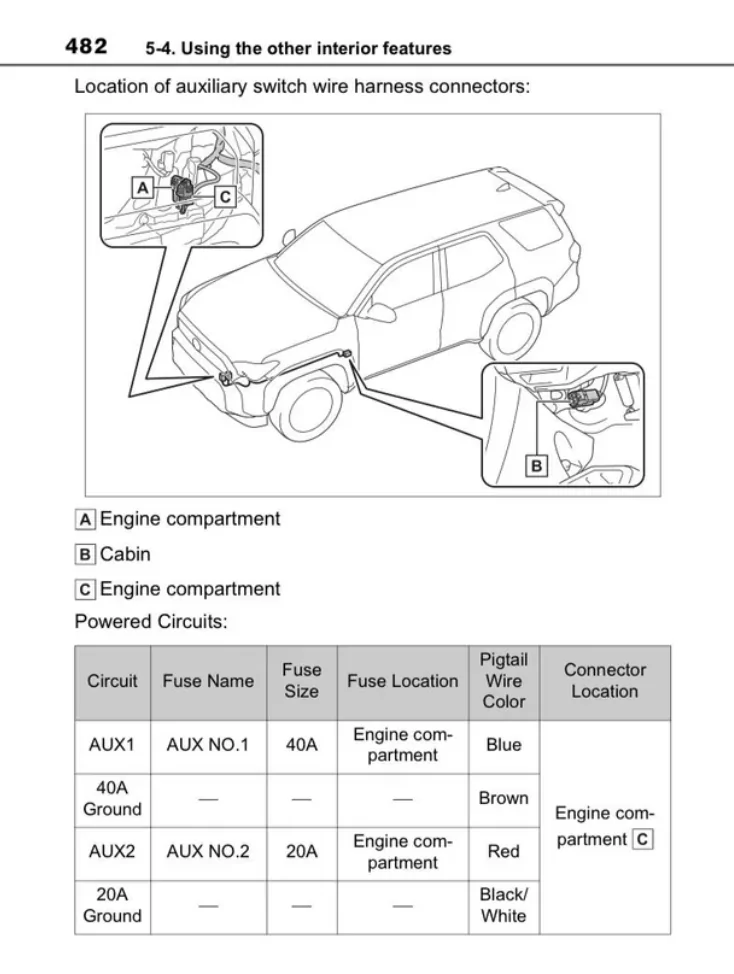

Is this the diagram you were referring to?
2025 2026 4runner 6th gen Prewired Auxiliary Connector location(s) Screenshot 2025-12-13 at 6.31.57 PM
