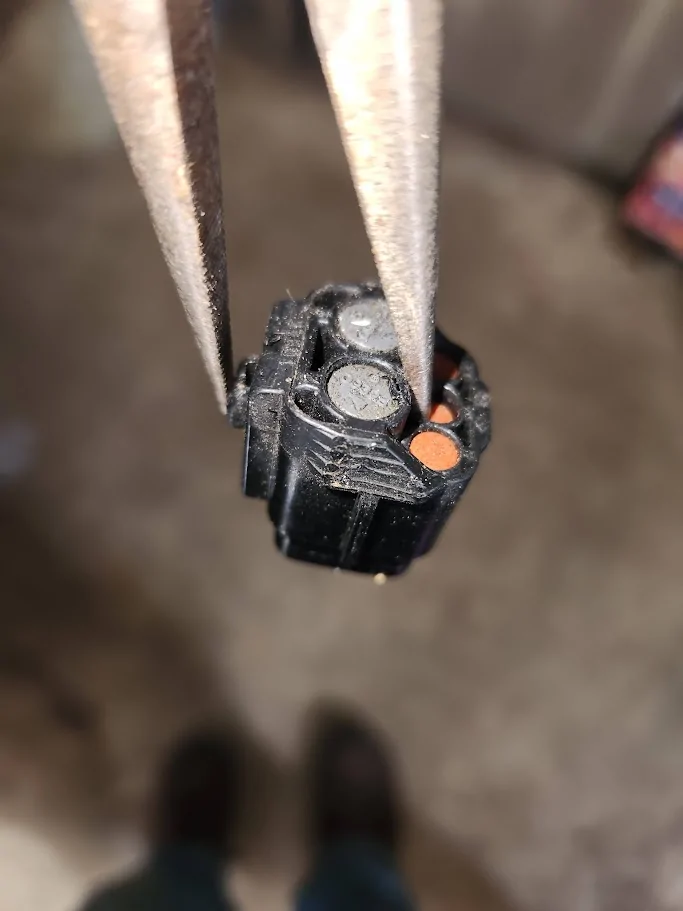

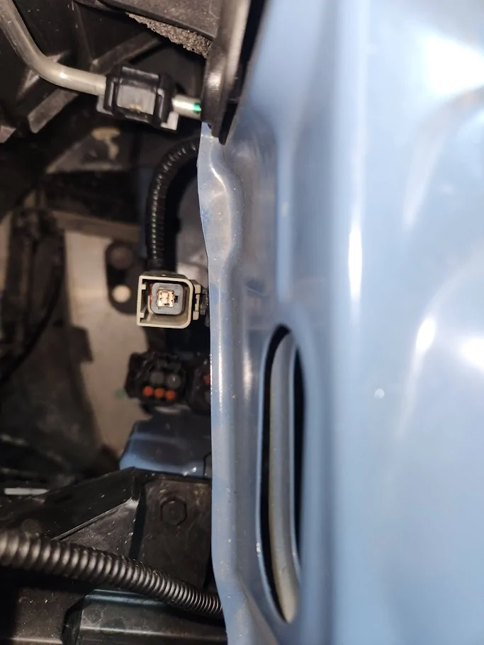

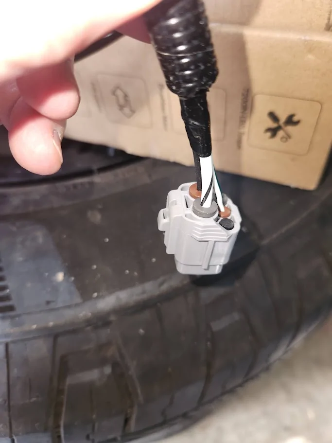

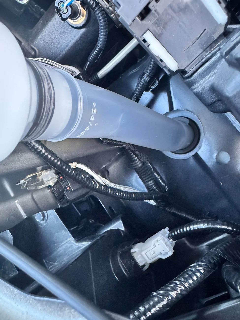

I do not KNOW the answer but I think others have determined that the wiring is not on trucks without the Aux switch option. But I do think I have a way for you to check: if you don't see a connector cover that looks like this photo, behind the drivers side headlight than the wiring is not there because that is where the wiring ends (and where you plug in the pigtails to connect to whatever you are adding (ditch lights for me)).
Connector cover:
2025 2026 4runner 6th gen Install full aux harness possible ? 20260208_115852
area behind headlight looking down from in front of vehicle - where you would see the connector cover above if the wiring exists.
2025 2026 4runner 6th gen Install full aux harness possible ? 20260208_115657
Pigtail that comes with top trims but not with TRD ORP even if you get the option:unsure:
2025 2026 4runner 6th gen Install full aux harness possible ? 20260208_115725

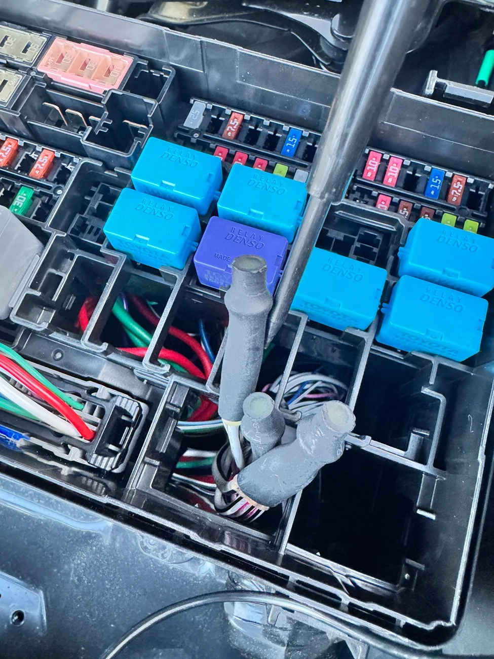

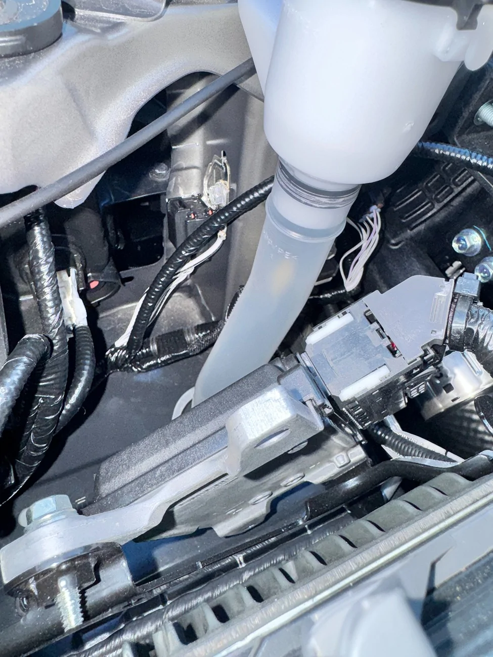

i know this discussion about hybrids but I found wires in the fusebox and just pulled them , found in SR5.
2025 2026 4runner 6th gen Install full aux harness possible ? IMG_3011
2025 2026 4runner 6th gen Install full aux harness possible ? IMG_3007
2025 2026 4runner 6th gen Install full aux harness possible ? IMG_3012
