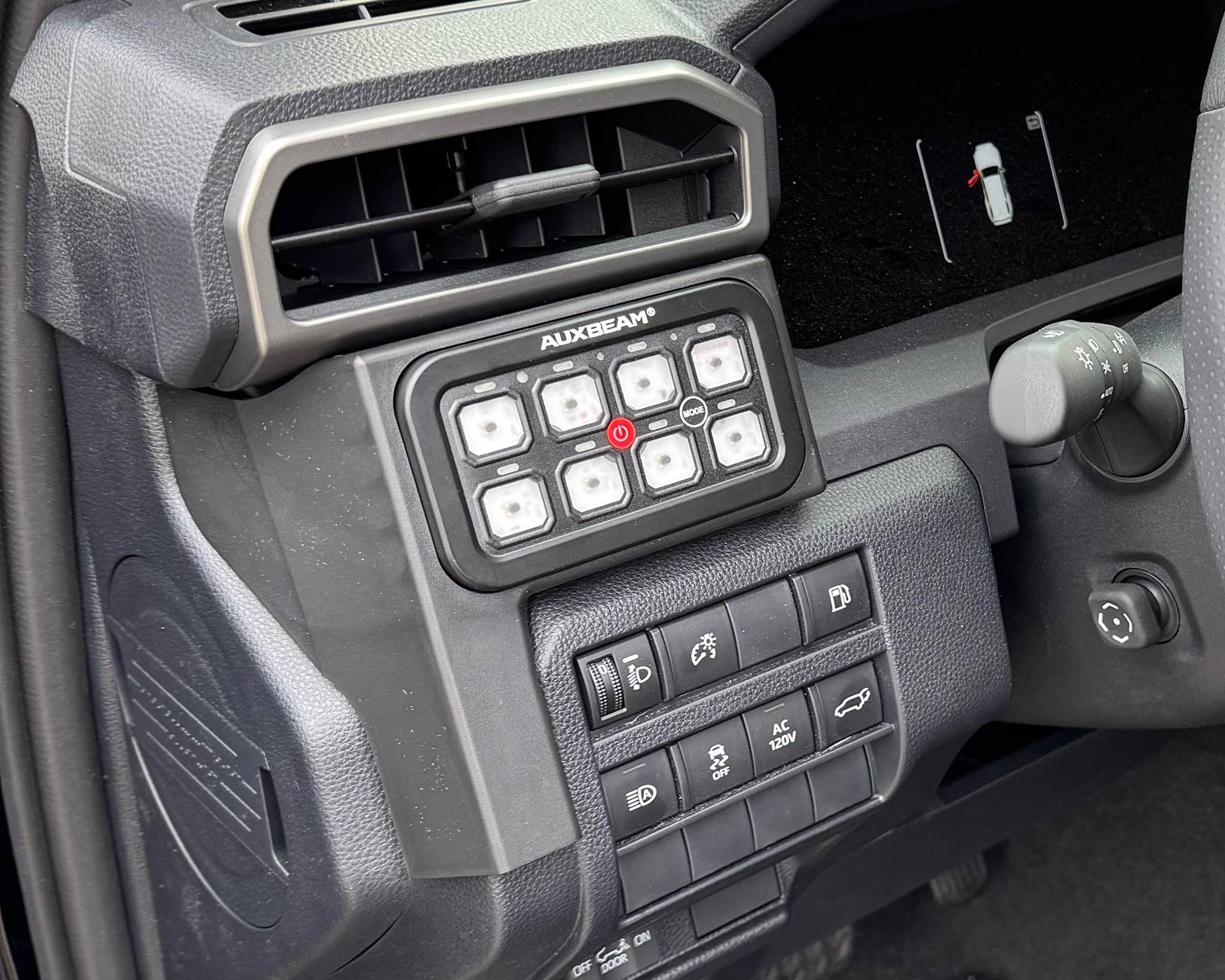

For anyone who is impatient like me and doesn’t want to search for a factory option, I just did a write up on adding aftermarket solutions here: https://www.4runner6g.com/forum/thr...-6g-hybrid-without-factory-aux-switches.4584/

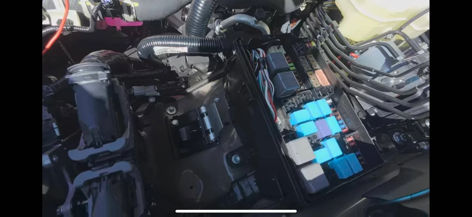

Great work by the guys above for sleuthing out parts and diagrams, I saw the lack of fused and relays and not a hint of the wiring in my fuse box and went straight away to plan B with the Auxbeam unit, but here’s to hoping there’s an OEM looking solution as well, also my write up can help in spots for others who may be using the blanks and Cali-raised or CH4x4 OEM style switches to their own relays and lights, the Auxbeam more or less does that but with one wire going through instead of several

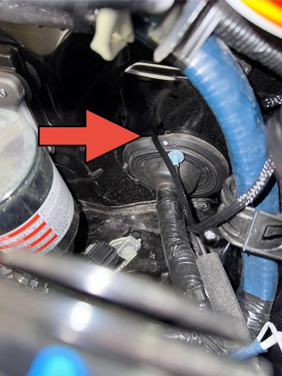

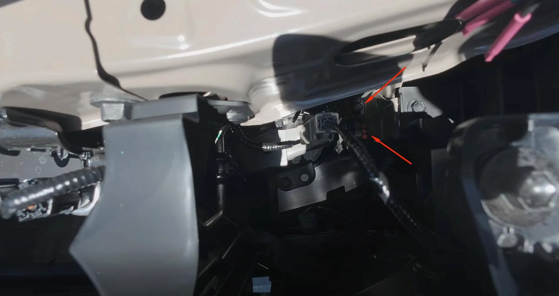

I am seeing the same thing on my TRD ORP hybrid. The four AUX port blanks actually have cable connectors going into them, and when I replace the blanks with some OEM switches from CaliRaised, they get power and seem to be working. When I toggle the switches, the corresponding blue LED (separate from the backlighting) turns on and off as you would expect.
I haven't looked for the pigtail connectors yet, but this seems very encouraging... Hoping others can do some further digging and we can find a way to wire into these AUX ports — either from the pigtail connectors, or barring that, from the relay/fuse box.
I circled the four AUX port cables in the last photo so you can clearly see the color-coding of the wires and 6-pin connectors, which may be useful in tracing them downstream.
AUX 1 = RED, PURPLE, [BLANK], BROWN, YELLOW, PINK (Black Connector)
AUX 2 = RED, LIGHT BLUE, [BLANK], BROWN, YELLOW, PINK (Blue Connector)
AUX 3 = RED, GREEN, [BLANK], BROWN, YELLOW, PINK (White Connector)
AUX 4 = RED, BLACK, [BLANK], BROWN, YELLOW, PINK. (Gray Connector)

From what I can tell on mine you’d have to use Cali Raised’s wiring, the fuse box simply doesn’t have the right relays and fuses in it for the aux switches despite the buttons themselves having power, it must be two different harnesses. There’s probably a way you can reduce the amount of wires coming through that grommet though for sure

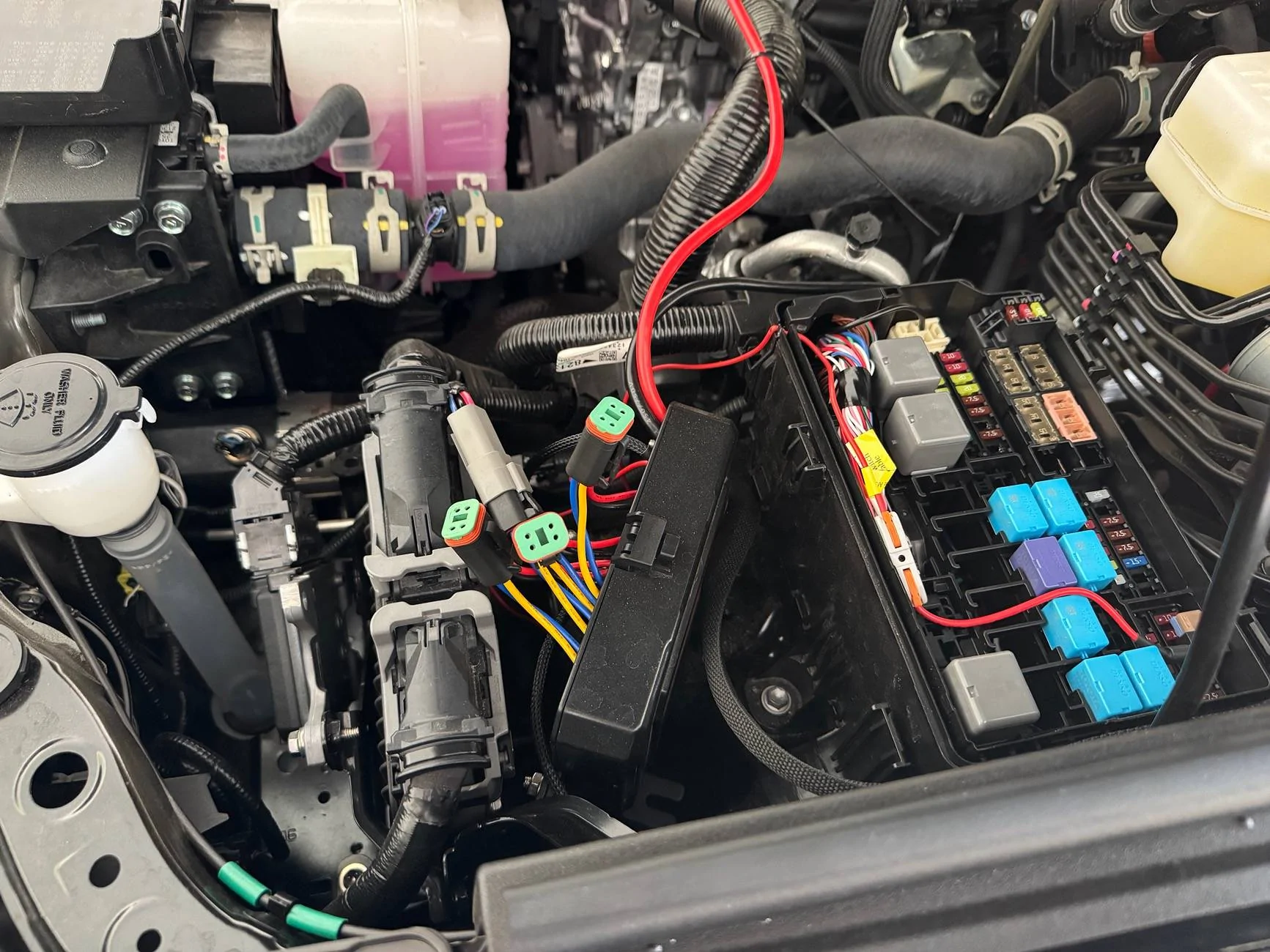

I appreciate your response. I think I'm going to order the Toyota aux harnesses (PT974-89251 PT974-89252) because I found a video where that worked like a charm.
Are all of your aftermarket dash buttons working? Did you wire straight through the firewall?

I believe those parts are for the engine bay pigtails, the wiring between those and the fuse box is non existent on models without the aux switches inside from what I can tell unless it’s hiding, but my fuse box doesn’t have the relays or even spots to plug relays in where they should be.
I ended up running a single wire through the firewall with the Auxbeam RA80 panel and a Cali-Raised panel mount into the cabin above the switches and below the vent. I’ve seen others plug the Cali raised switches into the wires behind the blanks and they are powered with the backlight and act like they are working but whenever they ground to doesn’t appear to be anything you can piggy back off of without modification

They added an air compressor and used the Toyota auxiliary pigtail harnesses. I'm thinking this should work for the light bar I'm trying to connect.
Yes correct, if you have the factory aux switches installed what he is doing is correct. For some reason toyota didn’t feel the need to pre-wire the 4Runners across the line with the aux wiring like the Tacoma, it’d strange. So even tho aux switches were an option on my Hybrid since mine didn’t get built with it, I simply don’t have the right harness. On mine you’ll see I screenshotted his fuse box at the beginning and took a pic of mine and I do not have the relays and fuses necessary nor the pigtail connections behind the headlight. Didn’t even realize one was in the back that wasn’t specified in the user manual that’s really cool

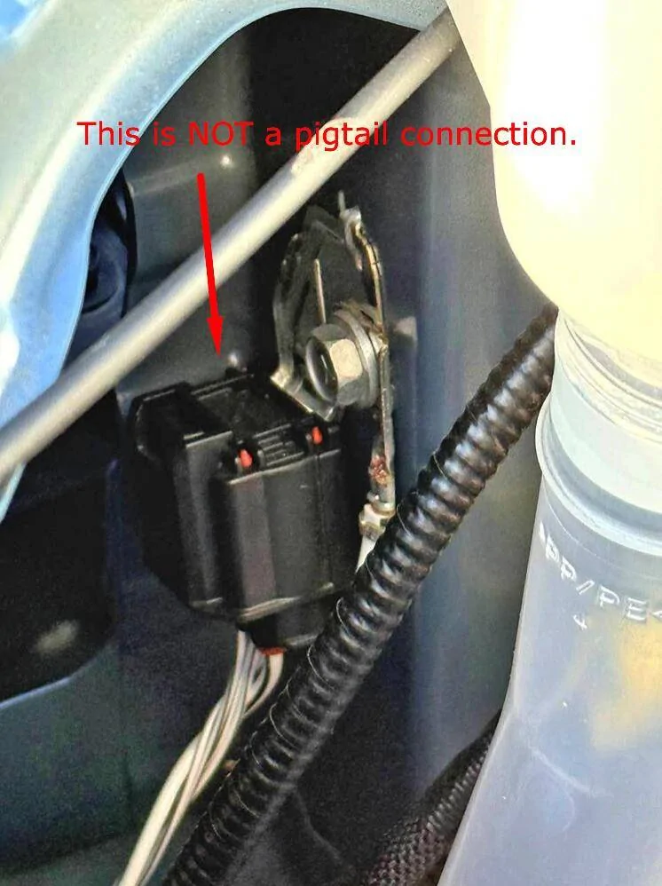

I know we're all learning the 6th gen, but unfortunately, there is a lot of misinformation circulating. Many people have incorrectly identified the pigtail connection behind the washer fluid reservoir. This is a screenshot from the video I referenced showing what they should look like.
