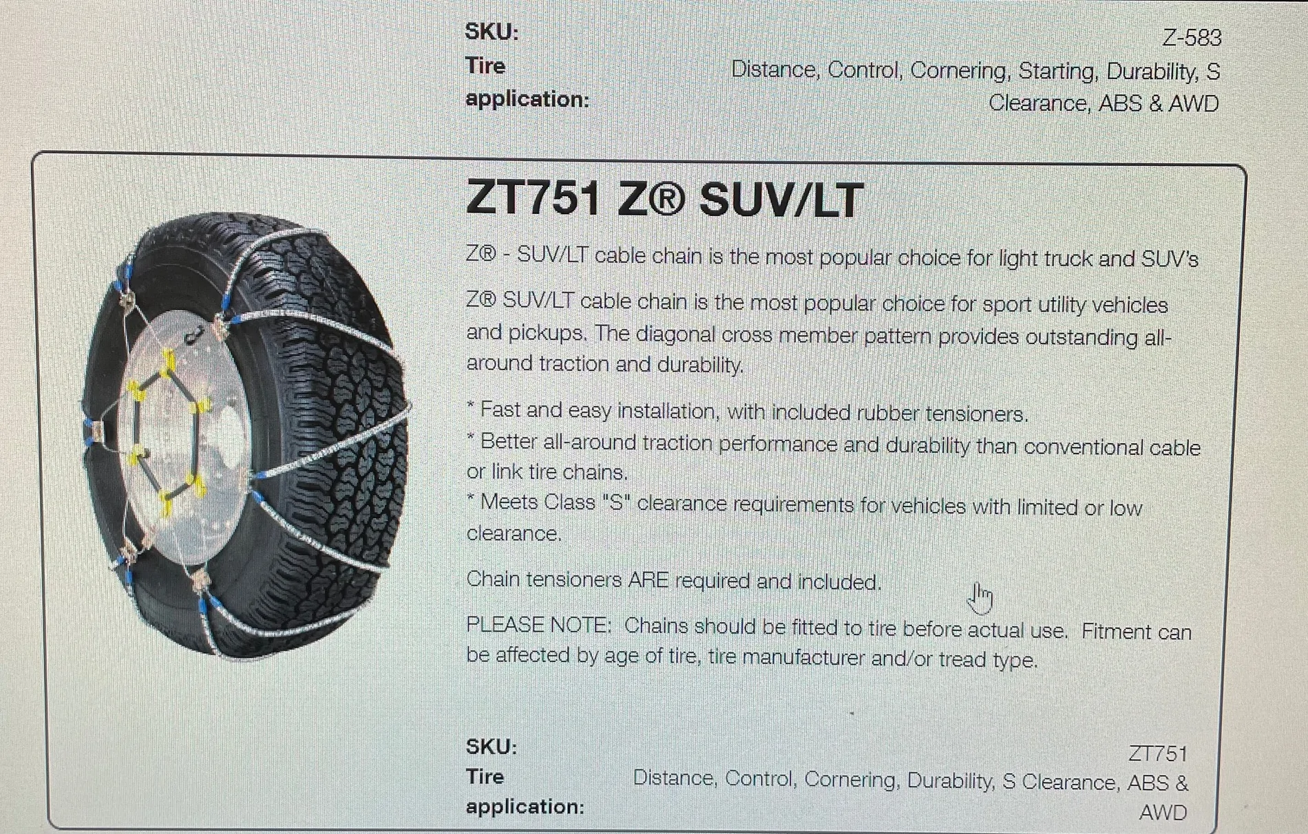

Peerless has purchased SCC. I looked up the cables for 265/70R18 on their website. ZT751 Z SUV/LT would also work.

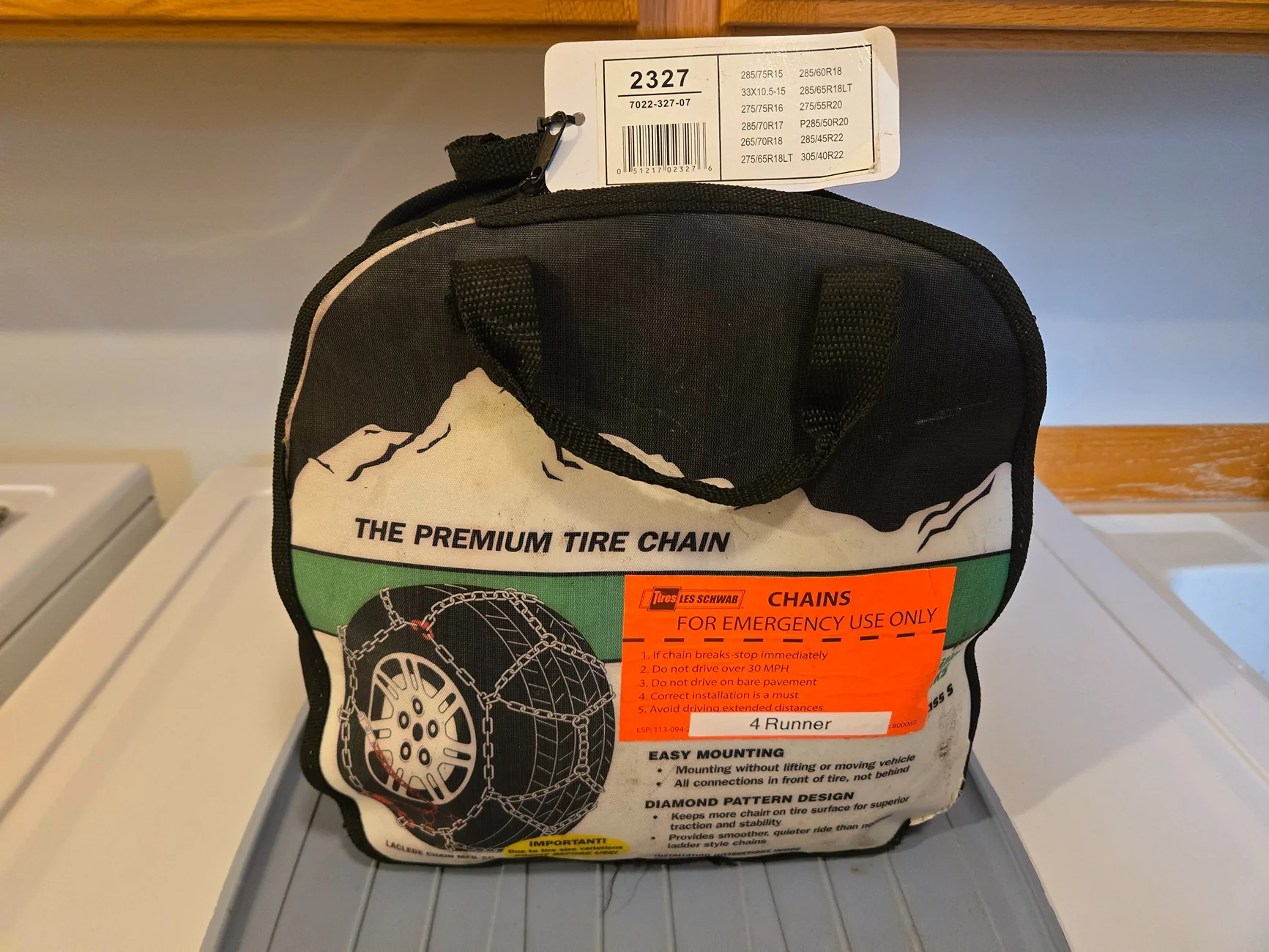

So I went to our local Les Schwab Tire Center. They essentially refused to sell me any chains for the 4Runner. They said that snow socks would be the only thing that would fit. I suspect that they were angling to sell me 3PMSF tires.
I purchased chains for our 4Runner at our local Les Schwab a week or so ago. We test fitted them in the parking lot. Looked good so I picked them up. Test fitted them again at home and gave them a thorough look from every angle. Could not see any issue. They also mentioned tire socks.
Interesting. I must come off as a mark. I went later also to Discount Tire, and they likewise tried to sell me winter tires. No chains. So I'll have to either buy them on-line or bite the bullet and get 3PMSF tires. The socks seem like a joke. How on earth do they significantly improve traction when they cover the tire tread with more or less slick fabric?
